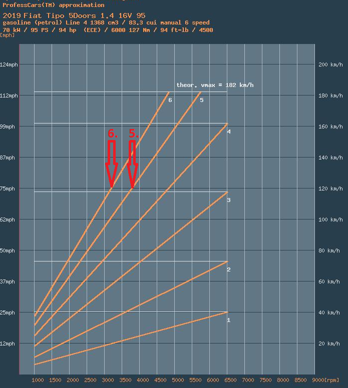

Ivan 22200 Posted July 15, 2022 (edited) @Rajkovicbg Jedna slika, 1000 reci... Speed/RPM odnos za svaki stepen prenosa FPT-ovog C514.6 u Tipu. Primer je za 1.4 atmo HB (posto nisi precizirao koja verzija te konkretno zanima): Edited July 15, 2022 by Ivan 1 shuxx reacted to this Quote Share this post Link to post Share on other sites

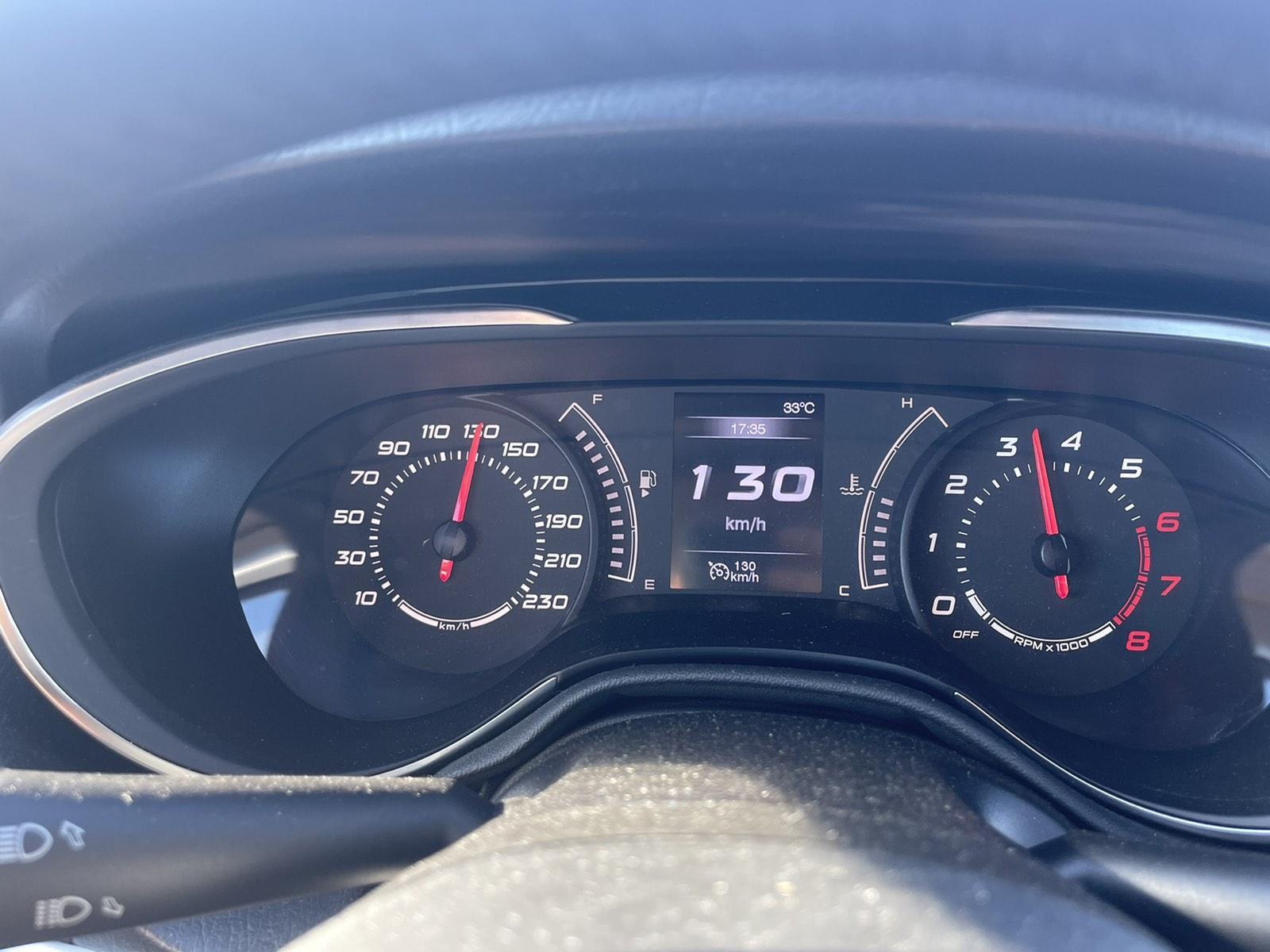

totti 13183 Posted July 15, 2022 1 Ivan reacted to this Quote Share this post Link to post Share on other sites

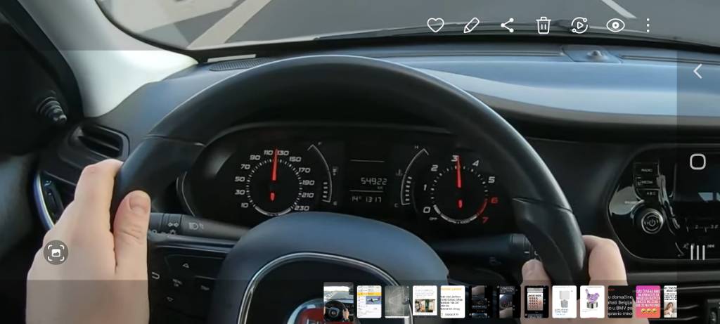

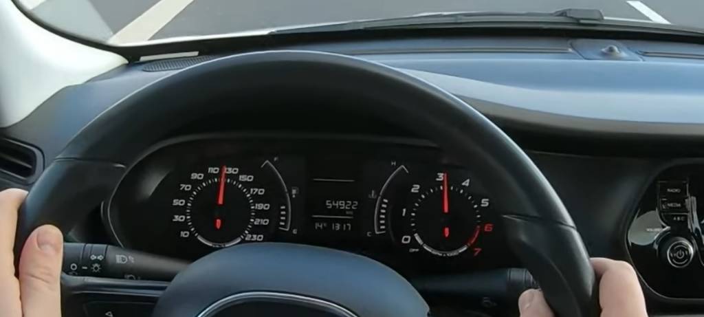

Ivan 22200 Posted July 15, 2022 (edited) Ako cemo tako ... Cisto da potvrdimo aproksimaciju iznad. Edited July 15, 2022 by Ivan Quote Share this post Link to post Share on other sites
