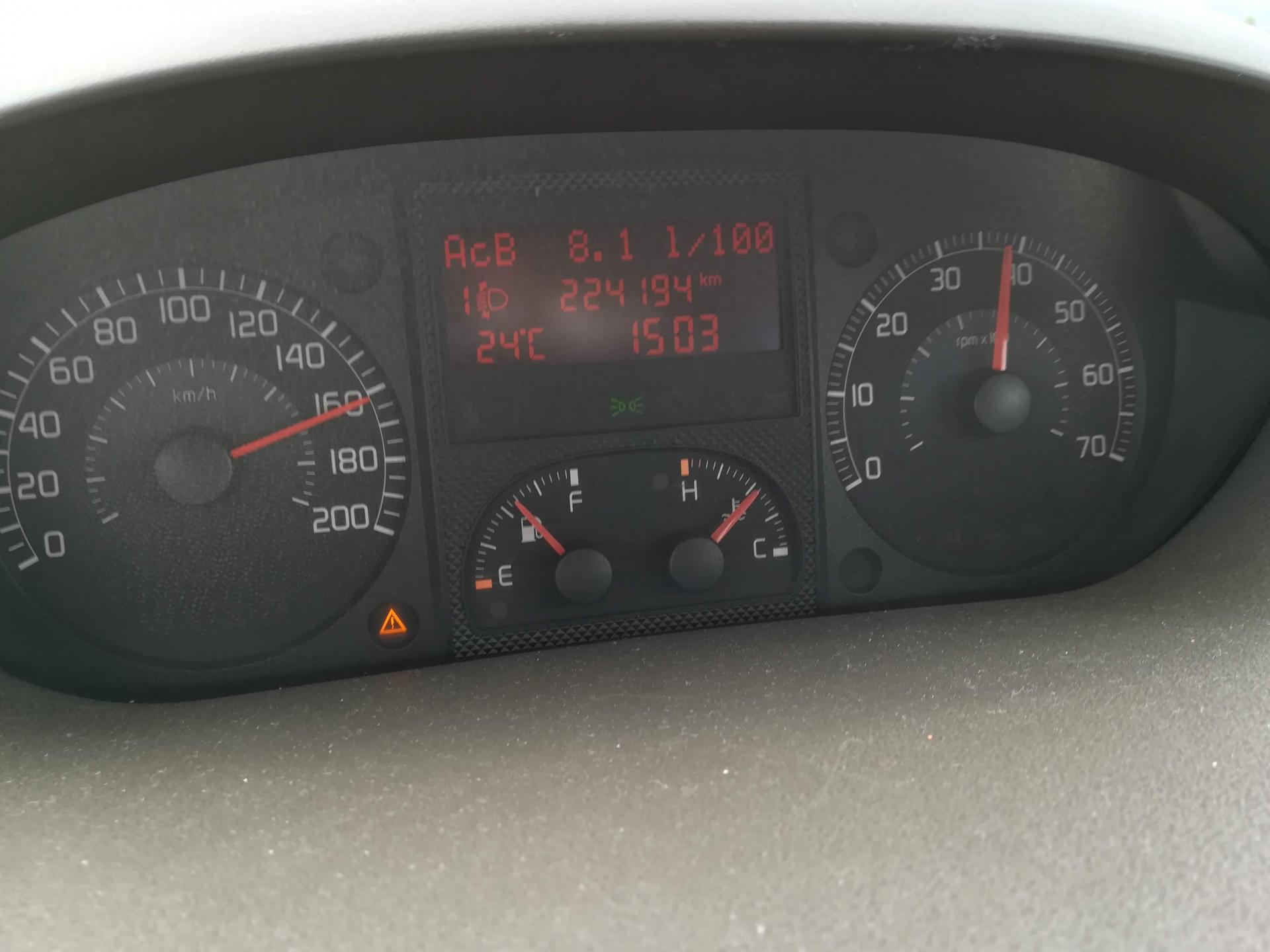

marko.jovanovic 925 Posted October 29, 2018 U ala ste mi svileni Ja ovako vozim auto putem pa ne kukam 2 neshtry and silenci reacted to this Quote Share this post Link to post Share on other sites
horvat 7167 Posted October 29, 2018 (edited) Pa, identicno tako i ja vozim (~4k rpm i ~8L potrosnja) - samo sto idem 130 km/h lol Edited October 29, 2018 by horvat Quote Share this post Link to post Share on other sites
