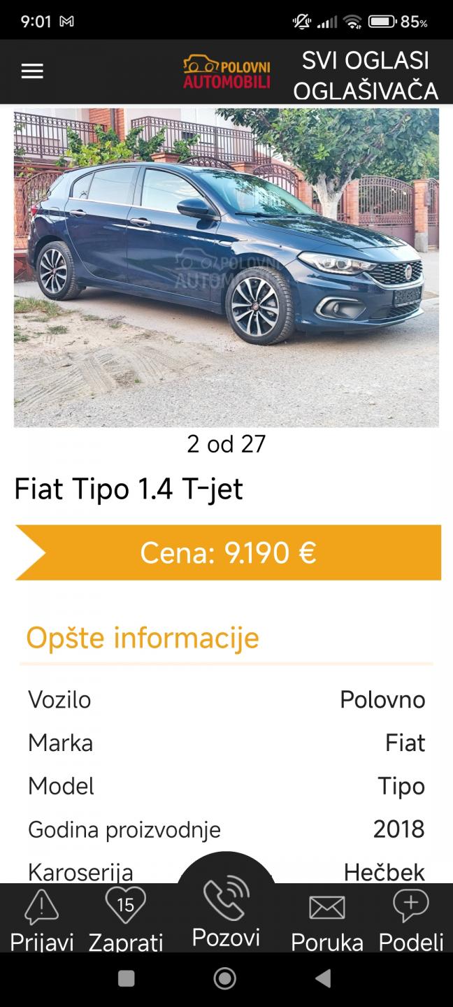

neshtry 19746 Posted June 11, 2024 Meni ovaj savršen https://www.polovniautomobili.com/auto-oglasi/24077644/fiat-tipo-14-t-jet 1 MS PK reacted to this Quote Share this post Link to post Share on other sites
OMP 3982 Posted June 11, 2024 (edited) Ne deluje lose ovaj je malo bolji sa hrom detaljima mada redak je tipo koji moze vizuelno da me privuce, cudi me da nisu izbacili neku sport verziju Edited June 11, 2024 by OMP Quote Share this post Link to post Share on other sites

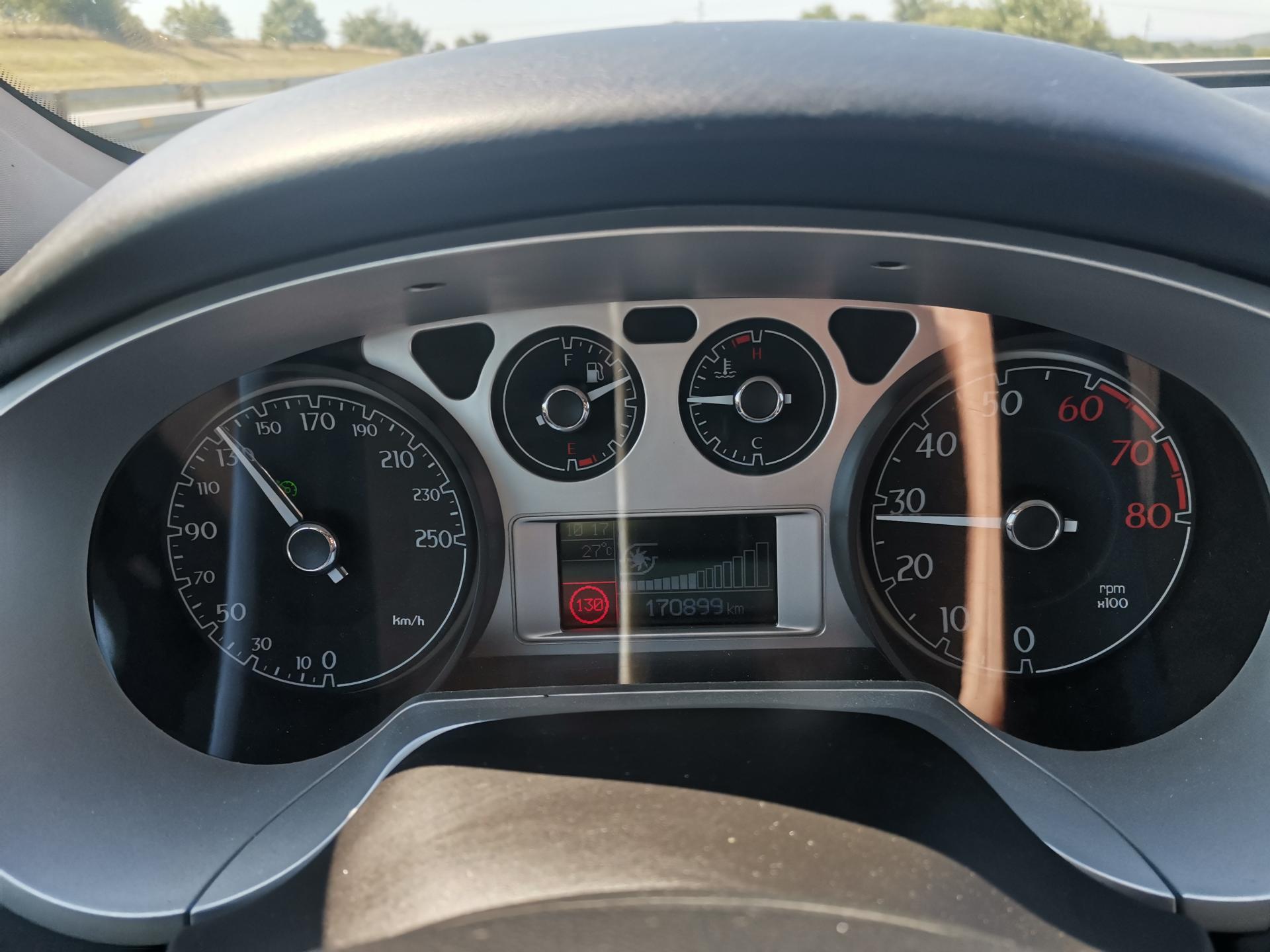

integralac 2786 Posted June 13, 2024 On 6/1/2024 at 10:03 AM, OMP said: kako je moguce toliki obrtaji u 6. , sta se onda postiglo 6. brzinom ako su tako visoki obrtaji na 130kmh, meni gp u 5. ide toliko na 3500, da imam 6. moralo bi da padne na 3000 sto bi bilo ok kod mene odnos rpm i kmh gledano po gps u 5. brzini je : 3000rpm = 110-112kmh 3250rpm = 120kmh 3500rpm = 130kmh dok sam sat pokazuje za nekih 10ak kmh vise ja ga vozim uvek tu 3000-3200 tad mi je najbolji odnos buke i brzine, na 3500 je vec bucan prilicno sto od motora sto od vetra, podvozja cega god pa mi i nema smisla terati ga toliko, 10-15 kmh gore dole mi ne znace u zivotu nista. Jel vam ispravna ta kola? 2 3 nobutado, nemanja84bg, knezevic76 and 2 others reacted to this Quote Share this post Link to post Share on other sites
knezevic76 8755 Posted June 13, 2024 Drugačiji su prenosi na GP Tjet, slično je i kod Alfe, kraći prenosi.I kod mene su kao kod tebe u šestoj isti obrtaji pri toj brzini.Sent from my SM-A546E using Tapatalk 1 Reacher Gilt reacted to this Quote Share this post Link to post Share on other sites
ostoja 770 Posted June 14, 2024 8 hours ago, integralac said: Jel vam ispravna ta kola? Ovo je 140 ili 150 konja? Moja ima 120 konja i 129kmh = 3000 rpm po cajgeru (u 6oj). Quote Share this post Link to post Share on other sites
OMP 3982 Posted June 14, 2024 (edited) Nije za poredjenje kad nisu isti menjaci i motori u pitanju ija da imam 6. bilo bi ovako Edited June 14, 2024 by OMP 1 Reacher Gilt reacted to this Quote Share this post Link to post Share on other sites
integralac 2786 Posted June 14, 2024 MA 141 konj 3 Reacher Gilt, Ivan and nemanja84bg reacted to this Quote Share this post Link to post Share on other sites

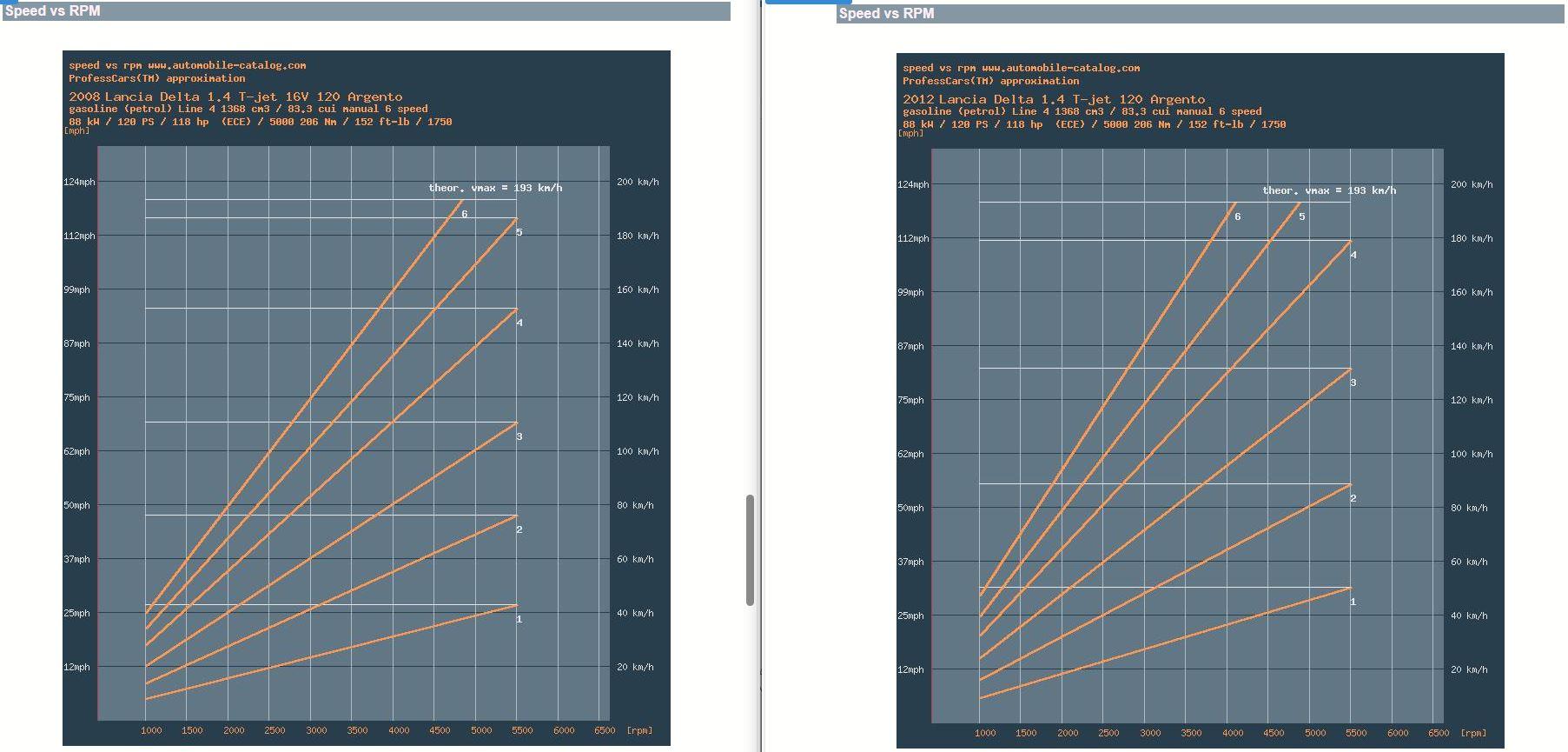

ostoja 770 Posted June 14, 2024 (edited) Nema veze sa konjima izgleda, nego sa godistem, tj menjacem unutra: M32 pre redizajna je kraci i vise vrti motor, FPT C635 iz redizajna je duzi i nizi su obrtaji... nadjoh grafikone 2008 Lancia Delta 1.4 T-jet 16V 120 Argento (88 kW / 120 PS / 118 hp) (since mid-year 2008 for Europe ) specs review (automobile-catalog.com) 2012 Lancia Delta 1.4 T-jet 120 Argento (88 kW / 120 PS / 118 hp) (for Europe ) specs review (automobile-catalog.com) 2012 Lancia Delta 1.4 MultiAir 140 Argento Start&Stop Euro5 (103 kW / 140 PS / 138 hp) (for Europe ) specs review (automobile-catalog.com) edit: @integralac tvoja V je "dugacka" maltene koliko i moja VI po ovim grafikonima, razlika u nijansama... Edited June 14, 2024 by ostoja Quote Share this post Link to post Share on other sites
skile86 594 Posted June 14, 2024 14 hours ago, ISV_01 said: @skile86 A 2.0 dizlo u Opelu ? Znam da su prve generacije koje su npr bile u Insigniji imale probleme, posle kao ispravljeno tipa 2020te. To je motor sa mislim ~170ks, ne znam ima li drugih verzija snage. Pitam zbog npr Grandland-a, mislim da bi mu to bila optimalna motorizacija jer je tezak. Prilicno sam ubedjen da je to Fijatov motor uz odredjene izmene. Sticajem okolnosti sam se interesovao bas za Insigniju sa tim motorom i rekose mi da ima problema sa nekom lambda sondom, koja kosta oko 1000e posto je ima samo u originalu. Ostalo je ok. Novija godista tj motor sa 177+ hp-a je iz Pezoa. 1 ISV_01 reacted to this Quote Share this post Link to post Share on other sites
MiloshBg 1937 Posted June 14, 2024 (edited) Ako je 1956ccm to je fiatov motor, ako je 1995ccm to je vec nesto drugo, opelov motor razvijen iz 1.6cdti. Edited June 14, 2024 by MiloshBg 1 ISV_01 reacted to this Quote Share this post Link to post Share on other sites
Ivan 22206 Posted June 14, 2024 (edited) 2 hours ago, ostoja said: M32 pre redizajna je kraci i vise vrti motor, FPT C635 iz redizajna je duzi i nizi su obrtaji... nadjoh grafikone 'Ajmo jedno nagradno pitanje . C544 (Opelov M32) ima prenos u 6. brzini 0.744. A FPT-ov C635 na benzincima 0.74 do 0.77 u 6. brzini. Znaci maltene isti ili cak kraci prenos na zabarskom menjacu ? Prvo, vecina zaboravlja izuzetno bitnu stavku u vidu prenosa u diferencijalu. I da je na grafikonima rpm/brzina uracunat tzv. Final Ratio. Odnosno, grafikon prikazuje odnos menjac+diferencijal. Gde razlike mogu da budu drasticne. 2 hours ago, ostoja said: edit: @integralac tvoja V je "dugacka" maltene koliko i moja VI po ovim grafikonima, razlika u nijansama... E sad, ovde su prenosi u menjacu maltene isti, prenos u diferencijalu isti. Razlika u obrtajima u ovom primeru nastaje ne zbog prenosa - nego zbog manjka snage, tacnije, obrtnog momenta u poredjenju T-Jet i MultiAir Turbo. Euro 4 T-Jet je (bez obzira na snagu) u startu imao 206 Njutna. Dok je MultiAir imao i do 260 Njutna u Sport modu (230 u Normal). I jos dostupno na nizim obrtajima - takav motor ce samim tim lakse i na manjim rpm da nosi karoseriju iste tezine. Kada vec pominjem prenose u menjacu i diferencijalu - evo jos jedan interesantan podatak. 500L, najobicniji 1.4 FIRE 95 sa C514.6 menjacem - vecina misli da se prilikom kruziranja vrti u obrtajima jer ima kratak prenos u menjacu. A upravo je suprotno, retko ko zna da taj C514 u 6. brzini ima odlican prenos od 0.64. Primetno duzi prenos od vecine menjaca na turbacima. Dodatno, 5. brzina na Fici ima prenos kao 6. brzina na Delti. U praksi, maltene kao da Fica za kruziranje ima jos jednu, 7. brzinu, poredeci sa Deltom . Citaj, motor bi trebao da bude bas rasterecen na visim brzinama. Ali, kada bi gledali samo menjac . Zbog slabijeg motora i vrlo malog torque od 128 Nm (pa jos dostupnog tek u visokim obrtajima) - da bi se to nadoknadilo, diferencijal mora da ima kratak prenos. Cak blizu 5.0, poredeci sa cca 3.4 kod turbaka, a menjac "zgusnutije" slozene neke brzine. Sto rezultuje daleko visim obrtajima prilikom kruziranja, u odnosu na ono sto bi ocekivali gledajuci samo prenos menjaca u 6. brzini. Cisto da se dopisem na diskusiju, sa par svojih zapazanja . Edited June 14, 2024 by Ivan 5 ISV_01, nemanja84bg, ostoja and 2 others reacted to this Quote Share this post Link to post Share on other sites
zarekg 216 Posted June 14, 2024 27 minutes ago, Ivan said: E sad, ovde su prenosi u menjacu maltene isti, prenos u diferencijalu isti. Razlika u obrtajima u ovom primeru nastaje ne zbog prenosa - nego zbog manjka snage, tacnije, obrtnog momenta u poredjenju T-Jet i MultiAir Turbo. Euro 4 T-Jet je (bez obzira na snagu) u startu imao 206 Njutna. Dok je MultiAir imao i do 260 Njutna u Sport modu (230 u Normal). I jos dostupno na nizim obrtajima - takav motor ce samim tim lakse i na manjim rpm da nosi karoseriju iste tezine. Ovde ti se matematika ne slaže ili ja nešto nisam razumeo. Ako su prenosi u menjaču isti i prenos u diferencijalu isti, koji god motor da prikačiš na istom broju obrtaja u istom prenosu će imati istu brzinu kretanja. I onaj od 100 i onaj od 200 konja. Ako prvi motor ide npr. drugom na 3000 obrtaja 50 km/h, isto toliko će ići i drugi motor. Tu samo ukupan prenos (menjač i diferencijal) igra ulogu. Naravno ne računam velike brzine gde slabiji motor ne može da postigne obrtaje jačeg. Obrtni moment je druga priča i zbog njega ta 2 motora mogu da se razlikuju u prenosima, i treba da se razlikuju. Ali samo zbog obrtnog momenta sa istom mehanikom nema razlike u brzinama. 1 ostoja reacted to this Quote Share this post Link to post Share on other sites
