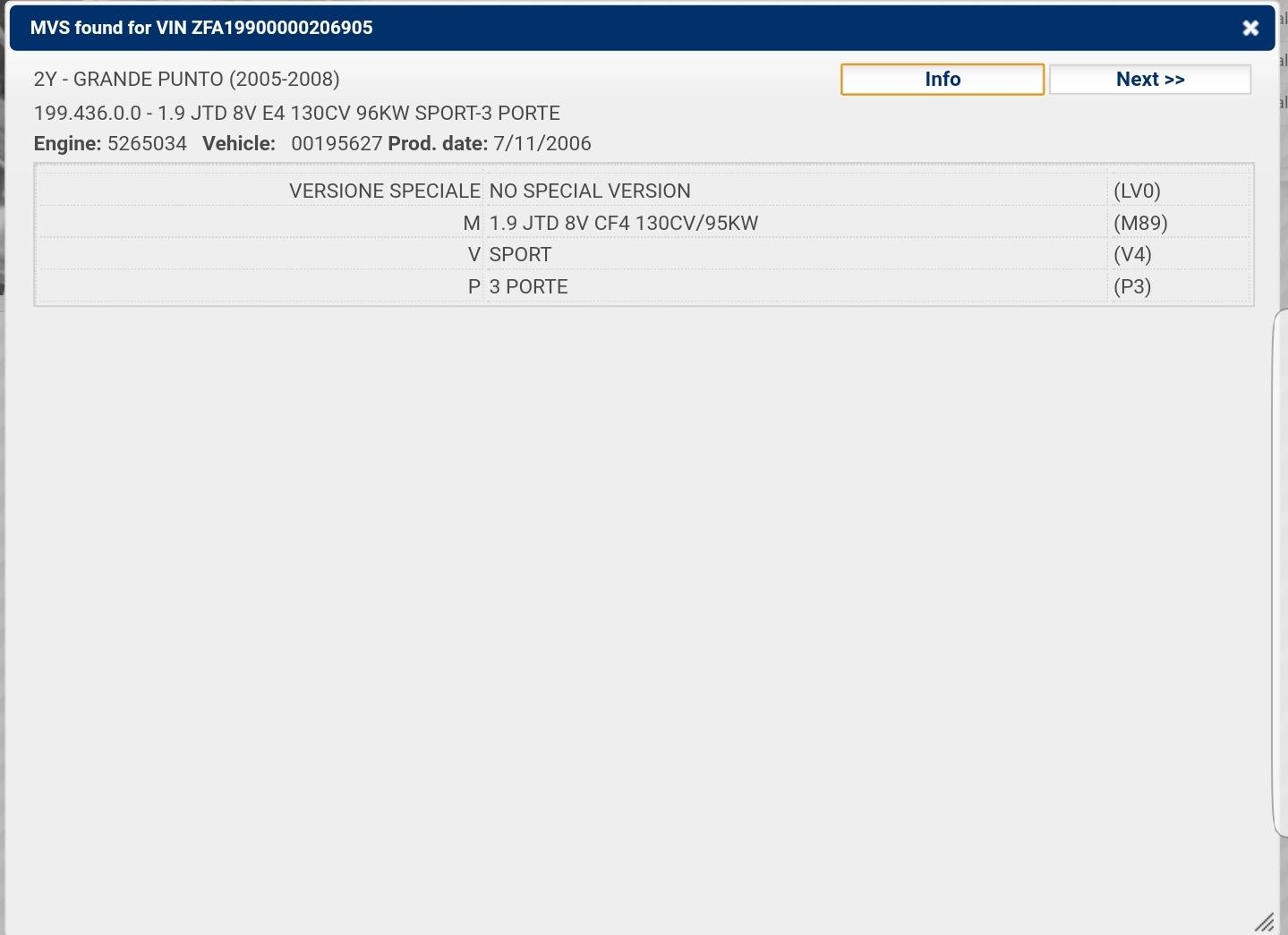

rocker87 5 Posted June 7, 2018 VIN: ZFA19900000206905 Ja se nemam pojma snaći po ovome, pa ako ima neka dobra duša, zahvaljujem unaprijed. Quote Share this post Link to post Share on other sites
shomispc 901 Posted June 7, 2018 Na eperu ne pise, ali ako je tacno ovo da je Euro 4 motor, onda je verovatno nekada imao Quote Share this post Link to post Share on other sites
rocker87 5 Posted June 7, 2018 Naravno, Euro 4 je motor, i izgleda da je moj mehaničar u pravu, a ovaj drugi nema pojma o životu. Hvala ti. Quote Share this post Link to post Share on other sites
