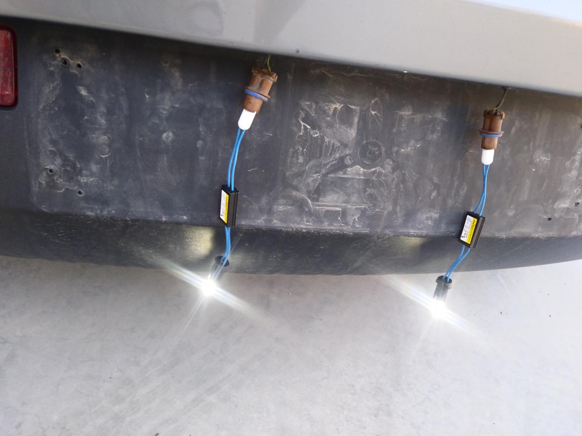

darkman14 7061 Posted July 5, 2018 @Milutinac Jel ti ovo pored km sata prepoznao da su narandzaste sijalice na maglenkama pa pokazuje info? 3 1 dekirs, djomla, shomiNBGD and 1 other reacted to this Quote Share this post Link to post Share on other sites

Milutinac 6529 Posted July 5, 2018 On 7/5/2018 at 12:54 PM, dekirs said: A protokomer ne spominjes.. Tj mnozina, protokomere... I to sam povadio salim se... Protokomer = ono cije se ime vise ne spominje... On 7/5/2018 at 1:00 PM, andreja.micovic said: @Milutinac Jel ti ovo pored km sata prepoznao da su narandzaste sijalice na maglenkama pa pokazuje info? ali bravo za ideju... Reseno davno...stigli otpornici sa alija Quote Share this post Link to post Share on other sites
