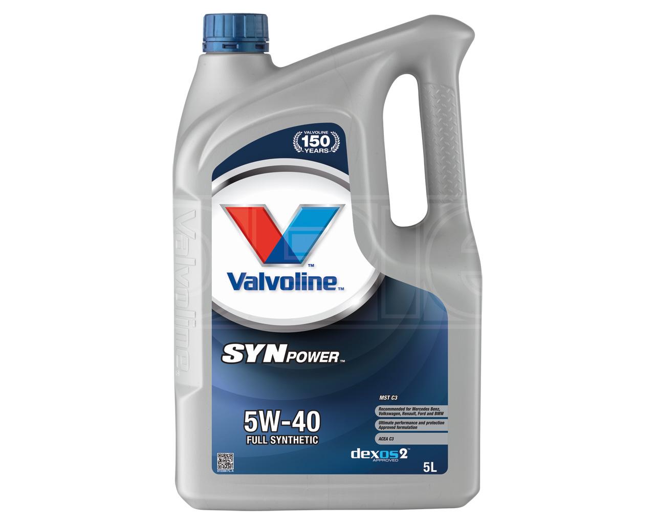

MiloshBg 1912 Posted December 5, 2022 Ovlasceni sad, koliko znam umesto Shell ulja sipaju Valvoline. 1 1 Ivan and horvat reacted to this Quote Share this post Link to post Share on other sites
Ivan 22113 Posted December 5, 2022 (edited) @MiloshBg Synpower MST, konkretno u 1.4? Edited December 5, 2022 by Ivan Quote Share this post Link to post Share on other sites
MiloshBg 1912 Posted December 5, 2022 Uh, ne bih znao tacnu oznaku ali po specifikaciji znam da odgovara, drugacije ne bi smeli. PS. Mislim da je to to. Quote Share this post Link to post Share on other sites
