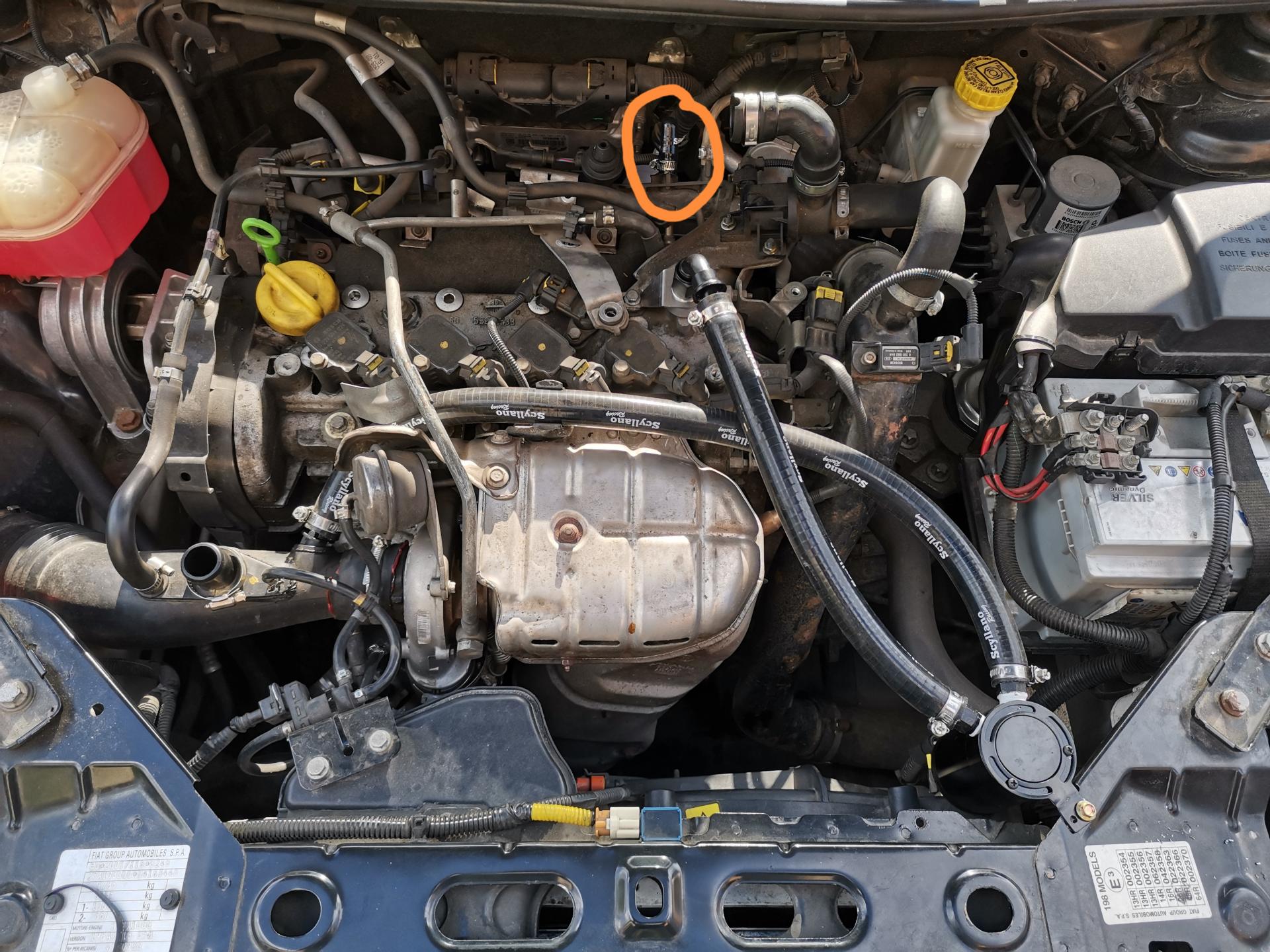

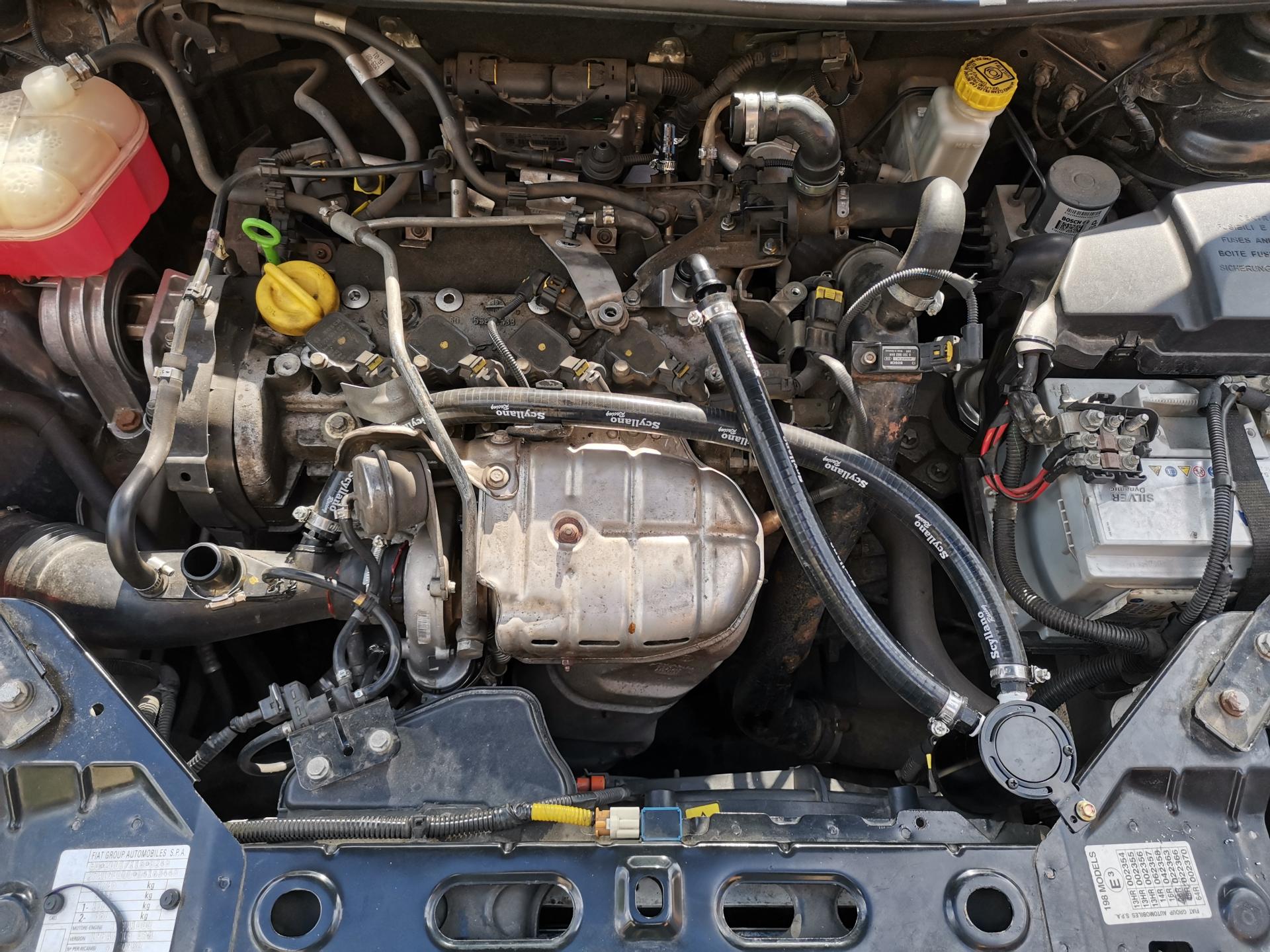

BaneAK74 116 Posted April 27, 2023 Uklonjen pcv 2 Mijailović P. and Branislav reacted to this Quote Share this post Link to post Share on other sites
Branislav 748 Posted April 30, 2023 (edited) Nice job, nisam znao da ces stavljati OCC varijantu super izgleda, samo napravi cep za crevo od turba ako vec nisi nabavio. Mozes i da skines crevo sa Blow-off i da nakacis mrezicu i da je stegnes i to je to resen problem i estetski je lepse Edited April 30, 2023 by Branislav 1 BaneAK74 reacted to this Quote Share this post Link to post Share on other sites

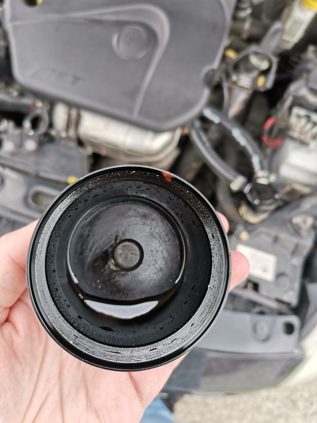

BaneAK74 116 Posted May 3, 2023 Posle 1000km. 2 neshtry and Branislav reacted to this Quote Share this post Link to post Share on other sites
Branislav 748 Posted May 7, 2023 Jebote sta se nakupi za tako malo kilometara..... Quote Share this post Link to post Share on other sites

OMP 4845 Posted May 8, 2023 hvala a gde ide ovaj patrljak od creva kao čep? Quote Share this post Link to post Share on other sites
BaneAK74 116 Posted May 8, 2023 Ide na usisnu granu. 2 stex_pb and MS PK reacted to this Quote Share this post Link to post Share on other sites
OMP 4845 Posted May 8, 2023 aha gledam na onoj gore slici ali ga nisam uocio Quote Share this post Link to post Share on other sites
