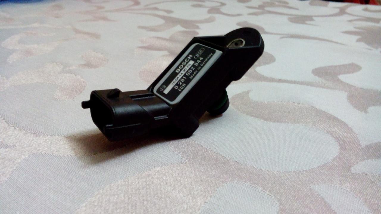

ivan.ik 625 Posted May 23, 2016 Šta ???? Čišćenje nije dalo rezultate ? Javi se u ProSporting na 011/2463-465 imaju Bosch. On 12.5.2016. at 0:24 AM, ivan.ik said: Nažalost MAP senzor nije izdržao svu tu snagu i pritisak turbine. Našao sam mu dostojnog naslednika. Quote Share this post Link to post Share on other sites

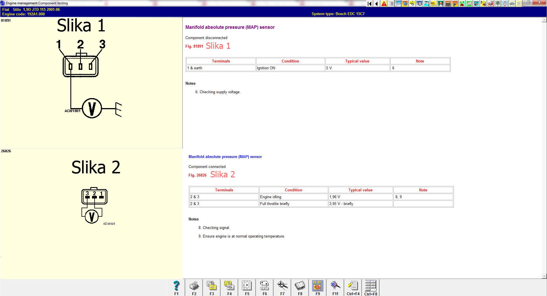

majstormica 25 Posted September 16, 2016 (edited) On 5/24/2016 at 11:10 PM, Mc Shok said: Moze li mi neko u kratkim crtama opisati kako mogu provjeriti rad map senzora sa unimerom ? Kasnim sa odgovorom, mozda ce znaciti nekom. Edited September 16, 2016 by majstormica 1 neshaoct reacted to this Quote Share this post Link to post Share on other sites

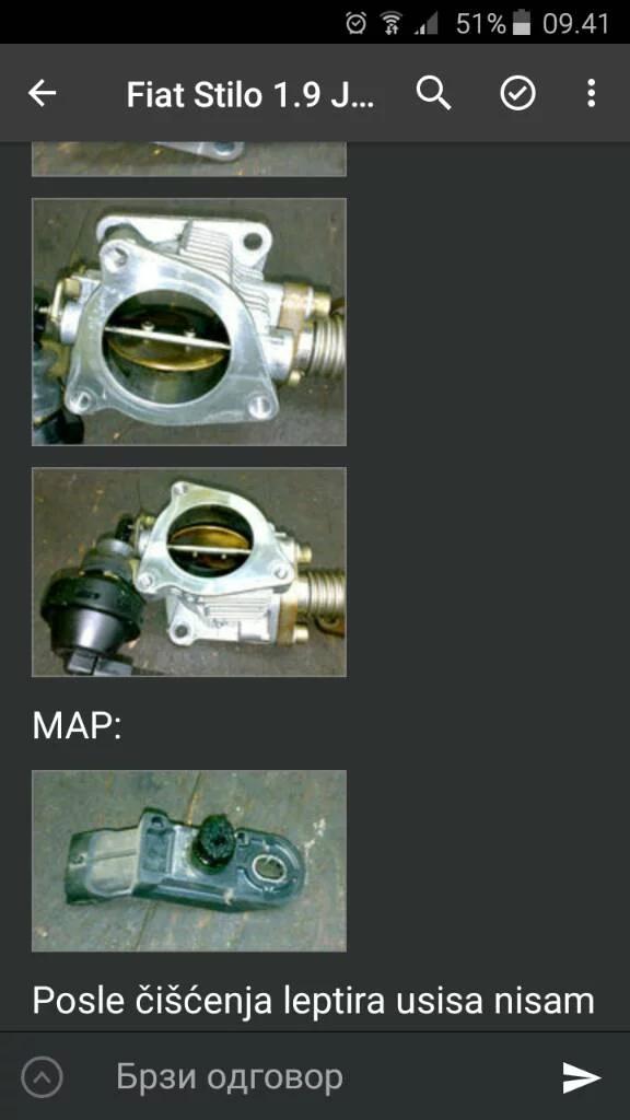

MS PK 8308 Posted March 17, 2018 @Bole1987 Ovo na zadnjoj slici ti je map senzor. Nalazi se na usisnoj grani, pored Egr ventila, malo prema kabini. Drzi ga jedan torex, odvijes i samo izvuces. Cisti ga nekim sprejom, tipa Carb cleaner ( 500-600din) prskas samo dok se ne ispere . Dobro osusis i vratis. 1 neshaoct reacted to this Quote Share this post Link to post Share on other sites

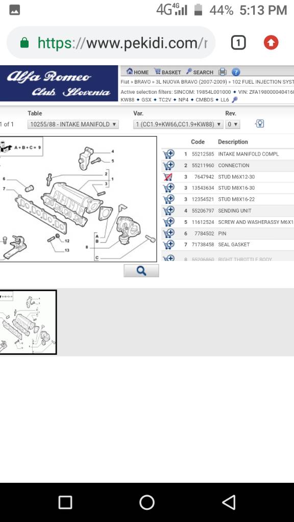

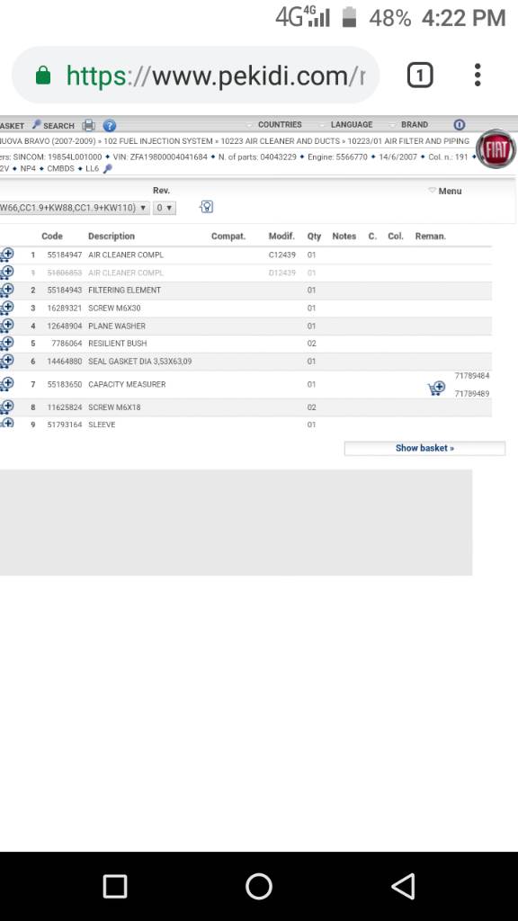

ISV_01 4796 Posted February 19, 2020 [mention=20890]kvazarija[/mention] Mislim da ti je najbolje da proveris preko VIN-a u ePer-u, u delu Fuel injection systems > Air Cleaner and Ducts, pa vidis na crtezu stavku 7 - capacity measure.Skroz levo ti pise OEM broj tog dela pod kojim ga trazis. Npr kod mene je ovako: Sent from my S10 PRO using Tapatalk Quote Share this post Link to post Share on other sites

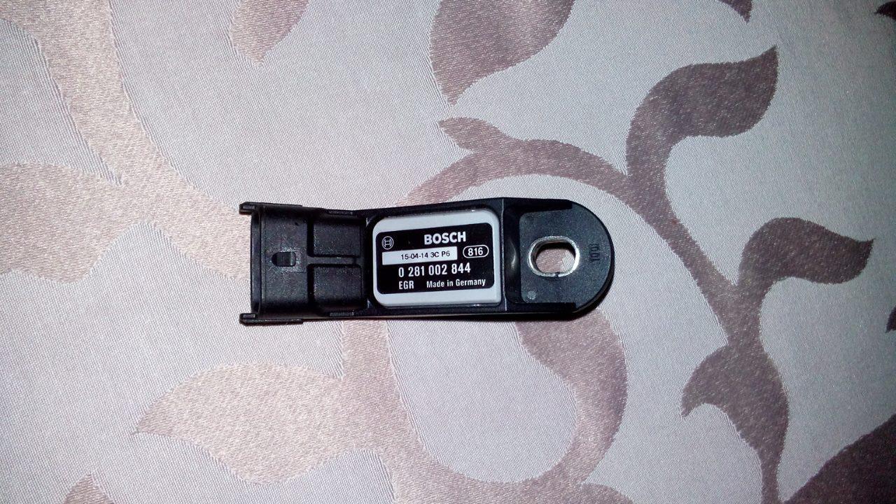

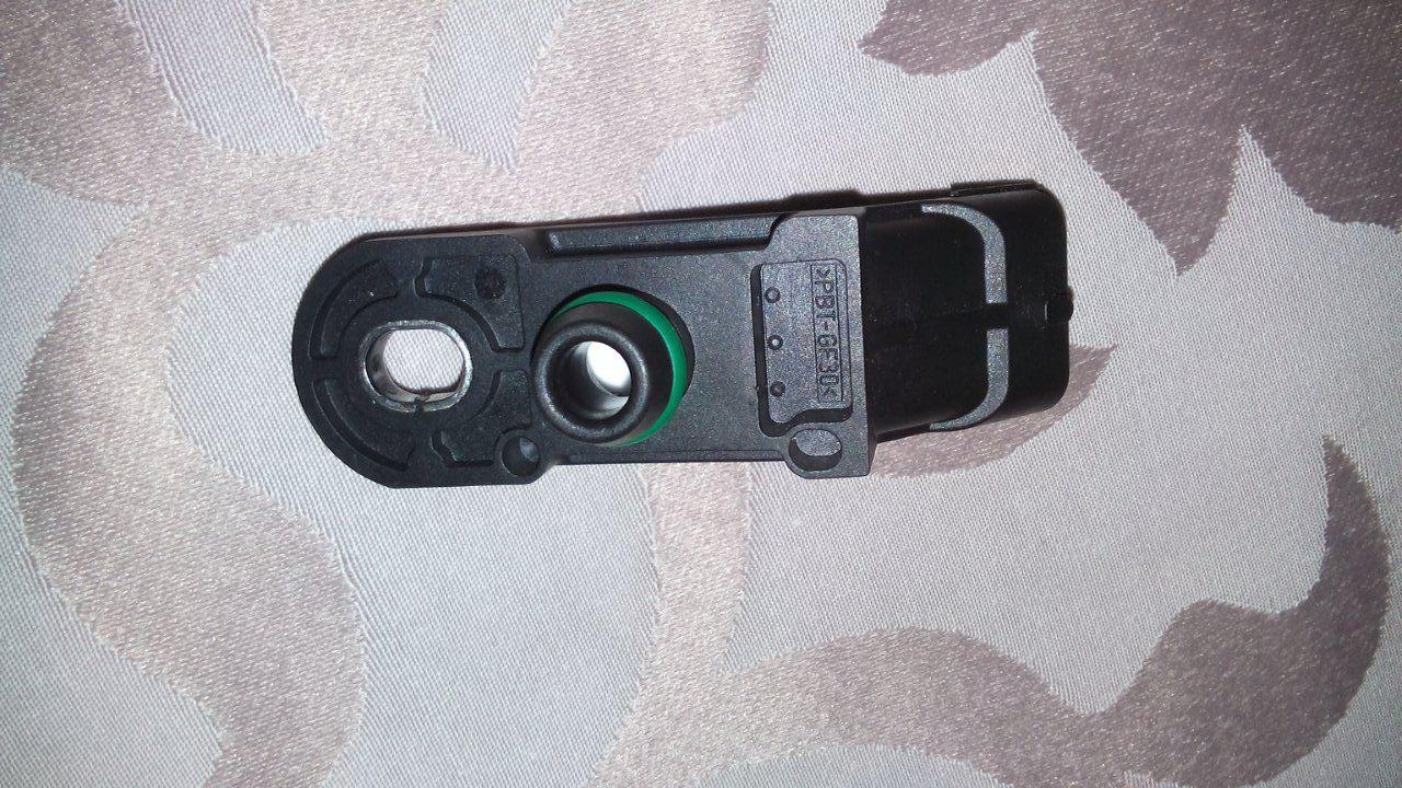

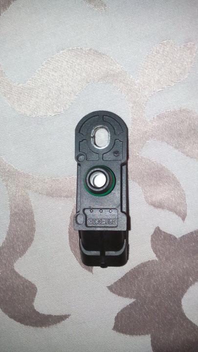

kvazarija 25 Posted February 19, 2020 Porucili su mi ovaj, kazu da taj odgovara...zamenski naravno. Original je 16.200 din.Sent from my SM-N935F using Tapatalk Quote Share this post Link to post Share on other sites
ISV_01 4796 Posted February 19, 2020 Ah da..ja citam MAF umesto MAP...e blago meni.. Probaj preko ePera isto, samo idi na Intake Mainfold pa gledaj stavku pod 4 U principu tako i izgleda i moj, posto imamo iste motore, ali ne mogu da se zakunem da li taj odgovara. Znam da je i moj bosh-ov.Sent from my S10 PRO using Tapatalk Quote Share this post Link to post Share on other sites
kvazarija 25 Posted February 19, 2020 Ok, dace mi ovaj MAP da postavim pa cu videti da li valja. Uglavnom, ljudi pisu da su imali problem sa razlicitim pritiscima u usisu kad je problem MAP. Nadam se da ce nov senzor resiti problem.Jedino ako nije overbust ventil i creva vakuuma. Koje su posledice kad su oni problem?Sent from my SM-N935F using Tapatalk Quote Share this post Link to post Share on other sites
