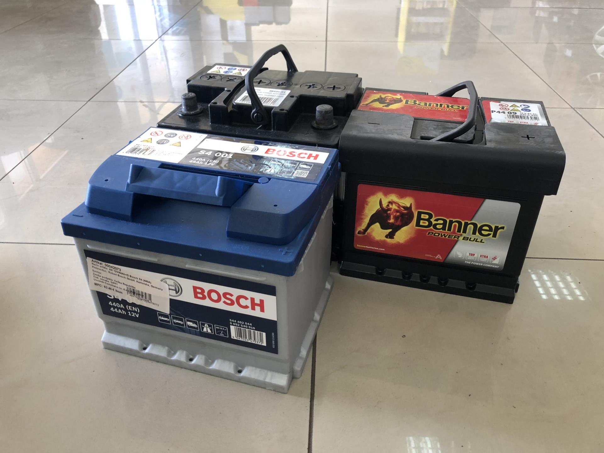

Zan Batist 399 Posted June 9, 2020 (edited) car battery finder-i kazu 44Ah za 1.2 pao mi za oko Banner professional 42Ah (390A), sto mislite? crkao gad inace poslije 3god., neki OKAY (44Ah 380A), made in GER.. eto mogu i njemci da fulaju.. Edited June 9, 2020 by Zan Batist Quote Share this post Link to post Share on other sites

Zan Batist 399 Posted June 10, 2020 (edited) izabrao Bosch S4 (44Ah 440A), bjese mi nesto prasnjav Banner I izgubih volju.. a i dobro iskustvo sa B (vec 7, 8 g. u 306) 50.8EUR (da svoj 20% off) Banner PowerBull bio 0.5EUR jeftiniji al 20A ima manje. Edited June 10, 2020 by Zan Batist Quote Share this post Link to post Share on other sites
