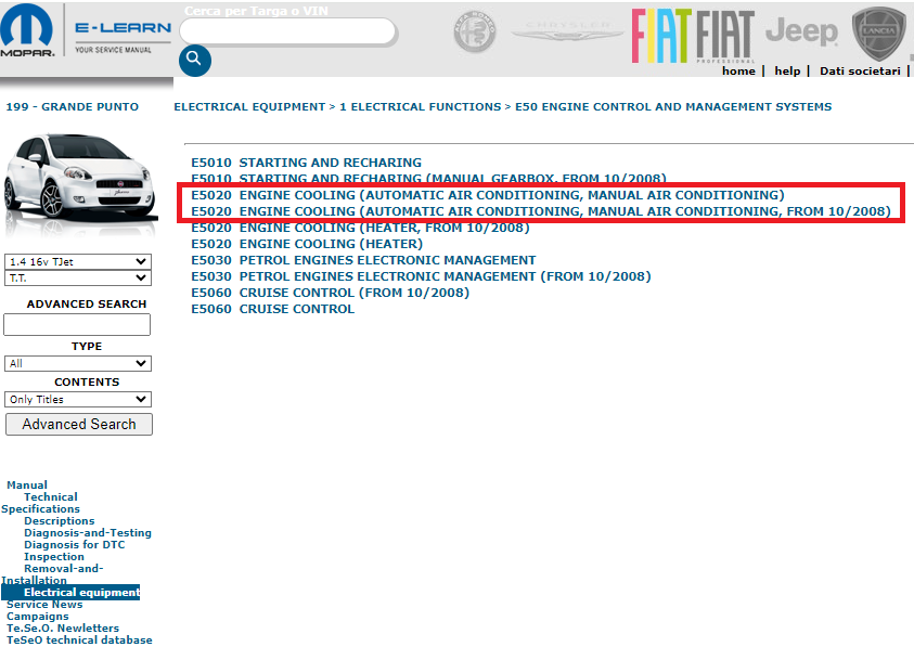

Ivan 22117 Posted April 4, 2024 Tako mu kaze fabrika . Quote Share this post Link to post Share on other sites
OMP 3957 Posted April 4, 2024 Ja znam da moj nema dve brzine ali ok ako je vazilo za modele do 2008. posto je moj 2009. Quote Share this post Link to post Share on other sites
Ivan 22117 Posted April 4, 2024 (edited) Sa eLearn nema "ako". Sve je do u zadnji sraf, mozes da iskopas do najbanalnije sitnice koja te zanima, opasno korisna stvar. Jedino ako ga u Melfiju nije sklapao neki Giancarlo, kao sto su nasi sklapali Yuga . Edited April 4, 2024 by Ivan 1 shuxx reacted to this Quote Share this post Link to post Share on other sites
