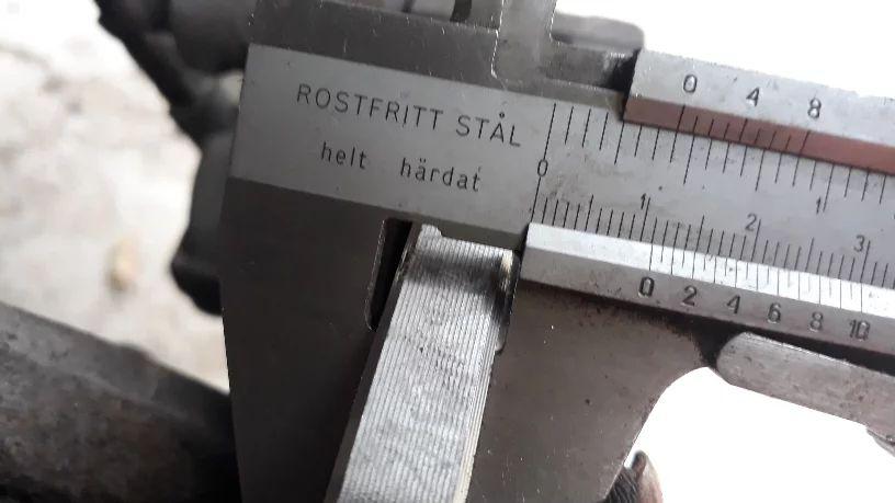

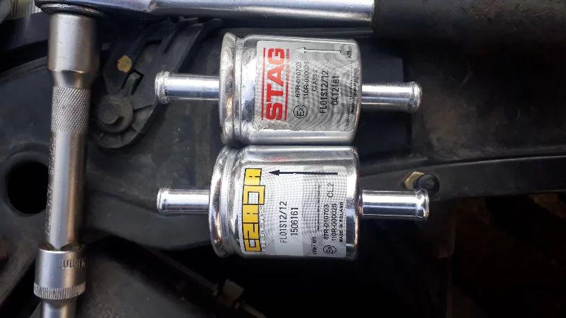

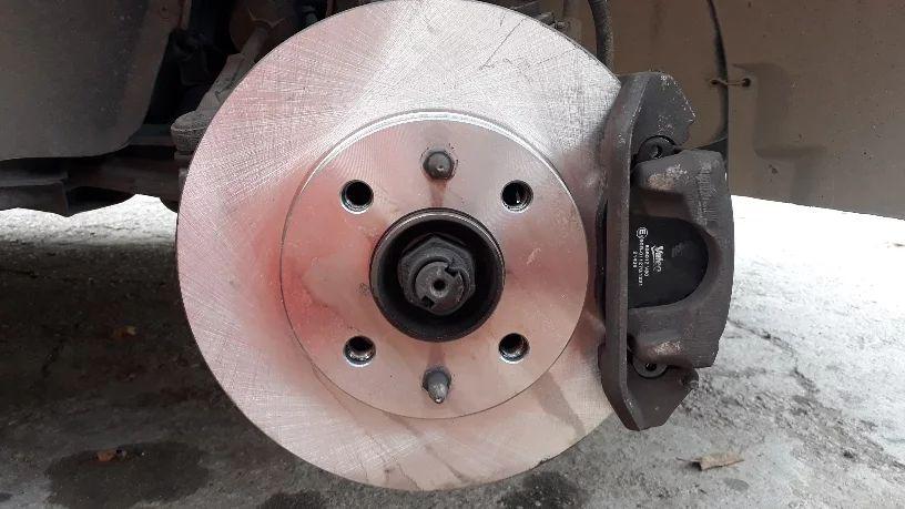

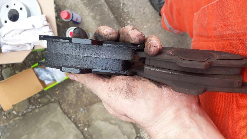

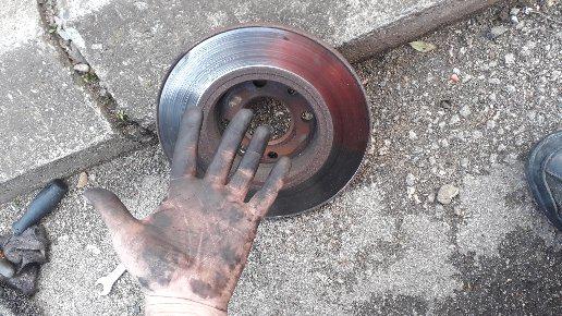

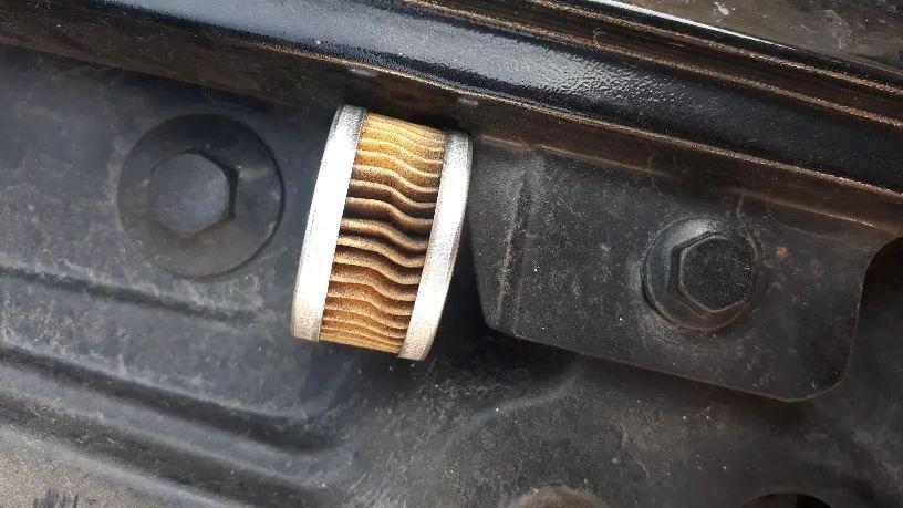

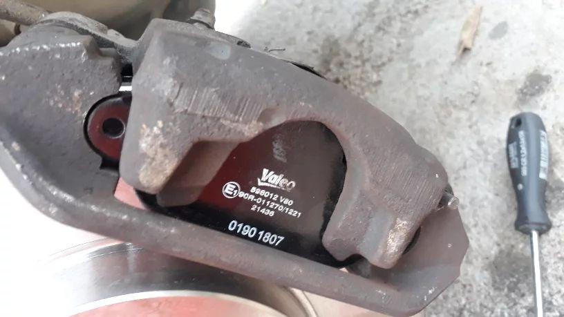

shuxx 15984 Posted December 14, 2019 (edited) Zamenjeni TNG filteri. Nisu bili prljavi. Sada na oko 15000km. Sledeca zamena za 20000km. Takodje zamenjeni kocioni diskovi i plocice. Stavljene Valeo. Videcu utiske uskoro. Nov disk 11mm debljine. Moj zamenjen 8.5... ispod preporucenog minimuma od 9.2mm Naravno sam svoj majstor. Jednostavno je licno zadovoljstvo kad sam to odradis.... Edited December 14, 2019 by neshaoct prebacio slike na FLCS server 3 neshtry, neshaoct and moron reacted to this Quote Share this post Link to post Share on other sites
MS PK 8306 Posted December 14, 2019 Ja sam stavio Valeo letos, ok su 2 neshtry and shuxx reacted to this Quote Share this post Link to post Share on other sites
Flex 1884 Posted December 14, 2019 Ti si stavio jer su najjeftiniji. 1 totti reacted to this Quote Share this post Link to post Share on other sites
neshaoct 9740 Posted December 14, 2019 3 hours ago, shuxx said: Nov disk 11mm debljine. Moj zamenjen 8.5... ispod preporucenog minimuma od 9.2mm Srećom nisi često oštro kočio, zaletao auto pa nabadao kočnicu do patosa...mog'o je da pukne disk tada jer koliko znam tu je 1mm debljine veeeeeeel'ki, a bio je toliko ispod i onog minimuma... Biće dobar Valeo za Puntića Meni Bosch sada napred zna da zaškripi...znao je i Valeo na Stilu, ATE isto, i Brembo ponekada....tako da kontam da je više do načina vožnje ako manje ili više sve proškripe u nekom momentu... 2 neshtry and MS PK reacted to this Quote Share this post Link to post Share on other sites
MS PK 8306 Posted December 14, 2019 Ti si stavio jer su najjeftiniji. Stavio majstor, nije me ni pitao a ni ja se nisam interesovao Послато са SM-J330F помоћу Тапатока Quote Share this post Link to post Share on other sites
shuxx 15984 Posted December 14, 2019 Mora da je Najjeftiniji majstor Sent from my SM-A320FL using Tapatalk Quote Share this post Link to post Share on other sites

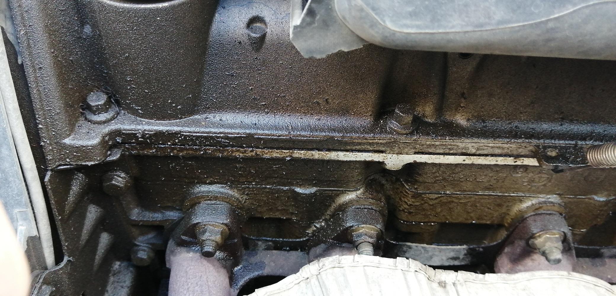

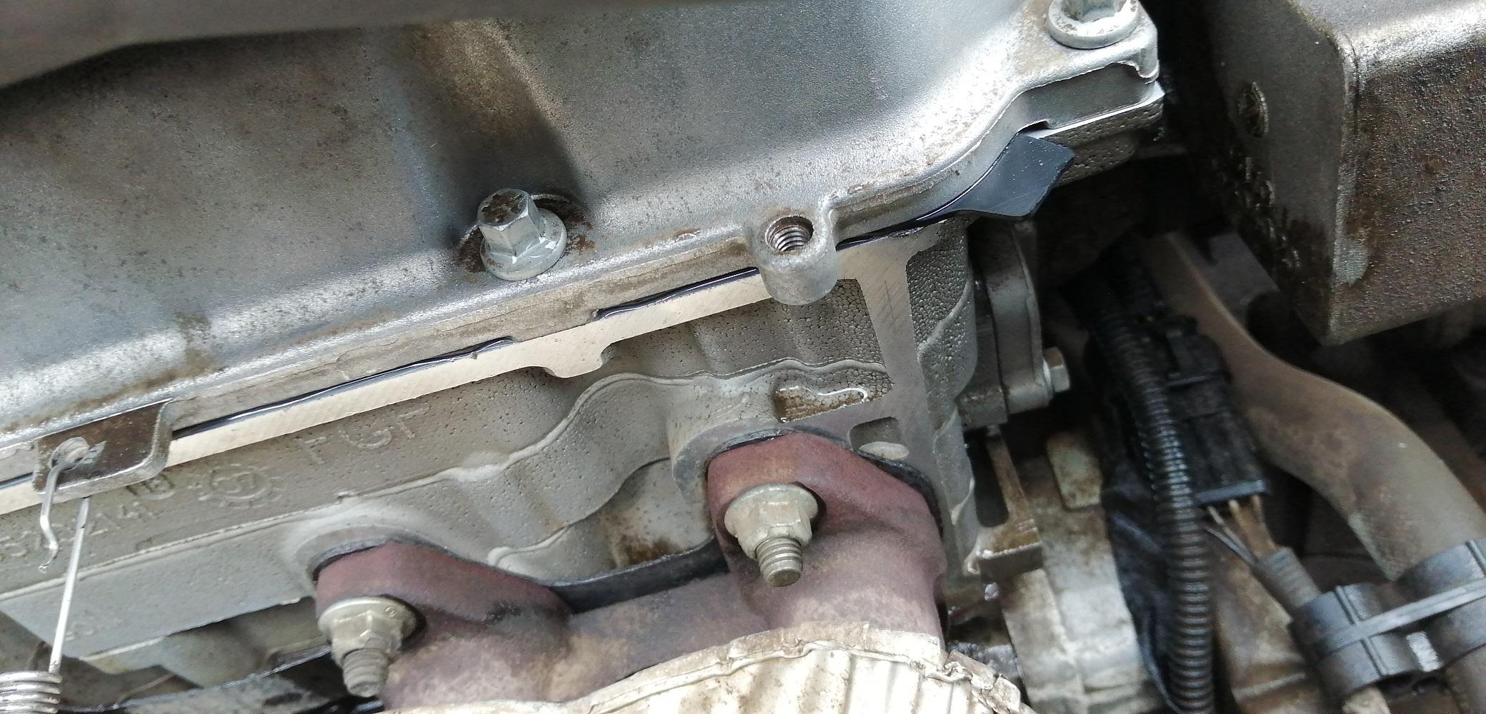

shuxx 15984 Posted February 13, 2020 Kilometar sat pokazuje 72700km, što je celih 20 000km, od kupovine....jes...klotara ...ali me lepo služi, uskoro mali servis, BRISK svećice, zamena zaptivača poklopca ventila ( valjano mi je zamazan motor ), dolivano ulje, možda 0,5L.... za 13000km. Provera kajševa ... jer ne znam baš sigurnu istoriju velikog servisa... i idemo dalje.... ja sam zadovoljan... 3 neshtry, moron and Mijailović P. reacted to this Quote Share this post Link to post Share on other sites

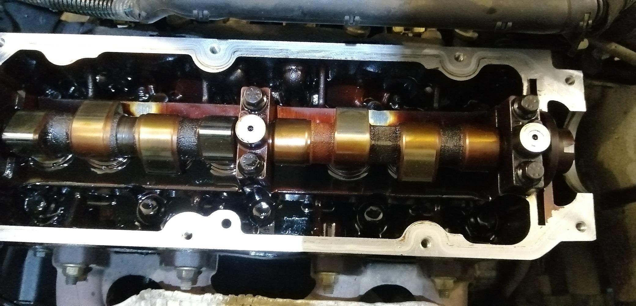

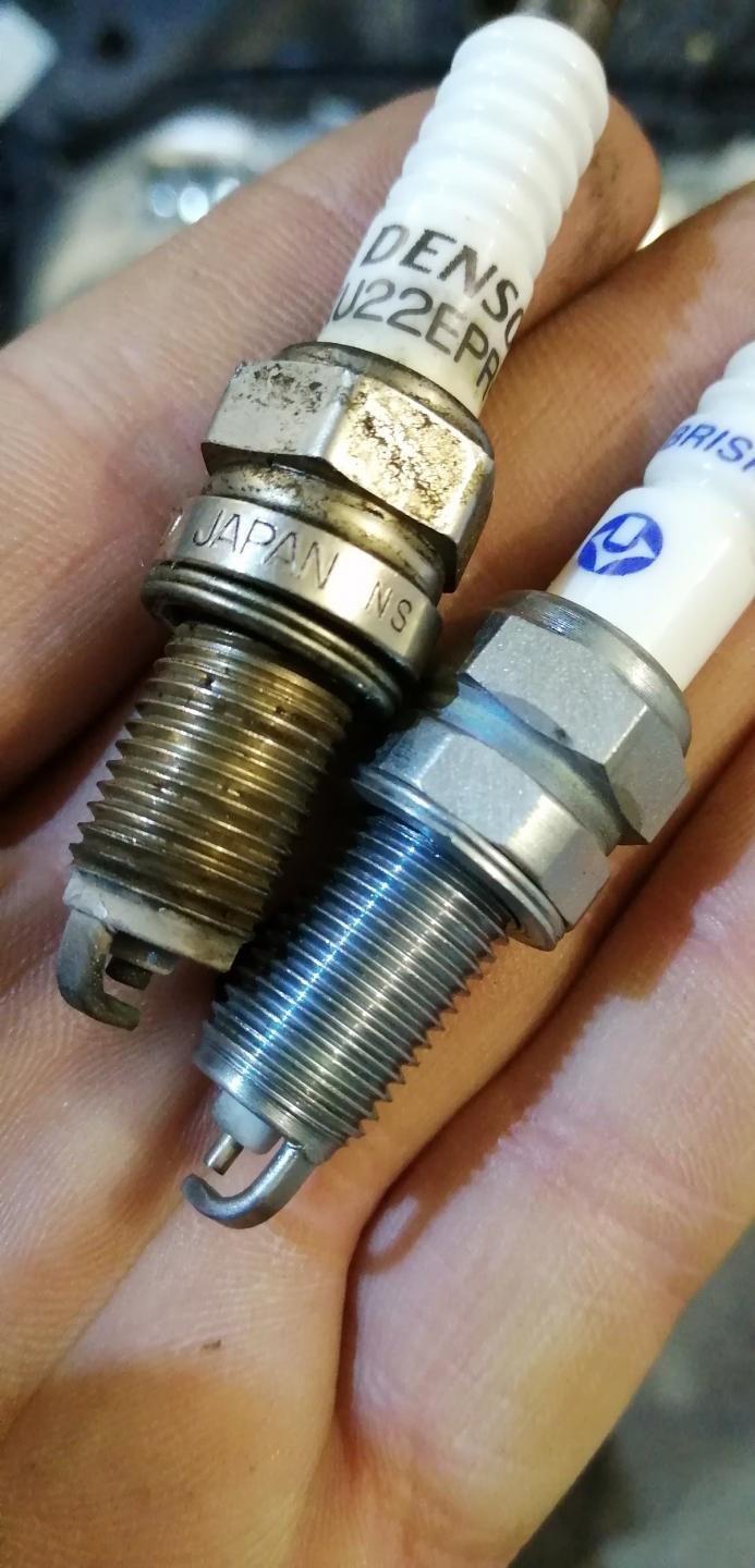

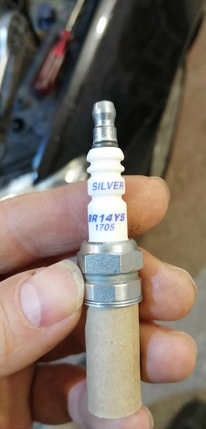

shuxx 15984 Posted March 16, 2020 za vikend, zamenjene svećice, stavljene Brisk silver BR 14 YS - makedo bgd urađen mali servis, filteri vazduha i ulja, + ulje.... na 75 000km i zamenjen dihtung poklopca ventila stanje pre i posle zamene..... za utiske ćemo sačekati neko vreme stanje starih svećica je prilično dobro, ako je verovati starom vlasniku zamenjene su prilikom velikog servisa na 47 000km, sa sada sam na 75000, što je 28000km i po meni mogle bi još da teraju, možda uz štelovanje zazora.... 2 MS PK and moron reacted to this Quote Share this post Link to post Share on other sites
danijel55 856 Posted March 16, 2020 Apropo svecica,desco preporuka i od mene i majstora.Duplo jeftinije od NGK,a blizu su istog kvaliteta. Quote Share this post Link to post Share on other sites
shuxx 15984 Posted March 16, 2020 Sta reci. Skoro sam cuo za denso iridijum oko 1200 din kom i zamena na oko 80 000km. Sto je zaista korektno. Ali... Mozda u nekoj sledecoj zameni.... Sent from my POT-LX1 using Tapatalk Quote Share this post Link to post Share on other sites
