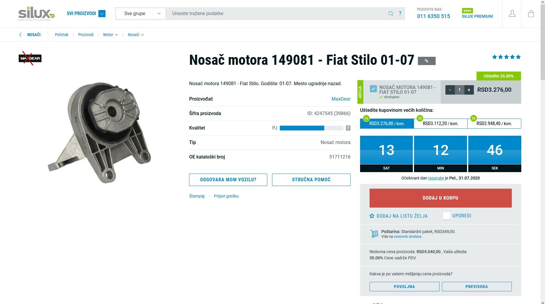

Darko_gr 49 Posted July 28, 2020 (edited) Da li je to ovaj nosac? https://www.silux.rs/proizvodi/motor/nosaci/4247545/nosac-motora-149081-fiat-stilo-01-07 Edited July 28, 2020 by neshaoct dodao printscreen Quote Share this post Link to post Share on other sites
MS PK 8306 Posted July 28, 2020 Meni nesto ne radi link Quote Share this post Link to post Share on other sites
milekontras 4 Posted July 28, 2020 (edited) @Darko_gr Čini mi se da je taj. Edited July 28, 2020 by Ivan Skinut nepotreban citat, dodat tag Quote Share this post Link to post Share on other sites

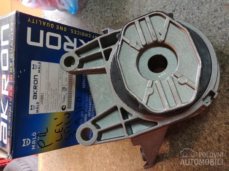

Axic 22535 Posted July 28, 2020 (edited) Ako je Acron izbegni ga jer nije neki sinonim za kvalitet. I usput silux takođe preskoči i drži se proverenih radnji auto delova. Edited July 28, 2020 by Ivan Skinut nepotreban citat 1 djomla reacted to this Quote Share this post Link to post Share on other sites
Ivan 22123 Posted July 28, 2020 Moja preporuka i iz licnog iskustva uvek ide za OEM varijantu kod ovlascenih. Jeste malo skuplje, ali se itekako isplati, a pogotovo ako se planira da se auto iole duze zadrzi. 2 djomla and Axic reacted to this Quote Share this post Link to post Share on other sites
Darko_gr 49 Posted July 29, 2020 Hvala. Osim oem, kojeg jos proizvodjaca gledati? Kako se zvanicno zove taj nosac? Donji? Ispod akumulatora?.. Quote Share this post Link to post Share on other sites
milekontras 4 Posted July 29, 2020 Nosač menjača Quote Share this post Link to post Share on other sites
Flex 1884 Posted July 29, 2020 Oem sam ja platio 6100 pre skoro 2 godine. Nemoj da uzimas Akron i slicne gluposti. Quote Share this post Link to post Share on other sites
milekontras 4 Posted July 29, 2020 Ja sam sa zamenom platio 10000. Quote Share this post Link to post Share on other sites
Darko_gr 49 Posted July 31, 2020 Zvao sam stojanov ovlasceni servis. Trenutno je originalni nosac 4.800 na akciji. Actron je oko 25e. Da li je to sigurno ovaj nosac da ne uzmem pogresni? Quote Share this post Link to post Share on other sites
