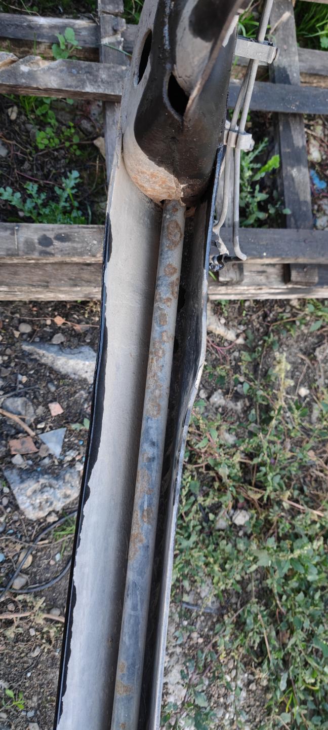

horvat 6457 Posted October 20, 2022 Torzija je montirana? Sta kaze optika posle montiranja nove torzije? Quote Share this post Link to post Share on other sites

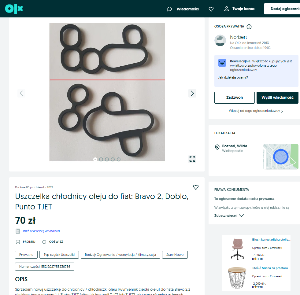

Branislav 722 Posted October 20, 2022 (edited) Odradjeno sve, rezultat u slici u prilogu, pokrivila se leva strana torzije, a ja mislio desna zbog razmere prostora izmedju branika. Sad torzija stoji kao puska, pronadjeno je i jako malo flisovanje ulja na hladnjaku ulja tj otisla je gumica, kaze majstor jebeno za srediti a nije hitno. Zamenjene plastike napred i pregledan trap sve kao puska. Inace volan sada pobegao u kontra stranu i cega reglazu kad kupim 2 nove gume Edited October 20, 2022 by Branislav Quote Share this post Link to post Share on other sites
darkman14 5901 Posted October 20, 2022 31 minutes ago, Branislav said: hladnjaku ulja da li je ista prica kao za dizelase? menja se ceo hladnjak jer nema gumice da se kupi i da treba kupovati od opela? 1 Branislav reacted to this Quote Share this post Link to post Share on other sites
Branislav 722 Posted October 20, 2022 Iskreno ne znam ali sam siguran da bi nekako napravio tu gumicu, ne bih uzimao ceo hladnjak bez potrebe Kad sam za punta mogao da napravim na cnc masini metalnu racvu za antifriz napravio bih i gumicu Quote Share this post Link to post Share on other sites
Branislav 722 Posted October 20, 2022 (edited) @andreja.micovic Evo link od poljaka koji prave za Tjet https://m.olx.pl/d/oferta/uszczelka-chlodnicy-oleju-do-fiat-bravo-2-doblo-punto-tjet-CID5-IDmr47v.html Hvala @Sem za info oko ove gumice Edited October 20, 2022 by Ivan Dodat PrintScreen 2 darkman14 and Sem reacted to this Quote Share this post Link to post Share on other sites
Ivan 17680 Posted October 20, 2022 (edited) Pisalo se ovde: https://www.fiat-lancia.org.rs/forum/index.php?/topic/84468-fiat-nuova-bravo-14-tjet-150-zaptivač-hladnjaka-za-ulje/ Dodao sam PrintScreen i prebacicu link iznad u tu opstu tehnicku temu. Edited October 20, 2022 by Ivan Quote Share this post Link to post Share on other sites
