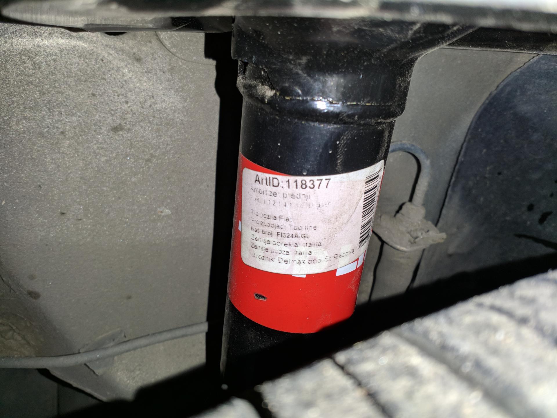

Tesha 18 Posted June 2, 2020 Za to ostalo nemam pojma. Nisam obracao paznju. Ukupno me izaslo sa zamenom oko 17k din. Uspeo sam da slikam prednji. Valjda je model taj sa nalepnice. Nesto FI324A... 2 shuxx and neshtry reacted to this Quote Share this post Link to post Share on other sites

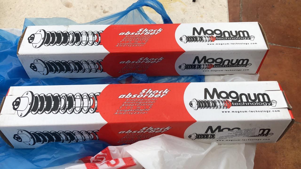

Zan Batist 399 Posted June 15, 2020 On 10/3/2019 at 12:42 PM, neshtry said: Meni su ovi Magnum Technology, made in polska, za izbegavanje… drugar, moze objasnje? Quote Share this post Link to post Share on other sites
Zan Batist 399 Posted June 17, 2020 @neshtry, drugar mozes li da obrazlozis ovu tvrdnju? Quote Share this post Link to post Share on other sites
Ivan 22118 Posted June 17, 2020 Malo strpljenja, vidis da kolega uoblicava odgovor vec treci dan . 2 3 Zan Batist, djomla, Axic and 2 others reacted to this Quote Share this post Link to post Share on other sites
neshtry 19697 Posted June 17, 2020 Išao sam po kevu u Frankfurt...Skinuo sam ih posle 11 meseci(prsli) i stavio polovne bilstsain dok ne kupim druge i ostali bilstsain jer drastično bolji čak i polovni...onda sam dao burazu taj auto.možda me zapali takvi jbmli ga,ali ne volim to šarelo u kvalitetu...Sent from my motorola one macro using Tapatalk 1 Ivan reacted to this Quote Share this post Link to post Share on other sites
Zan Batist 399 Posted June 17, 2020 zamirisalo mi je da pricas napamet, sori… ok, kapiram, sve u svemu - lose iskustvo. bas razliciti stavovi na net o ovom proizvodjacu, od tesko biiip do sasvim ok.. a ogromna mi je razlika, 40e Magnum - 80e Monro.. Quote Share this post Link to post Share on other sites
neshtry 19697 Posted June 17, 2020 Moj drug Dušan ih hvali, ali meni se ne dopada to šarenilo kvaliteta...mislim, desi se i velikima ali puno ređe...Monro su meni legli... Sent from my motorola one macro using Tapatalk Quote Share this post Link to post Share on other sites
Zan Batist 399 Posted June 20, 2020 pa sto mi bog da.. test voznja prosla super, prav kao strijela! 3 Ivan, shuxx and Mijailović P. reacted to this Quote Share this post Link to post Share on other sites
shuxx 15982 Posted June 20, 2020 Pisi koliko para, a kasnije javi i utiske... Kad se slegnu...Sve novo, je Novo...SrecnoSent from my POT-LX1 using Tapatalk Quote Share this post Link to post Share on other sites
Zan Batist 399 Posted June 20, 2020 22€ kom., dali mi 10%off za gotovinu = 39.60€. bas povoljno.. Monro su 42€ kom. - u drugu radnju, nisu htjeli da cuju za popust a Made in EU (nervira me to kad se kriju iza EU, reci brate dje su pravljeni.. da je Francuska stavili bi..) sad je Panda stabilna, dobar osjecaj… bjezala mi je na neravnine, prelaske s puta na most, itd.. javljam na sledeci pitstop.. 1 1 Mijailović P. and Ivan reacted to this Quote Share this post Link to post Share on other sites
