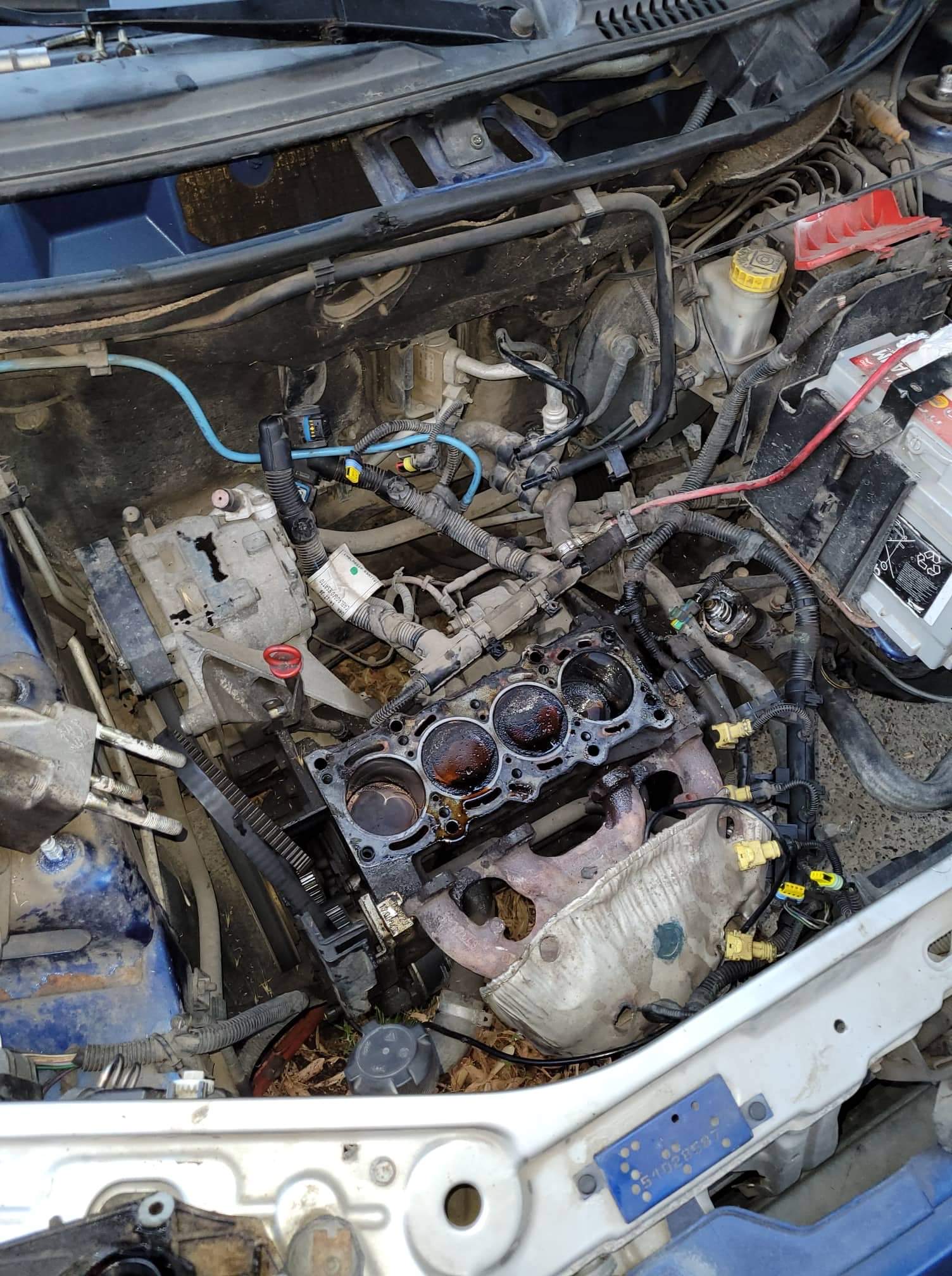

neshtry 19668 Posted June 30, 2022 Prslo mi hlađenje,izgleda dihtung glave…kako da proverim,zna li ko? koje su manifestacije loše pumpe za vodu? 1 horvat reacted to this Quote Share this post Link to post Share on other sites
horvat 7011 Posted June 30, 2022 Losa pumpa za vodu bi mozda curila ili se auto pregreva? A test za dihtung glave, test prisustva izduvnih gasova u rashladnoj tekucini. To imaju neki serviseri, a moze i da se kupi na KP ili po prodavnicama alata. Onako epruveta neka sa tecnoscu, pa promeni boju... Quote Share this post Link to post Share on other sites
neshtry 19668 Posted July 1, 2022 Luftiram na luftreu na hladnjaku,ima vazduha koliko hoćeš….Ide kod majstora danas,pa ću videti…Hvala Igore Sent from my iPad using Tapatalk 2 shuxx and horvat reacted to this Quote Share this post Link to post Share on other sites
horvat 7011 Posted July 1, 2022 Bas napisi sta je bilo... Quote Share this post Link to post Share on other sites
MS PK 8302 Posted July 1, 2022 Cim stalno ima vazduha onda je verovatno dihtung, kod punta bese puca na prvom ili cetvrtom klipuПослато са SM-A307FN помоћу Тапатока Quote Share this post Link to post Share on other sites
PremieRacing 6192 Posted July 1, 2022 41 minutes ago, horvat said: Bas napisi sta je bilo... Bio kvar. 3 darkman14, Axic and horvat reacted to this Quote Share this post Link to post Share on other sites

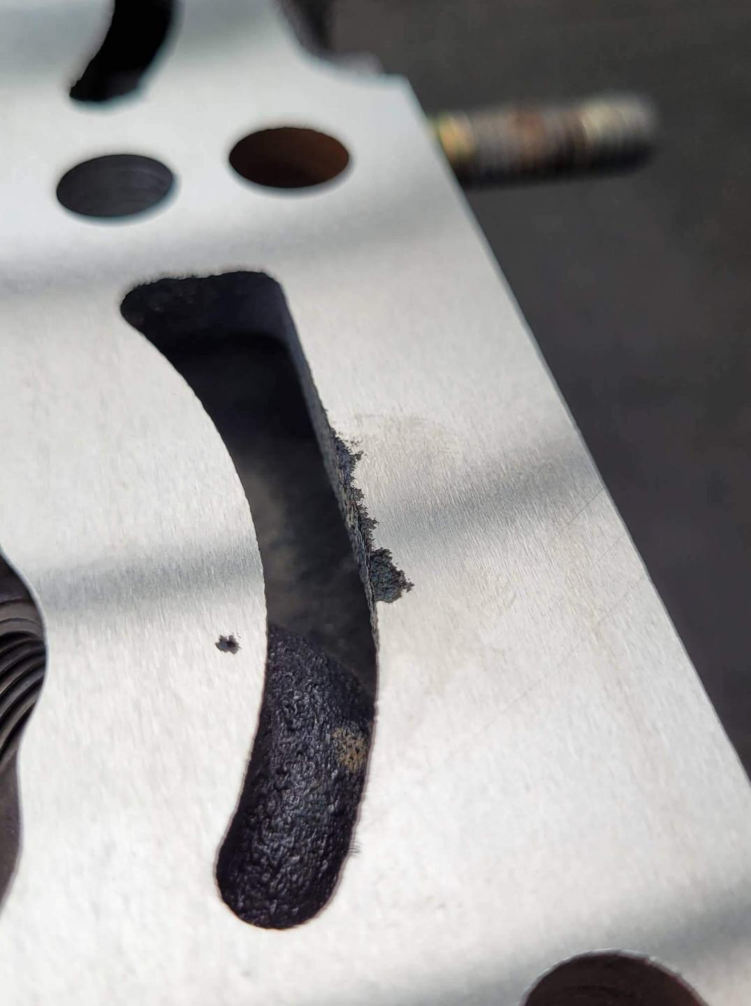

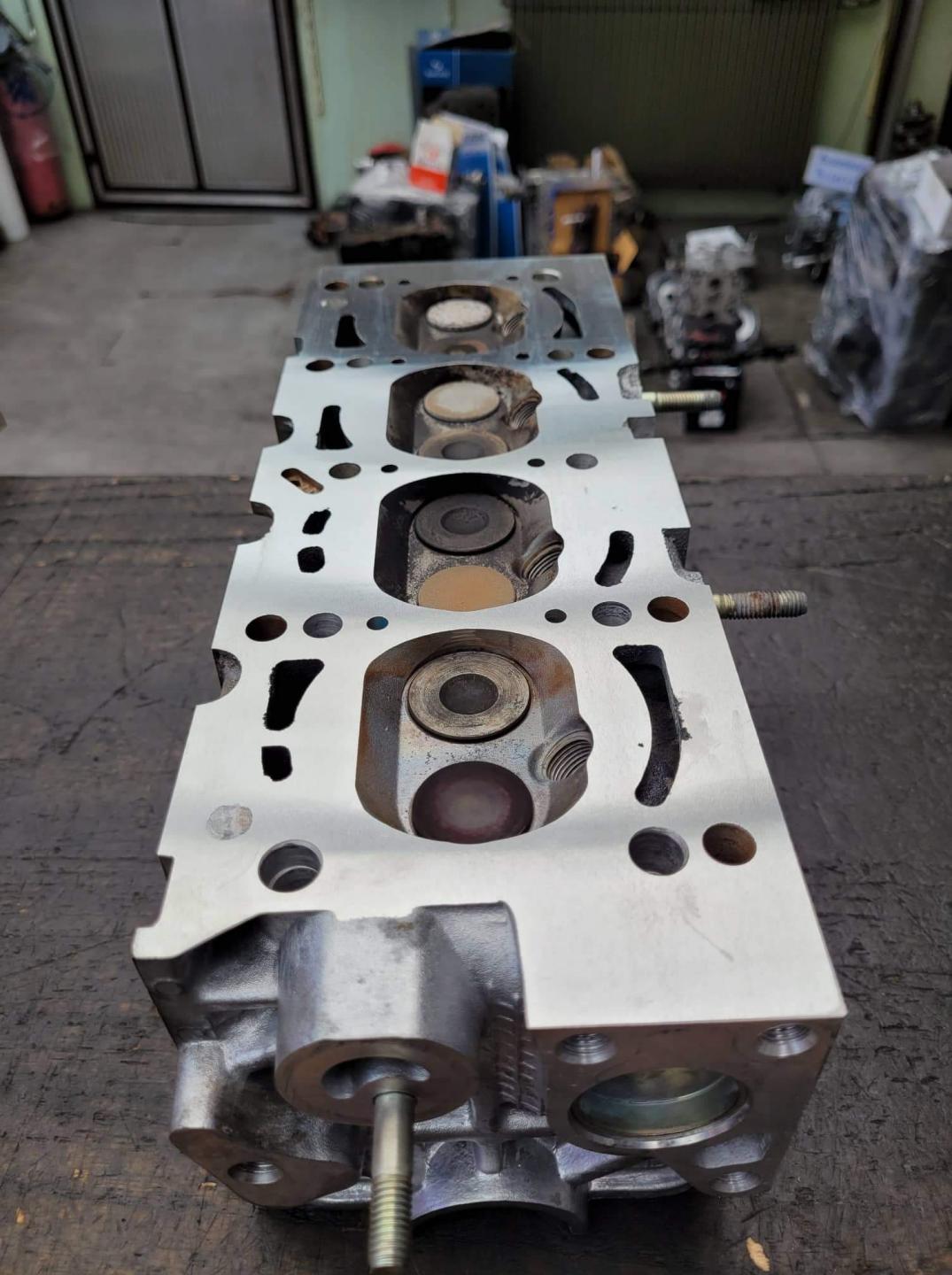

neshtry 19668 Posted July 3, 2022 Beheaded….Kaže majstor dihtung glave je iz prve ugradnje Sutra kontrola glave i ravnanjeSent from my iPad using Tapatalk 4 Reacher Gilt, horvat, Djuk85 and 1 other reacted to this Quote Share this post Link to post Share on other sites

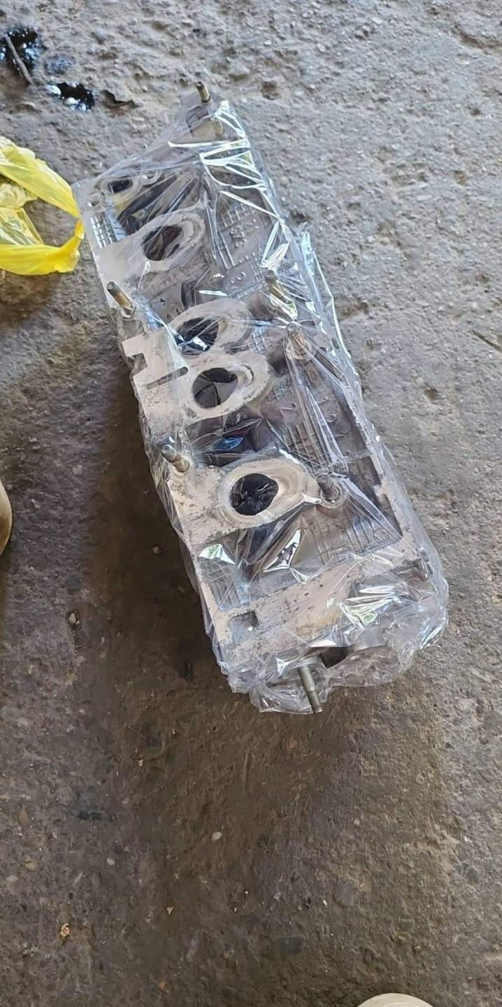

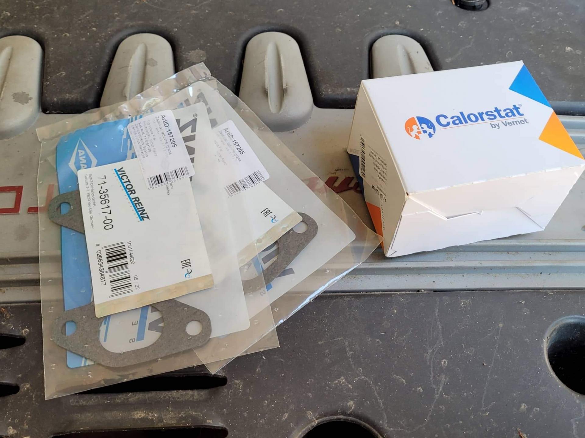

neshtry 19668 Posted July 4, 2022 Glava sređena,ne bez problema,ali sređena…. Kupljen i termostat i dihtunzi za izduvnu granu… Sada je sklapanju Biće 14k dinara sve komplet 2 dach@ and horvat reacted to this Quote Share this post Link to post Share on other sites
shuxx 15958 Posted July 4, 2022 Jel glava prana, odmascena, izgleda Kao Nova....Koliko para je ravnanje / brusenje glave?Sent from my SM-A536B using Tapatalk Quote Share this post Link to post Share on other sites
neshtry 19668 Posted July 4, 2022 4000 je provera i ravnanje glave uvek je očiste i operu Quote Share this post Link to post Share on other sites
Ivan 22116 Posted July 4, 2022 3 hours ago, neshtry said: Biće 14k dinara sve komplet E jbg, izgleda da si sam sebe urekao pricom da na 1.2 Punticima nema nista skuplje od 5.000 din... 2 PremieRacing and shuxx reacted to this Quote Share this post Link to post Share on other sites
neshtry 19668 Posted July 4, 2022 Dihtung glave motora 1200 dihtunzi izduvne grane 2x600 Termostat 1000 antifriz +dest voda 1500 ispitivanje i ravnanje glave 4000 ostalo je majstor 1 Nikola031 reacted to this Quote Share this post Link to post Share on other sites
