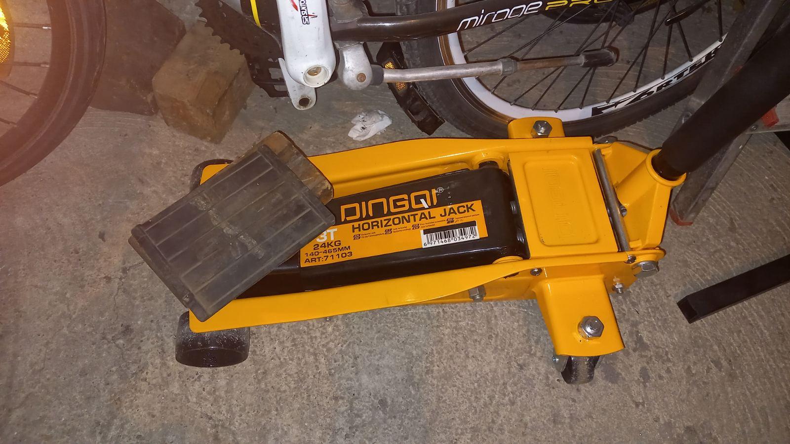

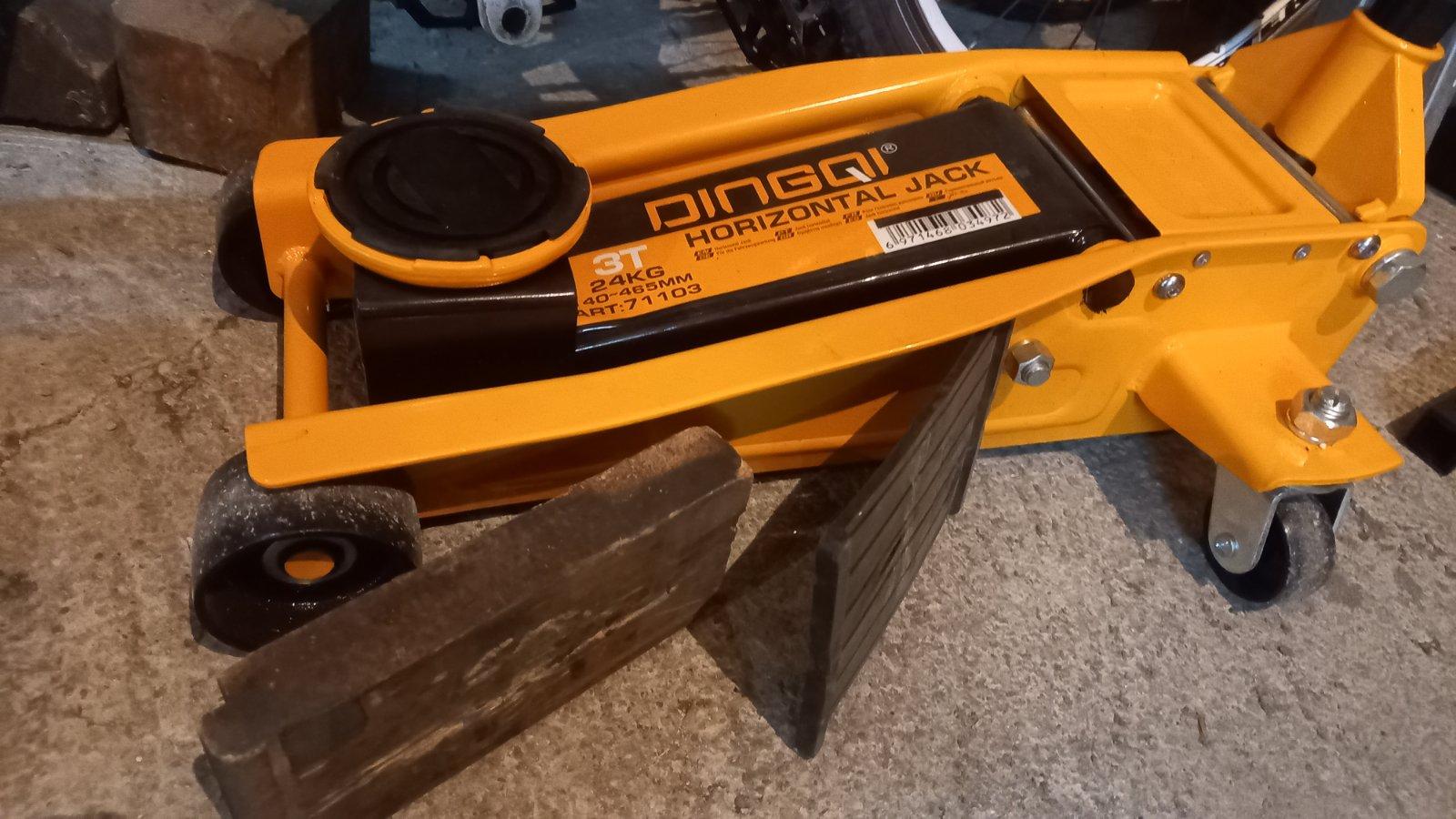

moron 4812 Posted March 21, 2021 (edited) Ja koristim ovo preko "stope" dizalice. Komad bukovine i gume preko nje. Ali i oslanjam samo na "grede" na podu. Edited March 21, 2021 by Ivan Skinut nepotreban citat, sredjene slike 1 Nebek reacted to this Quote Share this post Link to post Share on other sites
