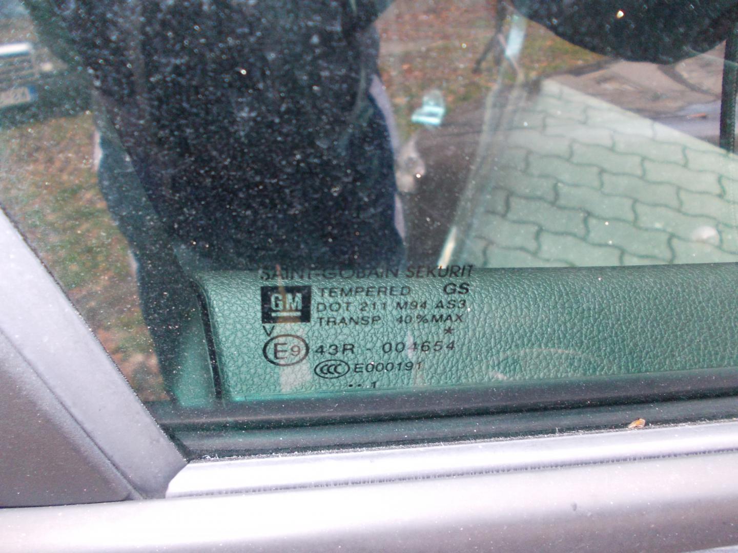

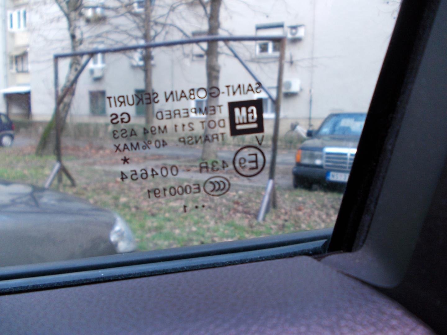

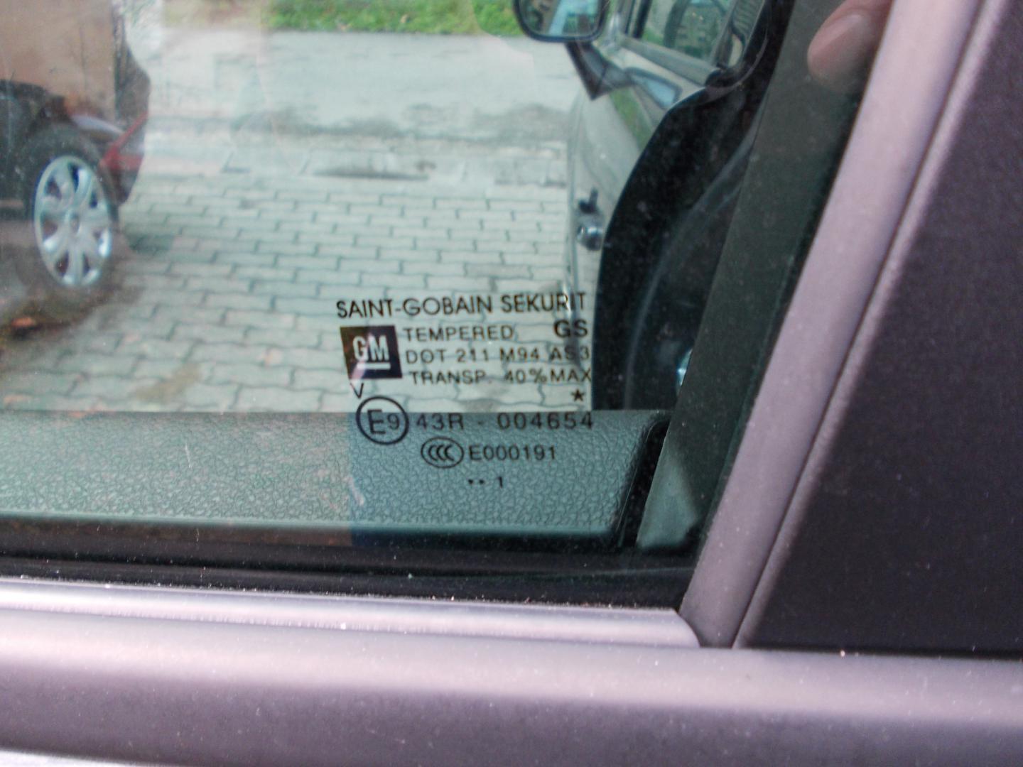

nstyner 190 Posted February 9, 2018 Kod mene na Meri su fabrički tonirana zadnja stakla. Nemam onu V oznaku što spominjete,ali ima ovako nešto Valjda su ih dovoljno edukovali o fabričkim staklima da ne krene šaban da mi čačka noktima da vidi da li je folija! Quote Share this post Link to post Share on other sites
Angell 11 Posted February 9, 2018 Ja ne znam kako nemas V, meni na slici izbode oci xD 1 3 totti, electronizer, igor0511 and 1 other reacted to this Quote Share this post Link to post Share on other sites
nstyner 190 Posted February 9, 2018 (edited) E je ala se sakrilo.... Sad ja ispao šaban! Ima svakakvih oznaka,nadam se da im je to dovoljno! Edited February 9, 2018 by nstyner Quote Share this post Link to post Share on other sites
igor0511 3434 Posted February 9, 2018 Itekako dovoljno. Meni konstantovase da su fabricka stakla momentalno, nisu dobro ni pogledali u prozore. Quote Share this post Link to post Share on other sites
Ivan 22205 Posted February 9, 2018 (edited) 55 minutes ago, nstyner said: Ima svakakvih oznaka,nadam se da im je to dovoljno! Pored oznake "V" imas i drugu oznaku koju sam negde pominjao - "TRANSP 40% MAX". Iliti maksimalna transparentnost (providnost, kako hoces) od 40%, tj. minimalno zatamnjenje od 60%. Edited February 9, 2018 by Ivan Quote Share this post Link to post Share on other sites
nstyner 190 Posted February 9, 2018 Tako je,nazad transp 40% max a napred transp 70% max.Meri po staklima sva u procentima ! Quote Share this post Link to post Share on other sites
Ivan 22205 Posted February 9, 2018 To ti je to, prednja zatamnjena tih maksimalno dozvoljenih 30% (kao sto je i kod nas propisano), iza B stuba 60%. Quote Share this post Link to post Share on other sites
