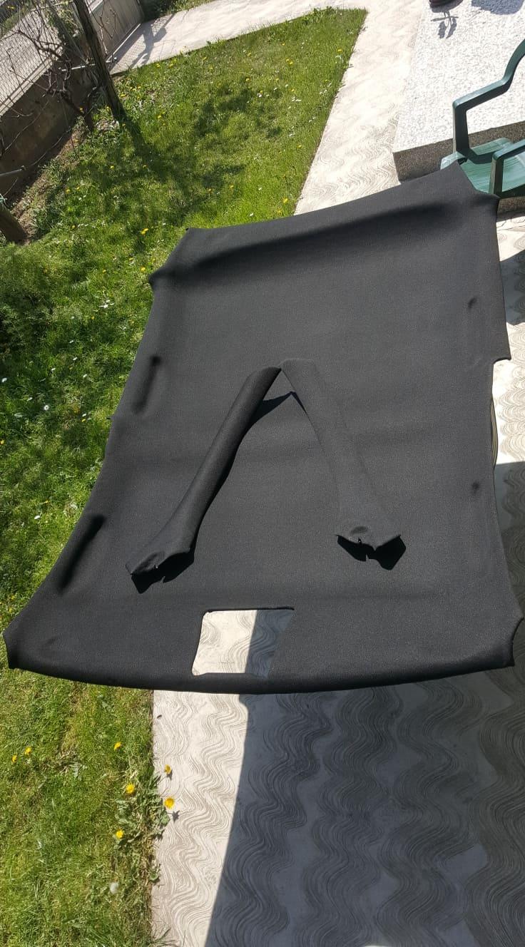

Stex3105 107 Posted April 11, 2020 Presvuceno nebo i stubovi 4 Milutinac, darkman14, PremieRacing and 1 other reacted to this Quote Share this post Link to post Share on other sites
ISV_01 4793 Posted April 11, 2020 Nemoj samo da ga ucrnis previse Odlican bravko. Quote Share this post Link to post Share on other sites

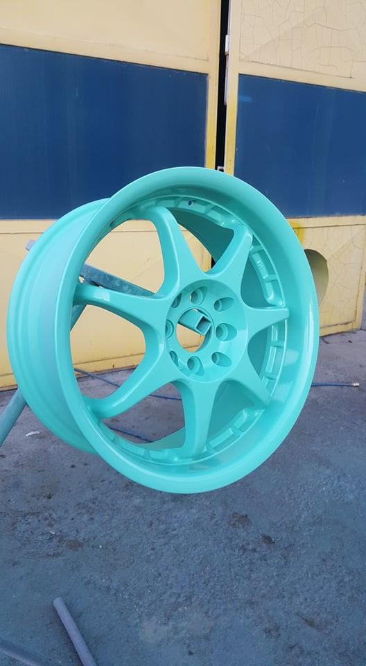

Stex3105 107 Posted May 27, 2020 5 Djuk85, neshaoct, PremieRacing and 2 others reacted to this Quote Share this post Link to post Share on other sites

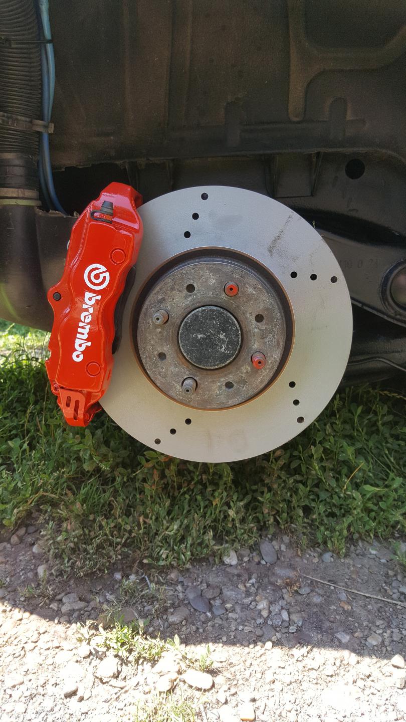

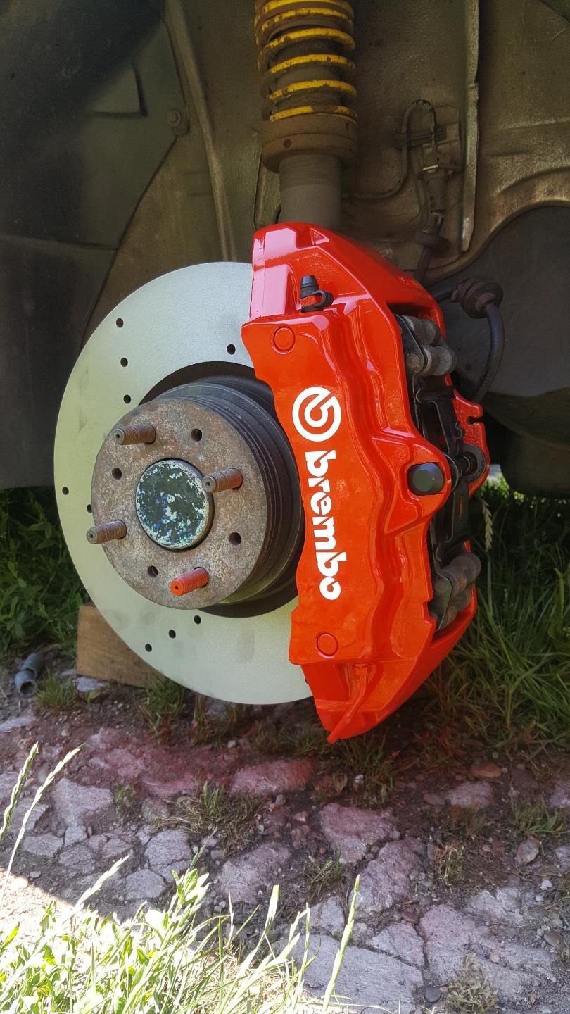

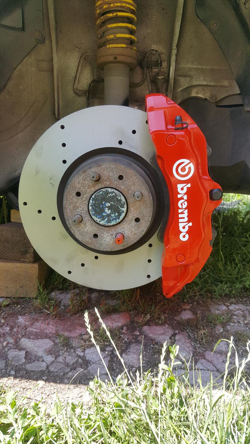

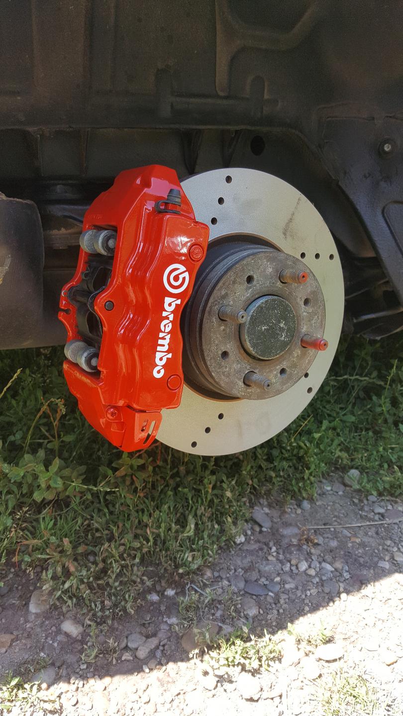

Stex3105 107 Posted June 30, 2020 Nesto novo Klesta od Tuarega 5.0 v10 prednja sestoklipna zadnja cetvoroklipna. Diskovi od alfe 166 prednji 310mm zadnji 280mm ventilirajuci. Koci odlicno. Ostalo mi jos da napravim elektricnu rucnu. 7 Milutinac, ISV_01, neshaoct and 4 others reacted to this Quote Share this post Link to post Share on other sites
MS PK 8302 Posted June 30, 2020 Sve si uradio da stane, samo jos da ga nesto pokrene, onako u skladu sa ovim 1 Milutinac reacted to this Quote Share this post Link to post Share on other sites
Stex3105 107 Posted June 30, 2020 (edited) Bice nekada neki nabrijani 1.4 t-jet ali ima vremena Edited July 4, 2020 by neshaoct formatiranje 1 Mijailović P. reacted to this Quote Share this post Link to post Share on other sites
MiloshShomy 114 Posted June 30, 2020 Treba obuzdati tu masinu, nego koje prepravke si odradio da ukopis sve? Quote Share this post Link to post Share on other sites
Stex3105 107 Posted June 30, 2020 (edited) Samo ploca izmedju fabrickog nosaca i klesta ovih. Ima malo zajebancije dok se sve mere uhvate ali nista strasno. I ostao je fabricki glavni kocioni mislim da je 22.2mm velicine i peti kocioni pozadi koji fabricki nije zakacen za balans stanglu verovatno je samo razdelnik biiip li ga nisam mu shvatio svrhu. Edited July 4, 2020 by neshaoct formatiranje Quote Share this post Link to post Share on other sites
miljanxXx 26 Posted July 1, 2020 A stare zadnje diskove i klesta od hgt prodajes? Quote Share this post Link to post Share on other sites
Stex3105 107 Posted July 2, 2020 (edited) Nisu na prodaju brate Edited July 4, 2020 by neshaoct formatiranje Quote Share this post Link to post Share on other sites
