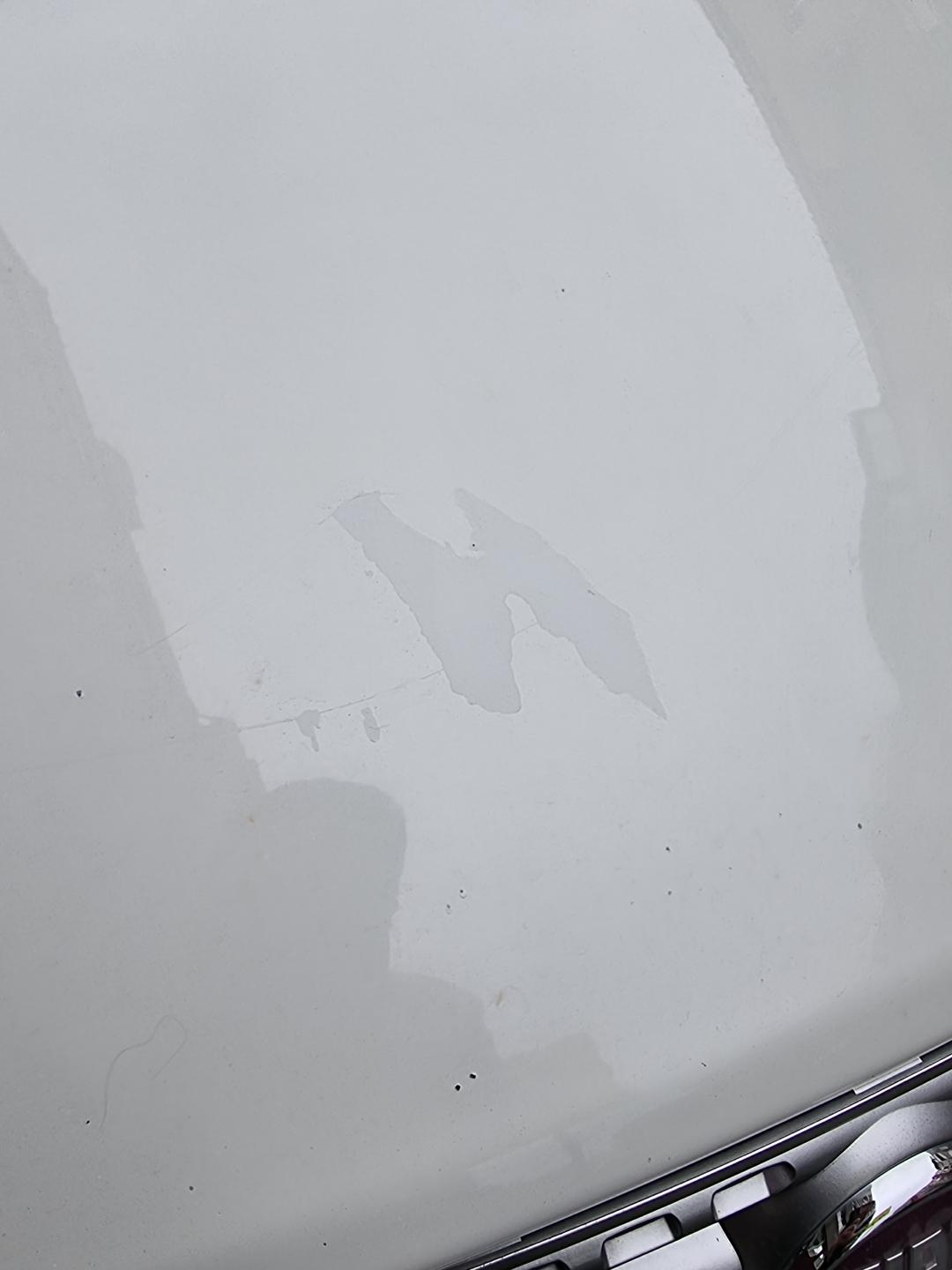

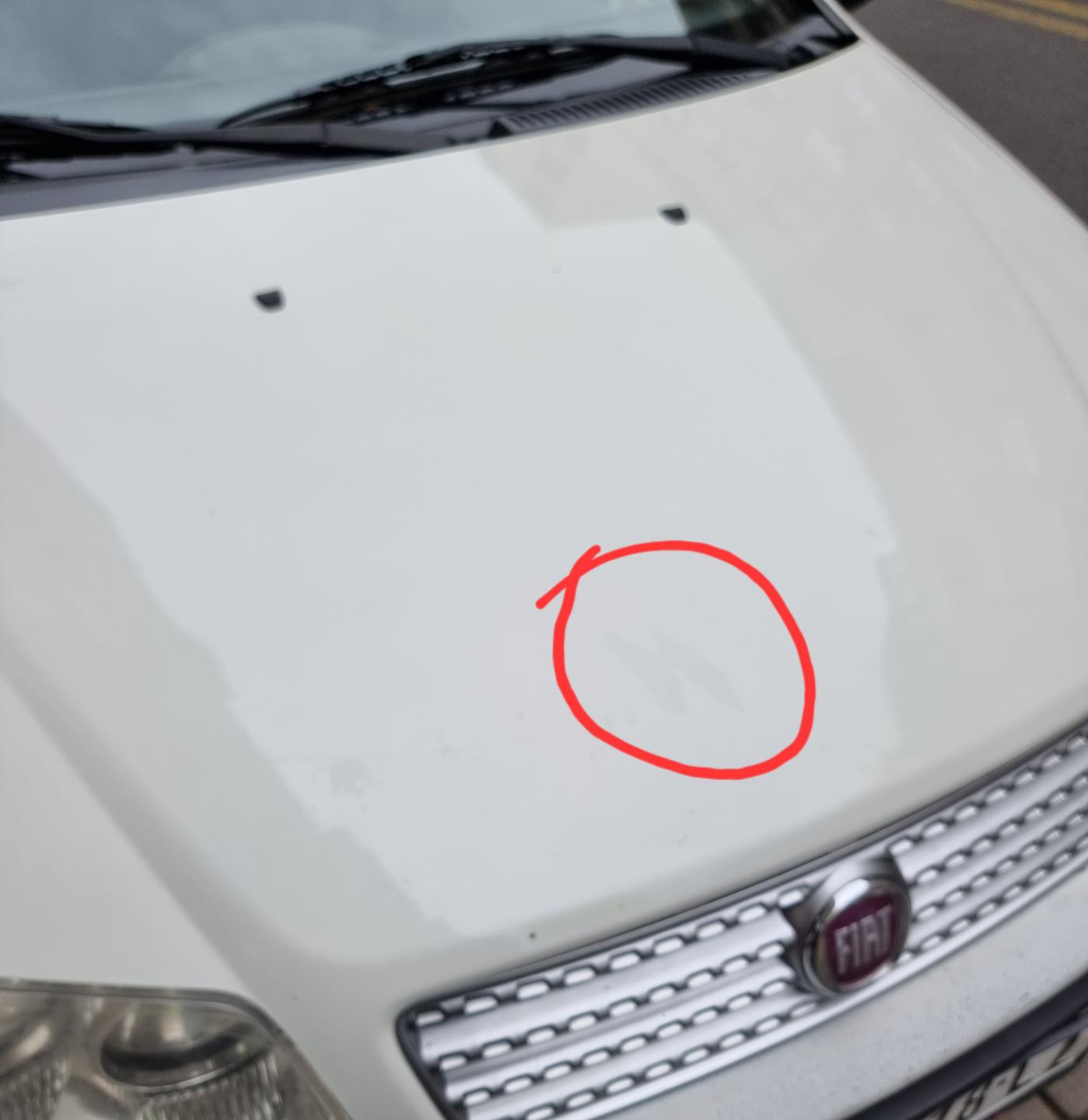

snebojsa 57 Posted July 20, 2023 (edited) Pretpostavljam da je jedino pravo resenje kada lak pocne da se ljusti - farbanje? Pocelo je na par mesta na haubi, gepek vrata... Edited July 20, 2023 by snebojsa Quote Share this post Link to post Share on other sites
