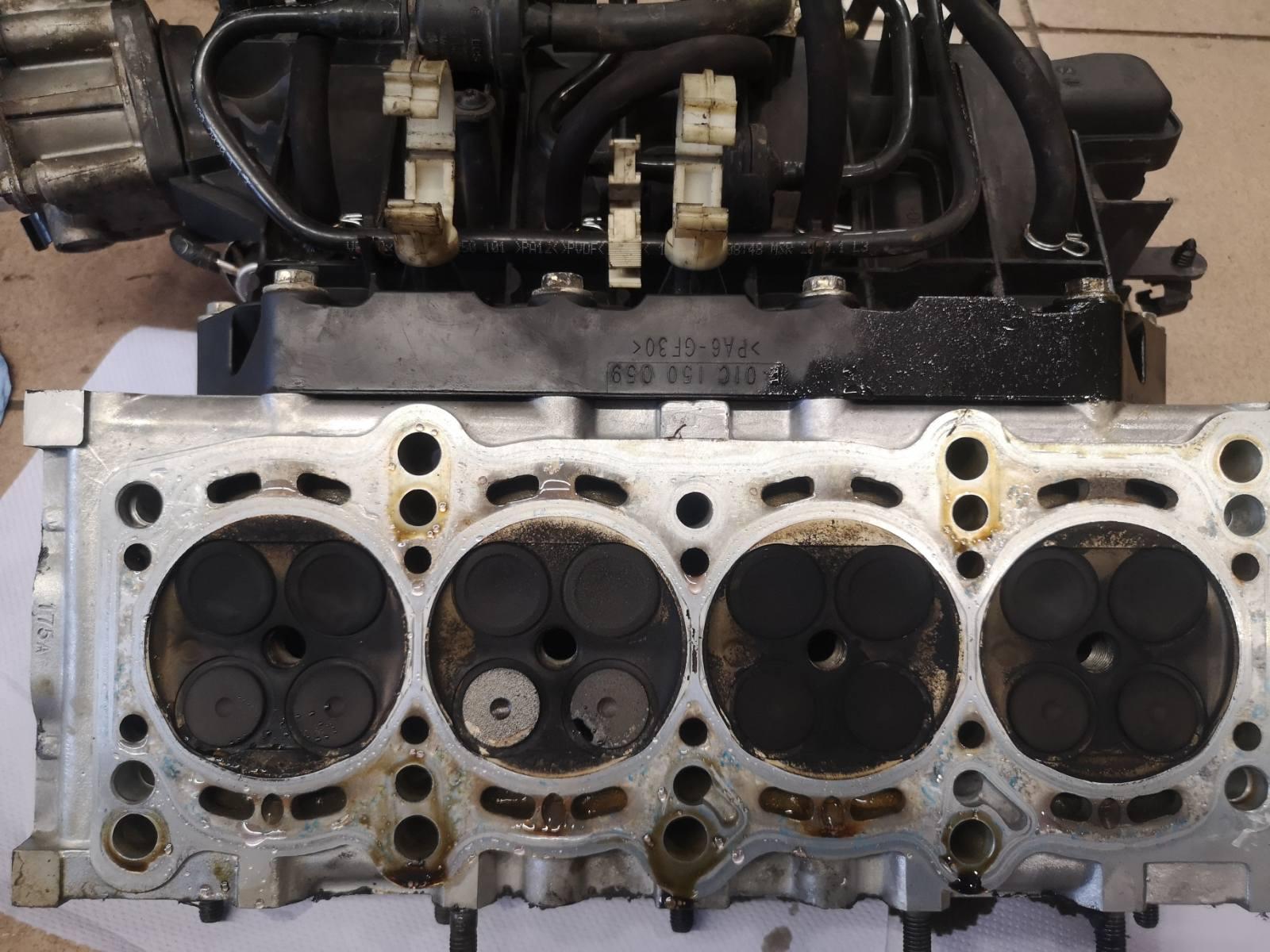

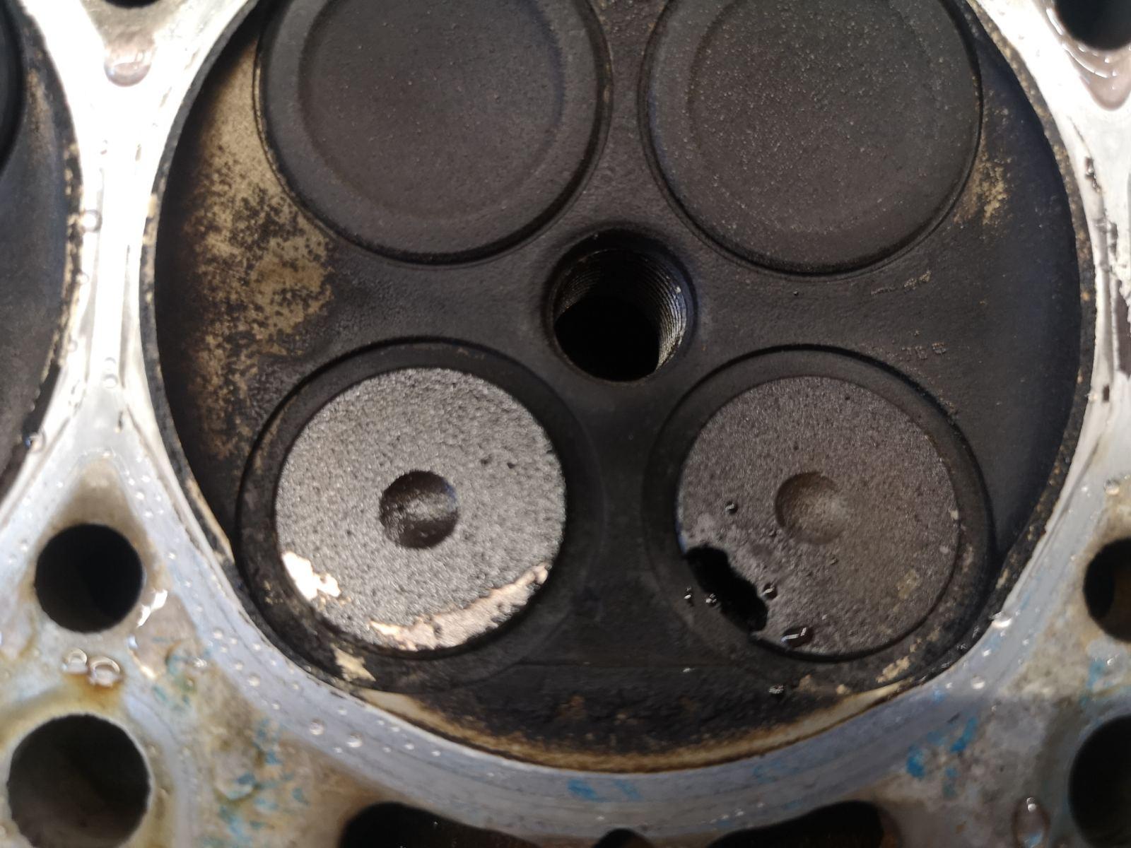

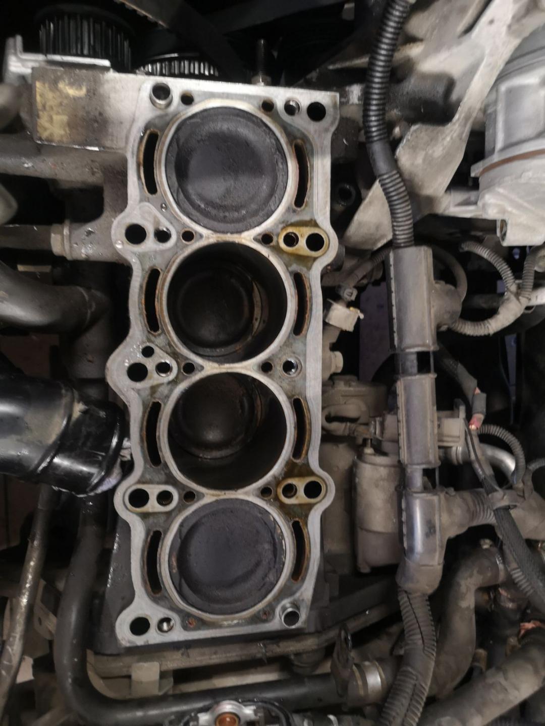

srdjan_as 16 Posted April 27, 2022 Evo covek me zvao da mi objasni sta je problem i poslao mi je slike. Pa reko da podelim sa vama 1 neshaoct reacted to this Quote Share this post Link to post Share on other sites
Markoni Bg 74 Posted April 27, 2022 Pukao ventil , ne dihtuje cilindar , sad je jasno sto prijavljuje gresku , jel samo to stradalo, nadam se da ce se zavrsiti na tome. 2 dekirs and neshaoct reacted to this Quote Share this post Link to post Share on other sites
Mijailović P. 3737 Posted April 27, 2022 Jbg, ako su cilindri i klipovi dobri sve je to mala šteta koju ćeš brzo zaboraviti. 2 srdjan_as and darkman14 reacted to this Quote Share this post Link to post Share on other sites
vicent 1291 Posted April 27, 2022 Jbg. ne bih da mračim ali deo tog ventila je vrvt. izrisovao cilindar. Quote Share this post Link to post Share on other sites
Goran Zemun 488 Posted April 27, 2022 47 minutes ago, vicent said: Jbg. ne bih da mračim ali deo tog ventila je vrvt. izrisovao cilindar. Ventil nije pukao, vec izgoreo. Nema parceta, on se usled visoke temperature i pritiska topio i sitne cestice sa izduvnim gasovima izadju van cilindra. 4 2 Markoni Bg, srdjan_as, skile86 and 3 others reacted to this Quote Share this post Link to post Share on other sites
vicent 1291 Posted April 27, 2022 Tim bolje, odlično !Poslato sa JSN-L21 pomoću Tapatoka Quote Share this post Link to post Share on other sites
Mijailović P. 3737 Posted April 27, 2022 Znači loša plinska mapa/podešavanja istopila ventil. Quote Share this post Link to post Share on other sites
Goran Zemun 488 Posted April 27, 2022 5 minutes ago, Mijailović P. said: Znači loša plinska mapa/podešavanja istopila ventil. Moguce.. Quote Share this post Link to post Share on other sites
