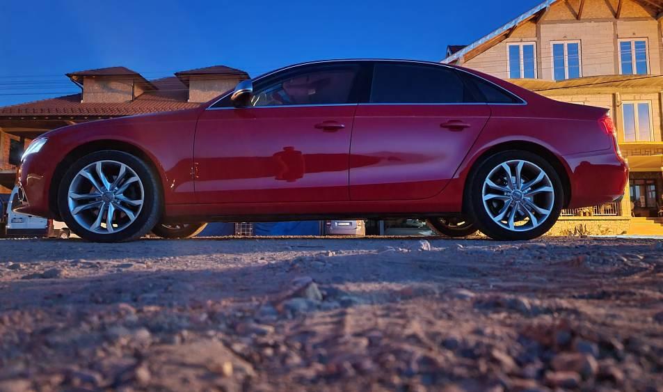

Flex 1884 Posted July 5, 2021 (edited) Jos uvek nije doslo do Dunava. Edited July 5, 2021 by neshaoct prebacio sliku na FLCS server 7 rkoma1986, bit, ISV_01 and 4 others reacted to this Quote Share this post Link to post Share on other sites
