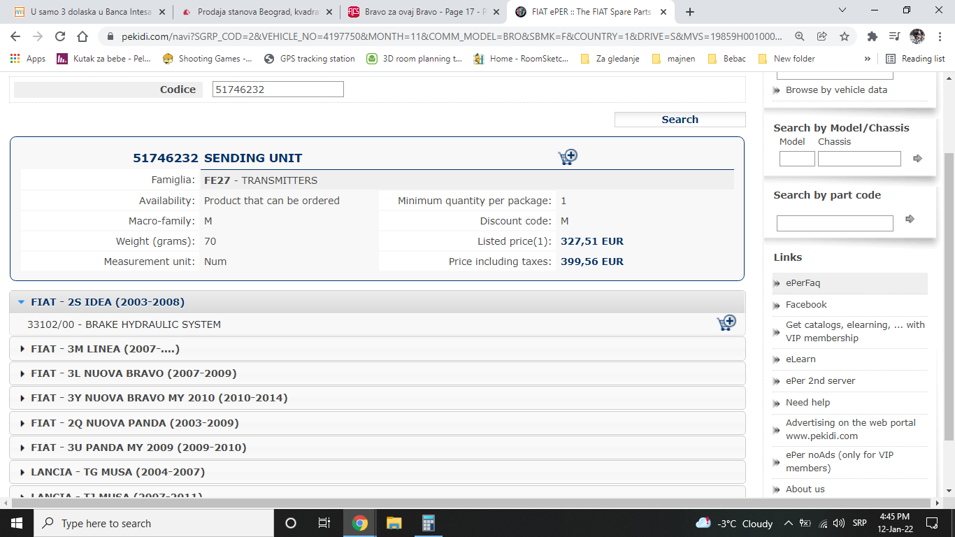

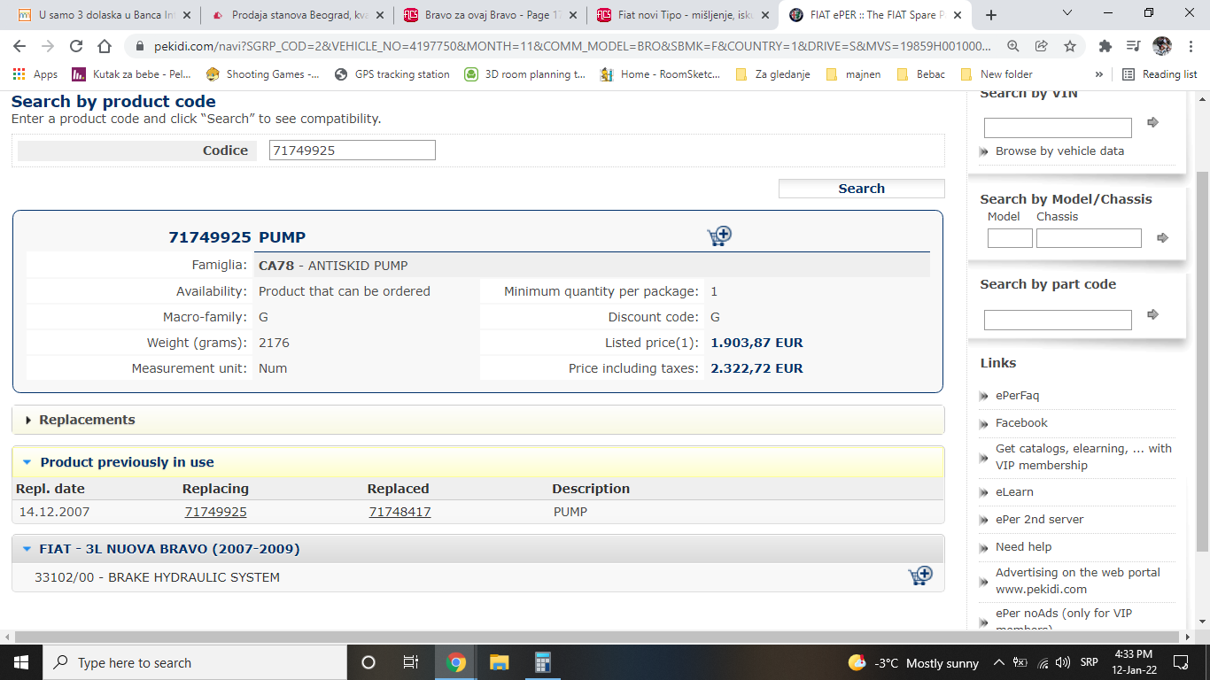

Branislav 748 Posted January 12, 2022 Bas sad listam Eper i koliko ja vidim pasu moduli abs sa bilo kog motora na Bravu. Evo br sasije pa mi pomozite ako gresim ZFA19800004202982 Quote Share this post Link to post Share on other sites
ISV_01 4796 Posted January 12, 2022 To je pumpa ? 1 Branislav reacted to this Quote Share this post Link to post Share on other sites
Branislav 748 Posted January 12, 2022 Da pumpa i centrala idu odvojeno ahahahhaha Quote Share this post Link to post Share on other sites
ISV_01 4796 Posted January 12, 2022 Pumpa ide verovatno sa bilo kog brava, nije definisano e-perom. To izgleda nije "zavisno" od motorizacije. A "transmitter" je pretpostavljam centrala ? 1 Branislav reacted to this Quote Share this post Link to post Share on other sites
Branislav 748 Posted January 12, 2022 Ne ne ovo je centrala pod brojem 71751084 pise electronic control unit Quote Share this post Link to post Share on other sites
ISV_01 4796 Posted January 12, 2022 Tja, šta je to, 3-3,5cca ojra. Kud 600 tu i 3500 Da, izgleda da je isto, samo razlika u oznaci restyle i pre-restyle-a, vidim u obe varijante da podržava istu motorizaciju 1,4 turbo. Evo link da se ne kuca bzvze i traži: to E-per Quote Share this post Link to post Share on other sites
