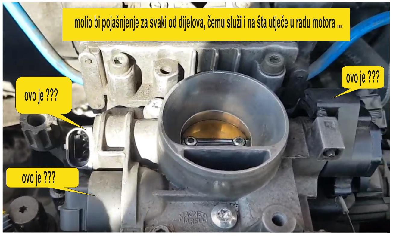

zico.radionica@gmail.com 1 Posted May 9, 2019 (edited) Molim vas da mi pojasnite ove senzore ili šta već jesu na klapni gasa ... Punto 1.2 8v 2002. godina ... Edited May 9, 2019 by neshaoct spojeno 1 neshtry reacted to this Quote Share this post Link to post Share on other sites
neshaoct 5378 Posted May 9, 2019 @zico.radionica@gmail.com Pogledaj sada, nakon spajanja tema, sve ranije napisano u temi na kojoj smo. Plus, baci pogled i ovde: https://www.fiat-lancia.org.rs/forum/index.php?/topic/44458-čišćenje-leptira-klapne-gasa/ Quote Share this post Link to post Share on other sites
