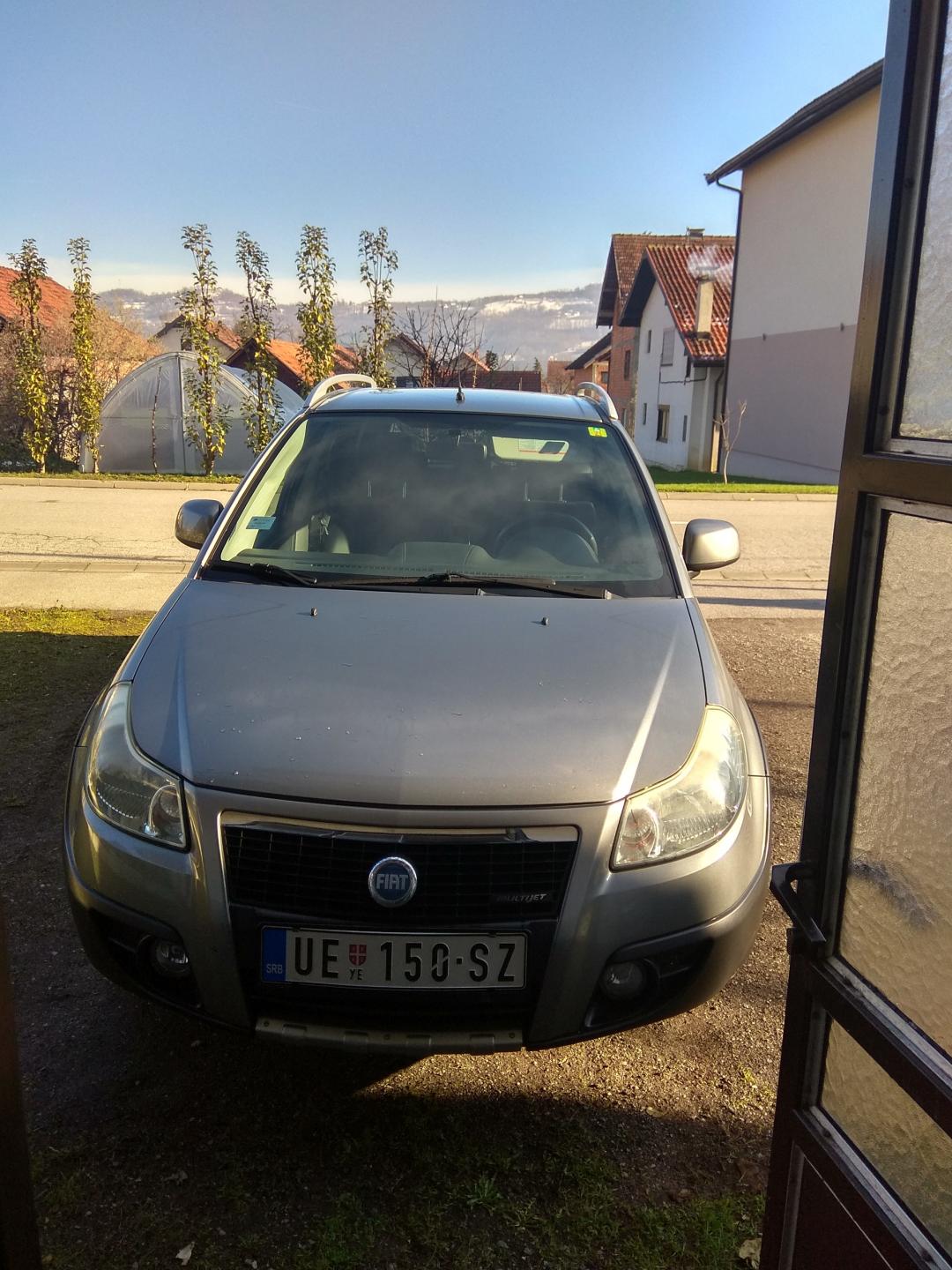

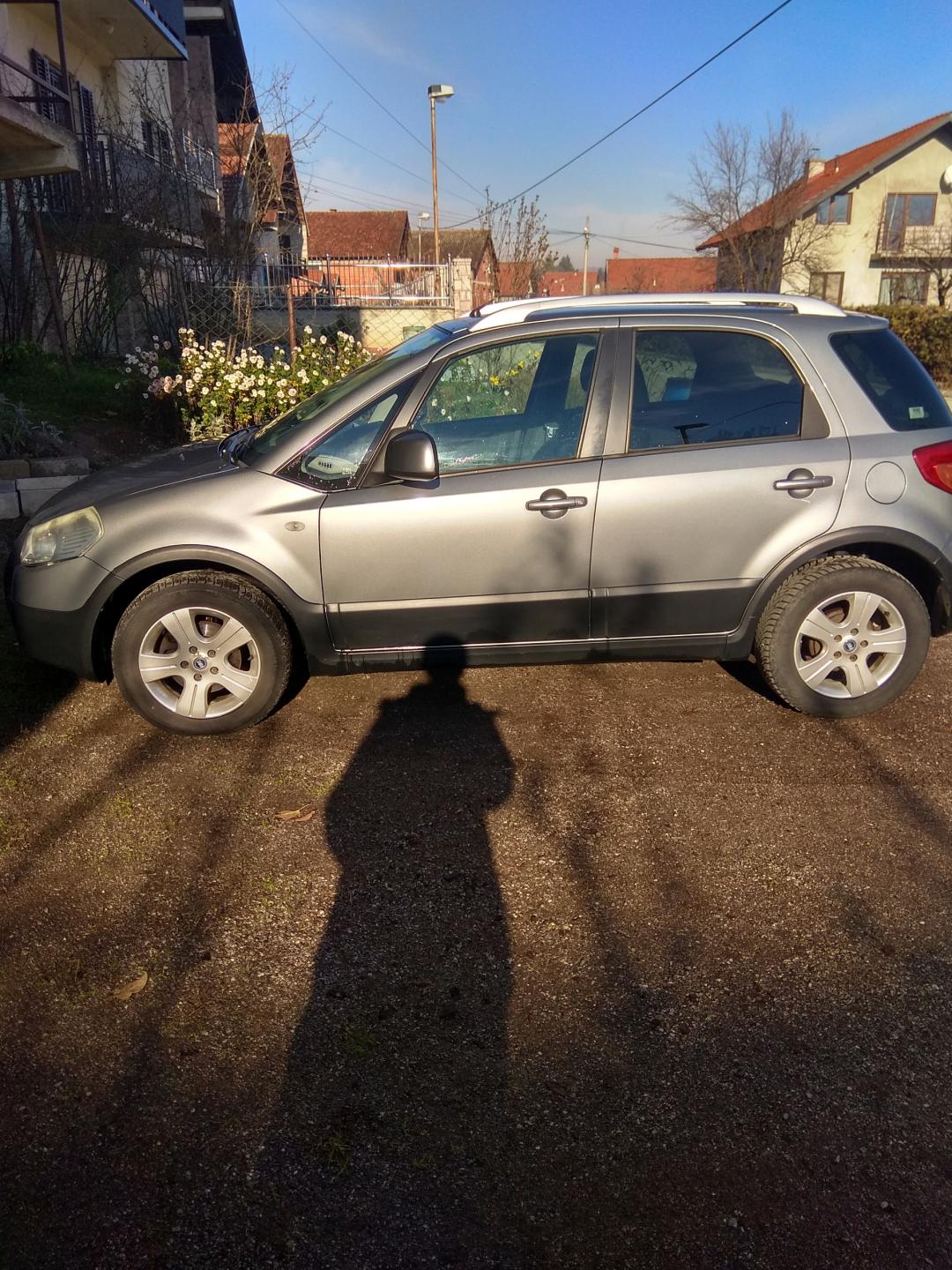

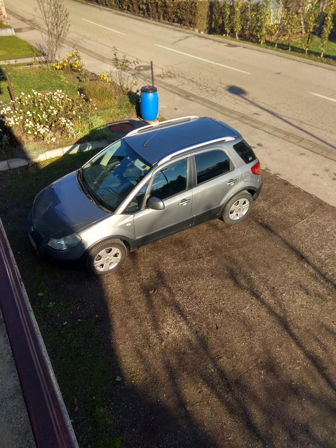

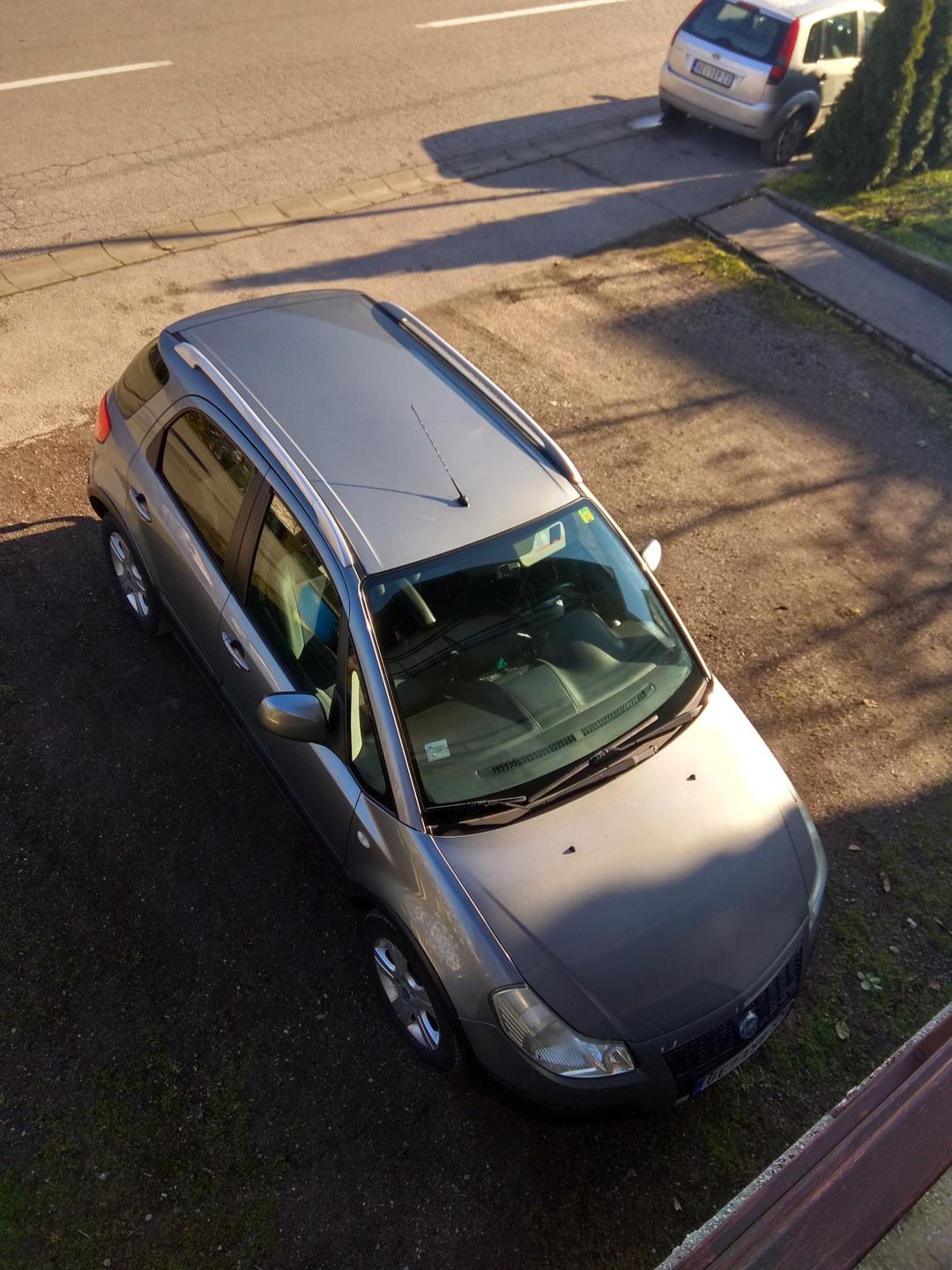

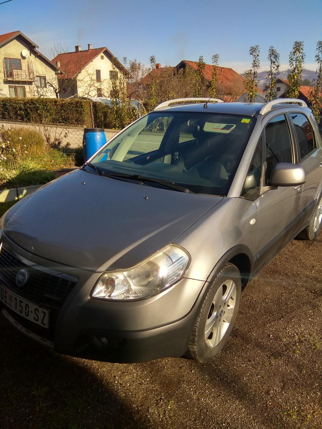

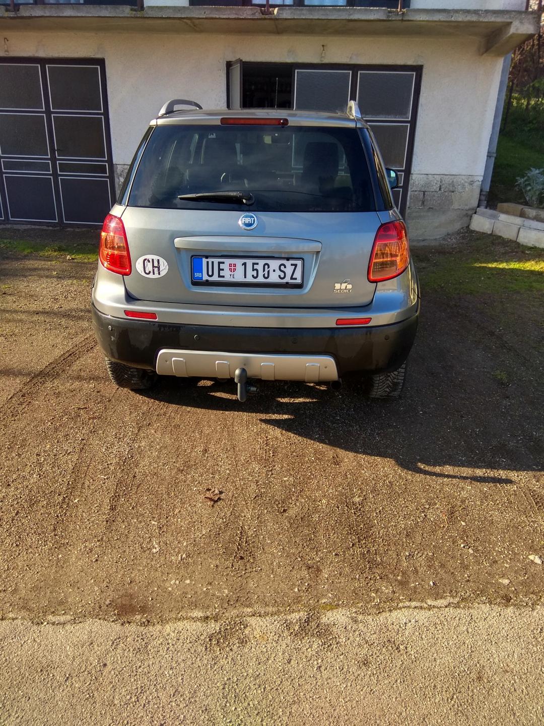

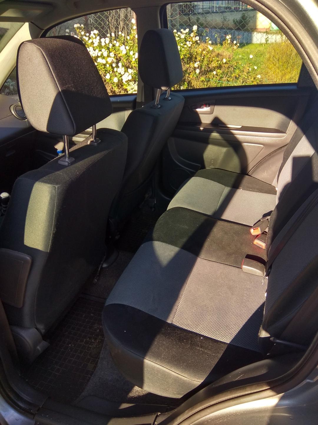

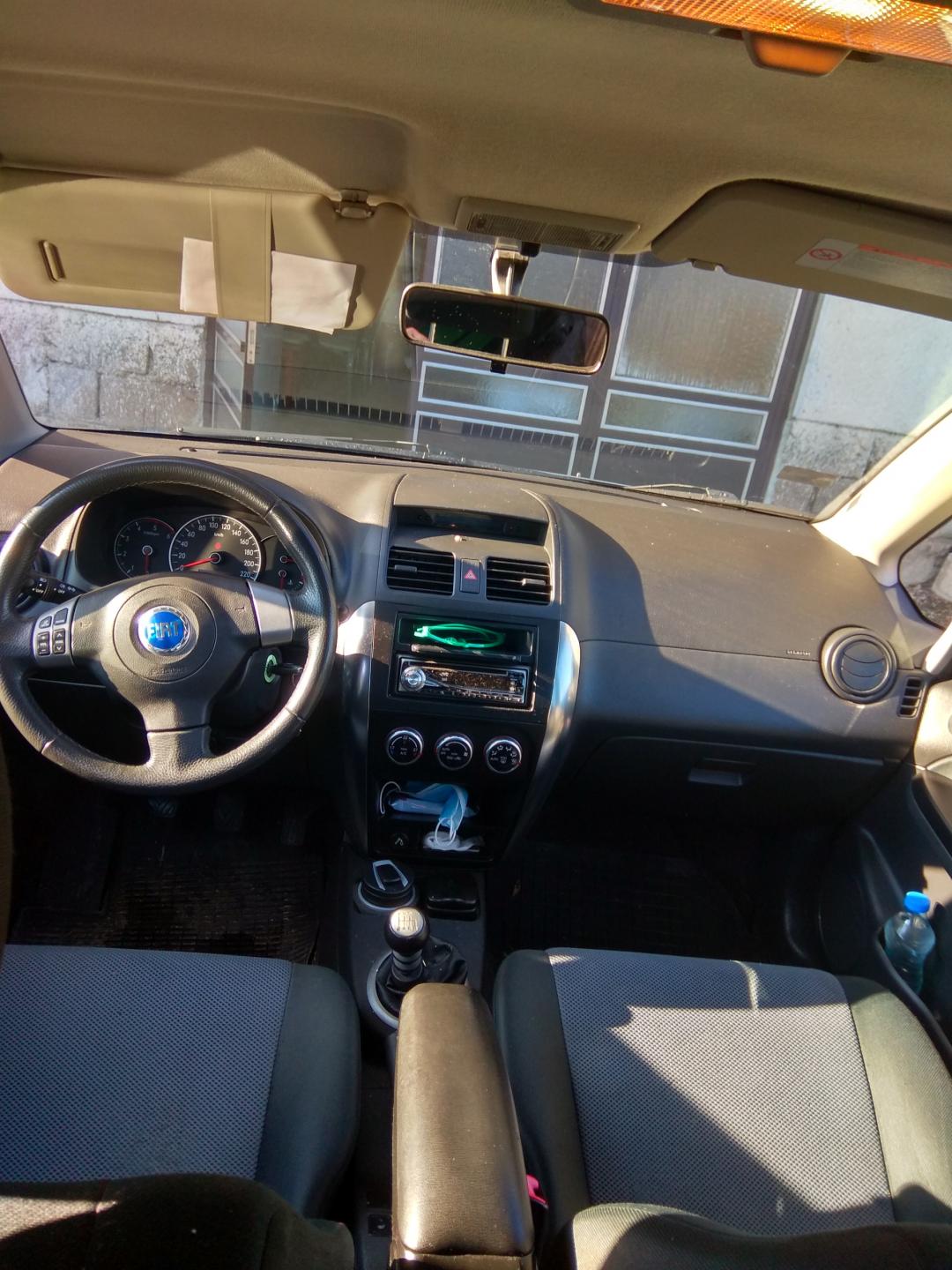

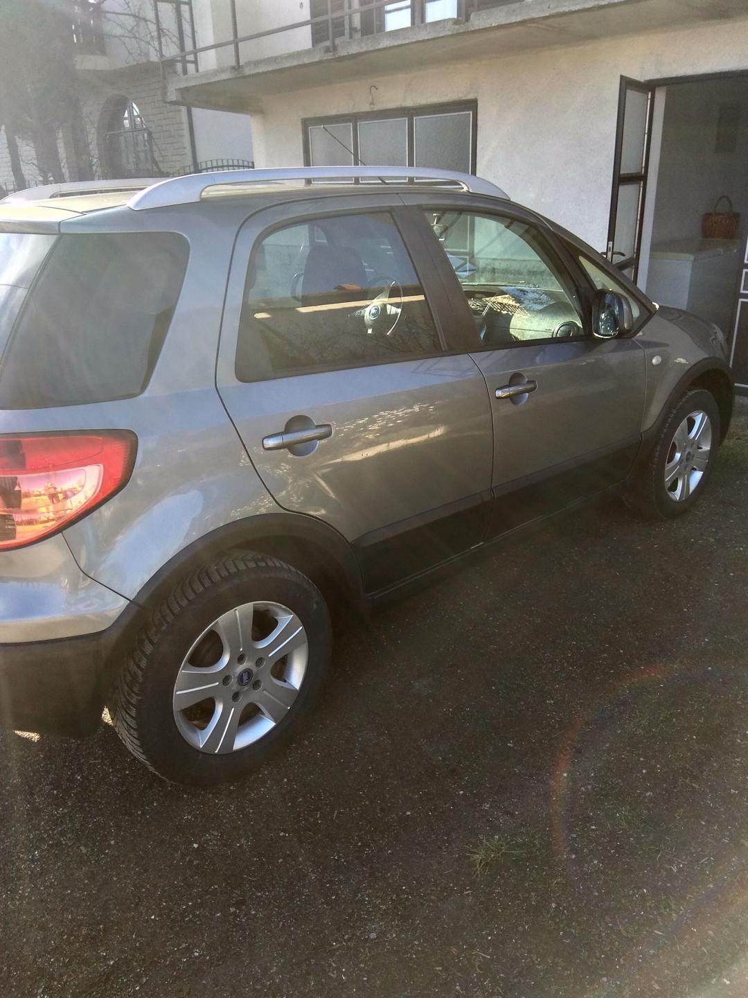

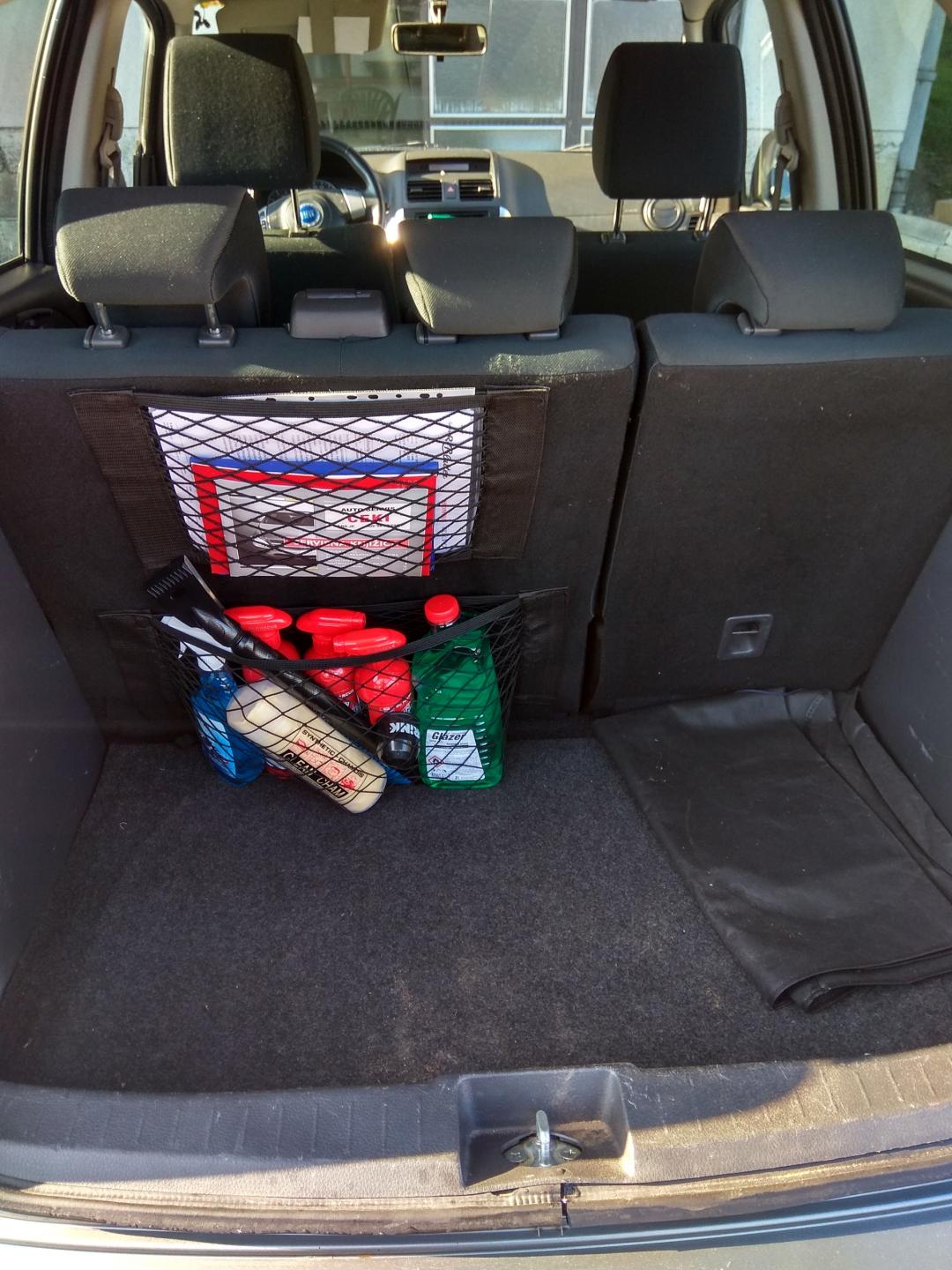

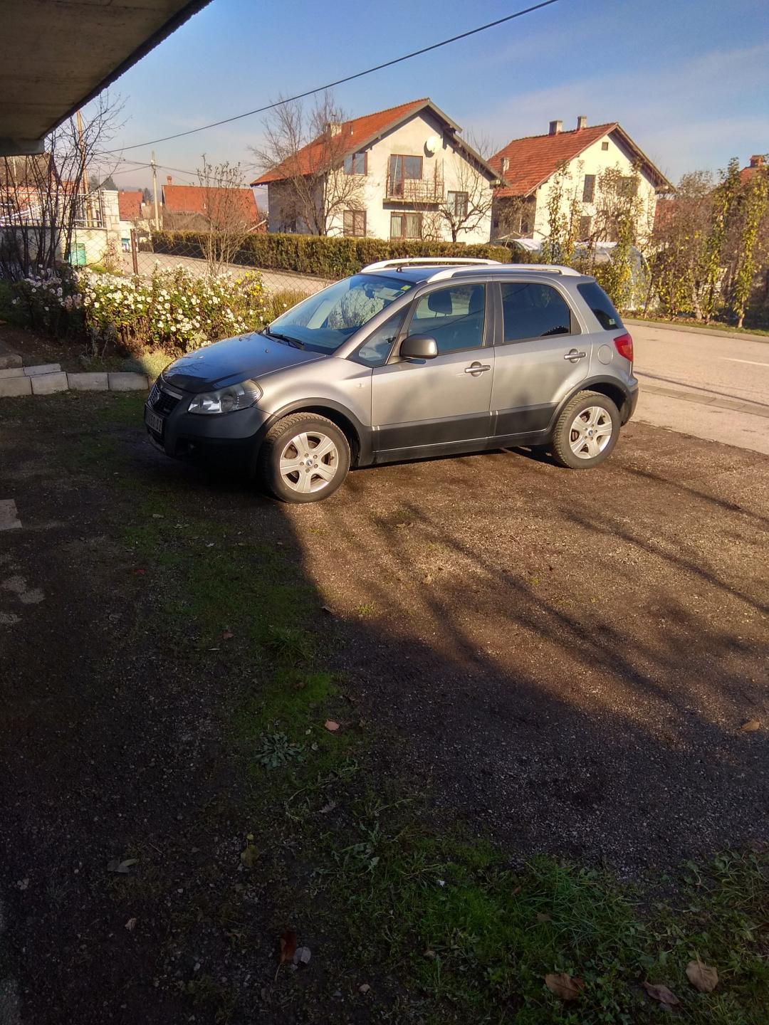

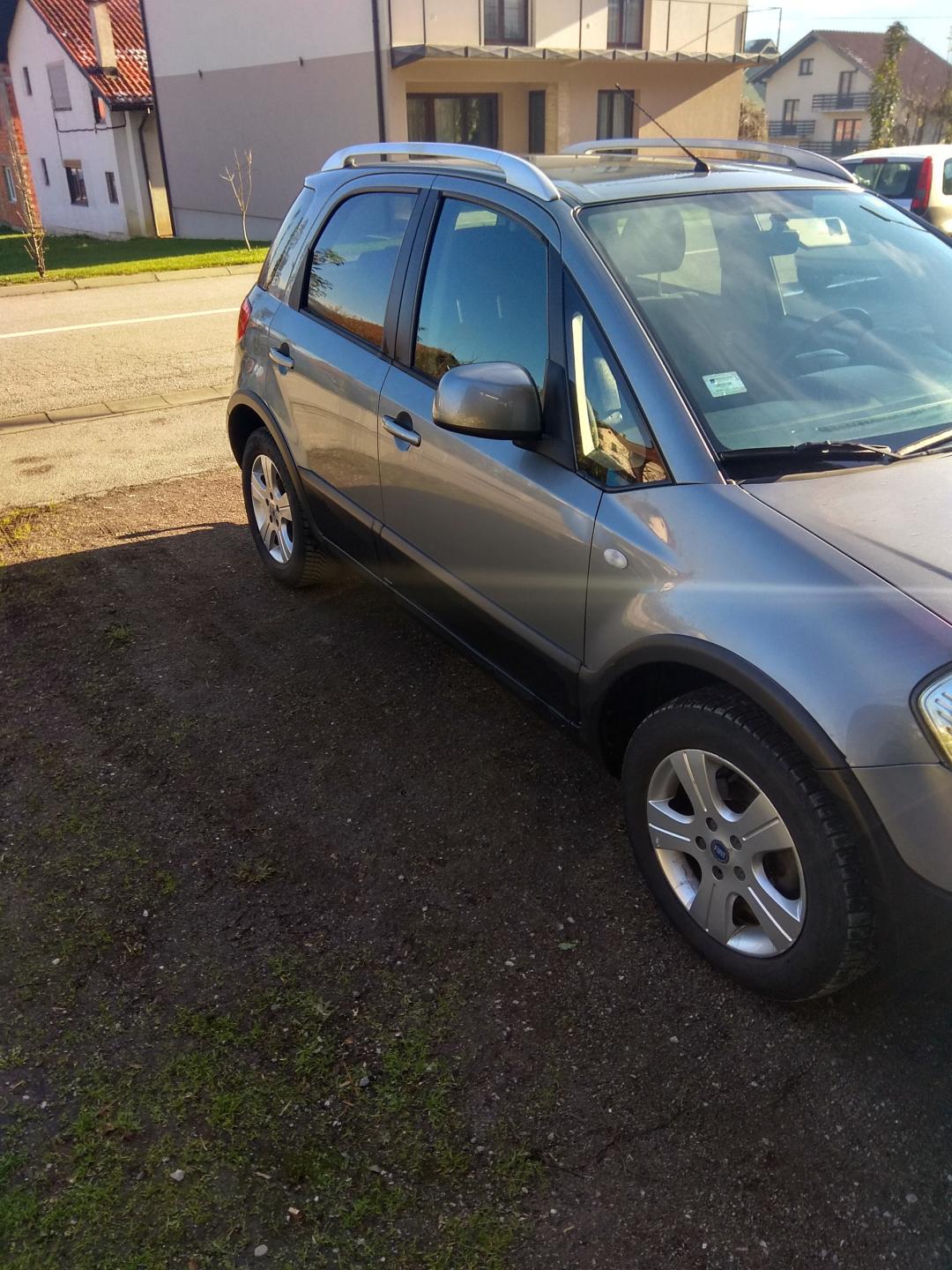

Che Guevara 140 Posted December 2, 2021 (edited) On 10/24/2021 at 1:34 PM, MS PK said: Nije dosta, fale slike On 10/24/2021 at 2:26 PM, neshtry said: Slike! Edited December 2, 2021 by Ivan Sredjen format, slike i citati 5 Reacher Gilt, ISV_01, Dale and 2 others reacted to this Quote Share this post Link to post Share on other sites
Dale 7577 Posted December 2, 2021 Al' ste navalili, morao covek da opere auto zbog vas koji trazite slike... Lep Sedici sto mu onda dodje Krasnici! 1 Che Guevara reacted to this Quote Share this post Link to post Share on other sites
Che Guevara 140 Posted December 3, 2021 Posle vise od mesec dana... imao sam povredu, pa je to odložilo slikanje Quote Share this post Link to post Share on other sites
