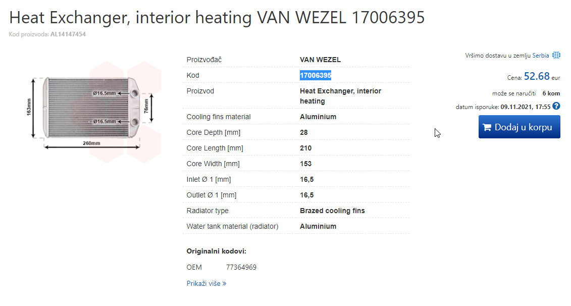

Milutinac 5906 Posted October 27, 2021 (edited) ITN - made in PRC NRF - Nederland Edited October 27, 2021 by Milutinac 1 PremieRacing reacted to this Quote Share this post Link to post Share on other sites
Punto Abarth 18 Posted October 27, 2021 Ne bih da pametujem, ali to je hladnjak klime, a ne mali hladnjak kabine. hladnjak klime ide odmah tu kod velikog hladnjaka rashladne tecnosti motora, a mali hladnjak kabine ide - u kabinu iza table 1 moron reacted to this Quote Share this post Link to post Share on other sites

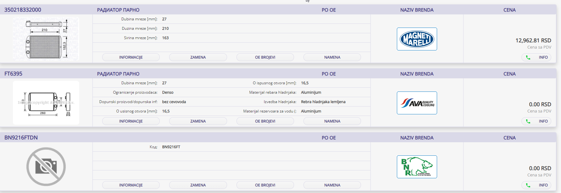

darkman14 5900 Posted October 27, 2021 Verovatno si u pravu. Meni sto eper nudi su ove 2 slike za ventilation and heating Quote Share this post Link to post Share on other sites

darkman14 5900 Posted October 27, 2021 @vagenovac https://e-shop.euro07.net/#/eurob2b/ArtSearch napravis nalog i imas pristup njiohovom online katalogu. Meni je dobar da vidim cenu okvirno i da li ima kod nas na trzistu, kakva je ponuda... Pa tek onda zovem dalje prodavnice kad se odlucim. 1 vagenovac reacted to this Quote Share this post Link to post Share on other sites
Punto Abarth 18 Posted October 27, 2021 Euroauto, Denso, 6000 din pa kad dodje krece zabava vadjenja table… Quote Share this post Link to post Share on other sites
darkman14 5900 Posted October 27, 2021 @Punto Abarth nadjoh, na ovo mislis? OE broj 17006395 Quote Share this post Link to post Share on other sites
