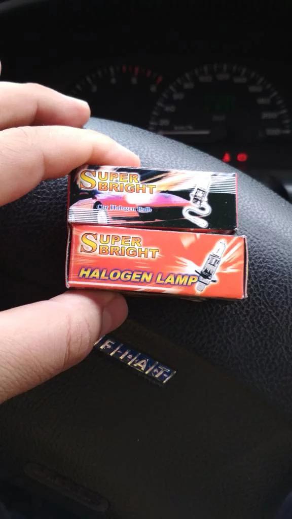

Djuk85 3064 Posted June 22, 2018 Riknulo mi oboreno svetlo... Valjda ce zadovoljiti moje potrebe Ipak su SUPER bright Quote Share this post Link to post Share on other sites

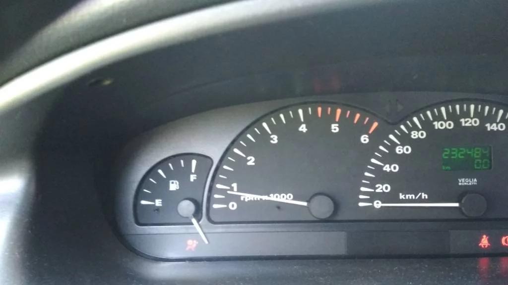

Djuk85 3064 Posted July 21, 2018 Manje goriva od ovoga izgleda da ne može 2 1 Martin, knezevic76 and bit reacted to this Quote Share this post Link to post Share on other sites
djomla 8458 Posted July 21, 2018 Manje ili više? Quote Share this post Link to post Share on other sites
Djuk85 3064 Posted July 21, 2018 Ma velika mi rezerva izgleda Quote Share this post Link to post Share on other sites
Martin 827 Posted July 22, 2018 Otkačila se kazaljka? Quote Share this post Link to post Share on other sites
Djuk85 3064 Posted July 22, 2018 Ma to se desi po nekad kad otkacim klemu...pojacavao sam malo masu na autu da vidim nesto...Problem se resava udarom po tabli odozgo, jacom rukom 1 Martin reacted to this Quote Share this post Link to post Share on other sites
darkman14 6626 Posted July 22, 2018 3 hours ago, Djuk85 said: Problem se resava udarom po tabli odozgo Ili rastavljanjem table i čišćenjem ona 3 pina što kontrolišu motorić kazaljke. Oksidiraju vremenom. Samo ih prešmirglaš malo 2 Djuk85 and Martin reacted to this Quote Share this post Link to post Share on other sites
Djuk85 3064 Posted July 23, 2018 Videcemo, nesto sam zagledao, vidim tri srafica sa gornje strane pa ne verujem da se tesko skida Inace, palio mi lampicu abs-a i rucnu, pojacao sam i ocistio malo masu i za sad ne pali nista...valjda ce tako i ostati... Quote Share this post Link to post Share on other sites
