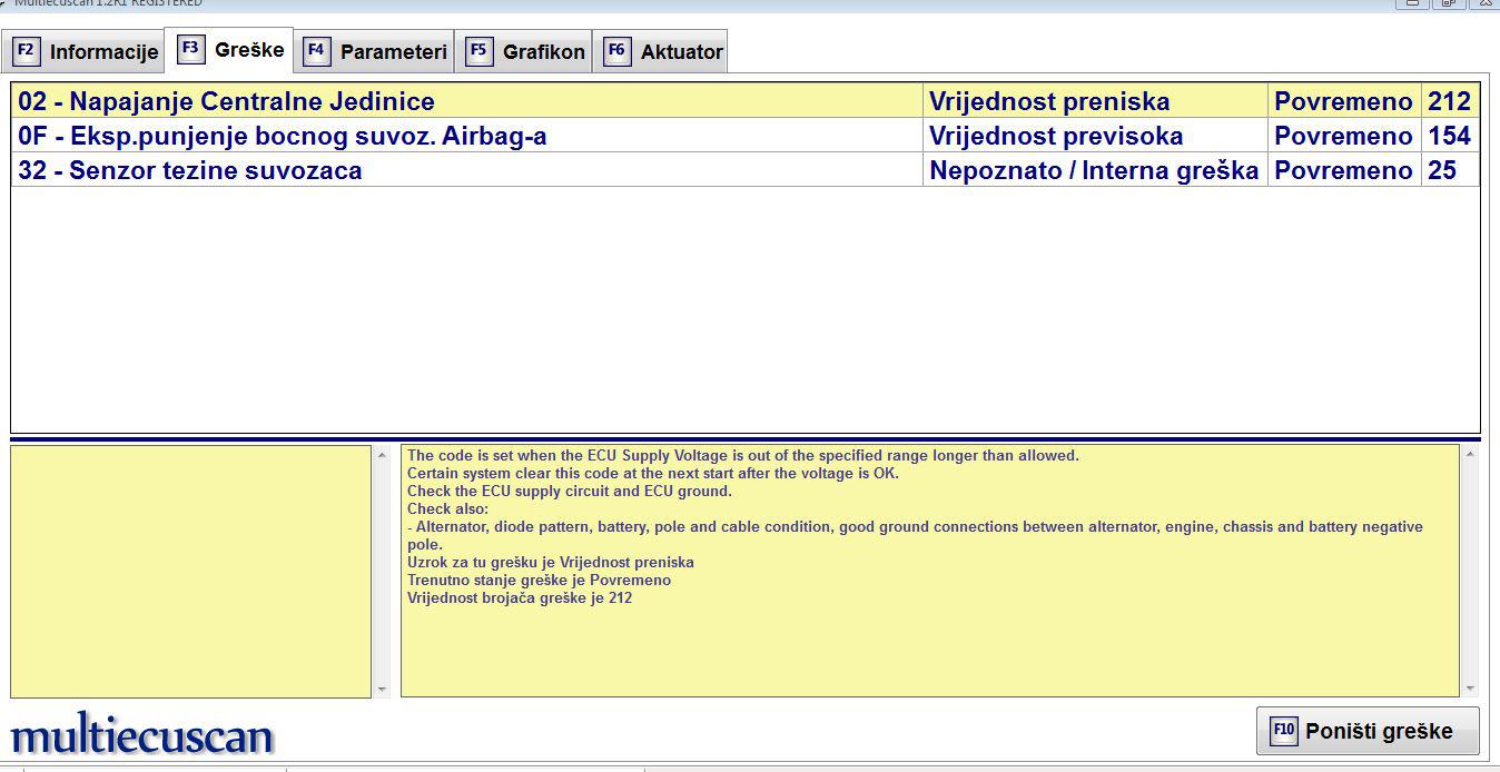

dussannn 1 Posted August 9, 2017 (edited) Uradio sam dijagnostiku sa klm-om. Dali neko zna šta je problem? Ja tipujem na osc senzor. Planiram da ugradim simulator sa zauzetim sedištem-Puki. Edited August 9, 2017 by dussannn Quote Share this post Link to post Share on other sites
