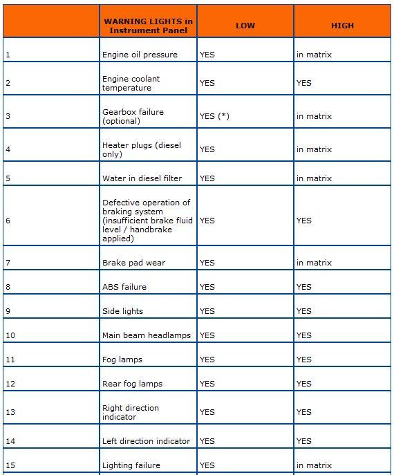

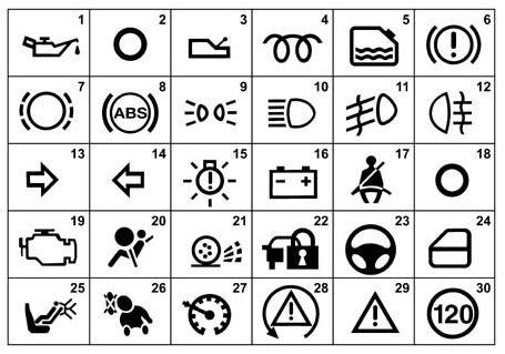

integralac 2894 Posted March 9, 2012 (edited) evo ako nekom zaskripi kontam da mogu da pomognu i vozacima ostalih modela fiat lancia s obzirom da je to ili isto ili slicno Edited October 16, 2021 by neshaoct prebacio slike na FLCS server Quote Share this post Link to post Share on other sites

cileee 1 Posted January 13, 2014 (edited) Moze li mi reci neko cemu sluzi ova lampica? Kad dam kontakt i onda se pali, a zivo me interesuje za sta je. Edited January 15, 2014 by neshaoct spojeno Quote Share this post Link to post Share on other sites
cileee 1 Posted January 13, 2014 Ne znam stvarno, ASR je ovo iznad njega uokvireno trouglom. Quote Share this post Link to post Share on other sites
Punto1.2 26 Posted January 13, 2014 Mislim da signalizira neispravnost ESP-a ali nisam siguran Quote Share this post Link to post Share on other sites
cileee 1 Posted January 13, 2014 Nikad mi se nije upalila, a kad sam imao problem sa STOP svetlom palio mi je gore navednu lampicu (ova u sto je uokvirena trouglom iznad svetla za maglu) i ispisivao ASR/ESP FAULE zato me ta buni.Nasao sam. Signalna lampica za ABS. Quote Share this post Link to post Share on other sites
Ivan 25671 Posted January 14, 2014 Tek sad videh temu. Isto je i na Citroenu (znas da su ga radili sa PSA grupacijom).Kod mene na Xsari je ta lampica za ABS, kao sto si rekao. Ova druga u trouglu je ESP/ASR. Quote Share this post Link to post Share on other sites
Kejd 1 Posted January 14, 2014 Deginitivno je ABS mada nisam ranije vidjao takvu lampicu... Quote Share this post Link to post Share on other sites
cileee 1 Posted January 14, 2014 Ni ja, i ja sam mislio da je za ESP i nisam ni obracao paznju, pa koliko puta sam ulecivao u krivine po 90° i tacno osetiim kako me prati zadnji deo samo zbog njega i ni jedna se lampica ne ukljuci, a kada ga pootpisujem pali mi ovu gore za ASR.Znao sam. Pa to su identicni modeli, Lanca, Citroen i Pezo. Quote Share this post Link to post Share on other sites
Vojvoda_Momcilo 0 Posted January 14, 2014 Pali se kada se pokvari abs. Quote Share this post Link to post Share on other sites
cileee 1 Posted January 14, 2014 Pa to sam slucajno nasao na netu, jer u knjizi je ((ABS)) lampica, takav je simbol pa me je zbunila malo. Quote Share this post Link to post Share on other sites
neshaoct 9780 Posted January 15, 2014 Nisi morao da tražiš po celom Net-u, evo teme (sada je tvoja spojena ovde) gde je već postavljeno... Quote Share this post Link to post Share on other sites
