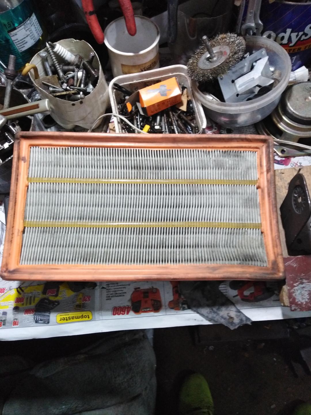

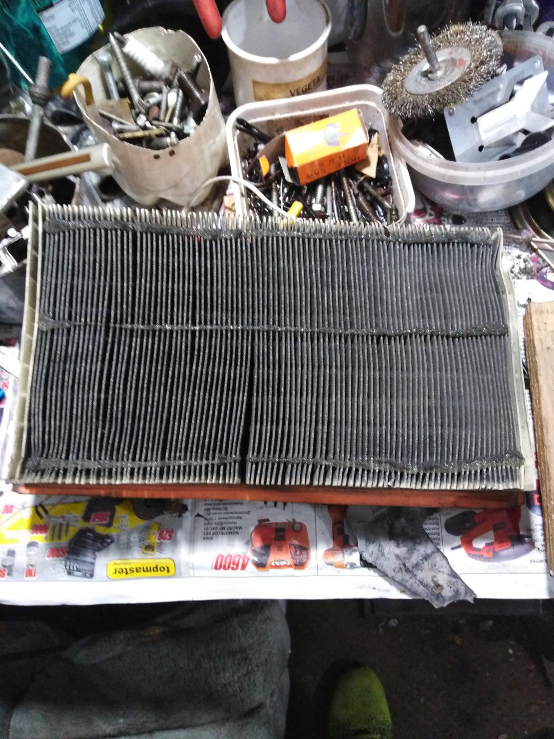

Djosua 0 Posted July 5, 2019 (edited) Jel moguce da ovo je razlog da mi auto ne vuce kako treba Edited August 28, 2021 by neshaoct update Quote Share this post Link to post Share on other sites
neshaoct 9740 Posted July 5, 2019 @Djosua Šta znači ''slabo vuče''? Koliko je to ''slabo'', daj malo detaljnije šta se dešava, sa kojih obrtaja... Quote Share this post Link to post Share on other sites
Djuk85 3064 Posted July 5, 2019 Najbolji odgovor bi bio zamena filtera pa probati auto nakon zamene. Bar njemu nije previsoka cena... 1 neshaoct reacted to this Quote Share this post Link to post Share on other sites
Djosua 0 Posted July 5, 2019 Just now, neshaoct said: @Djosua Šta znači ''slabo vuče''? Koliko je to ''slabo'', daj malo detaljnije šta se dešava, sa kojih obrtaja... nema snagu da vuce negde posle 3000 obrtaja jel mozda razlog od ovog filtera sada cu da menam a skoro 6 mjeseca sam vlasnik alfe a danas sam pogledao i imam sta da vidim Quote Share this post Link to post Share on other sites
MS PK 8308 Posted July 6, 2019 Za toliko si mogao da probas i bez filtera a zameni ga svejedno ako treba Mislim da nije to razlog ali eto najlakse ces da vidis Quote Share this post Link to post Share on other sites

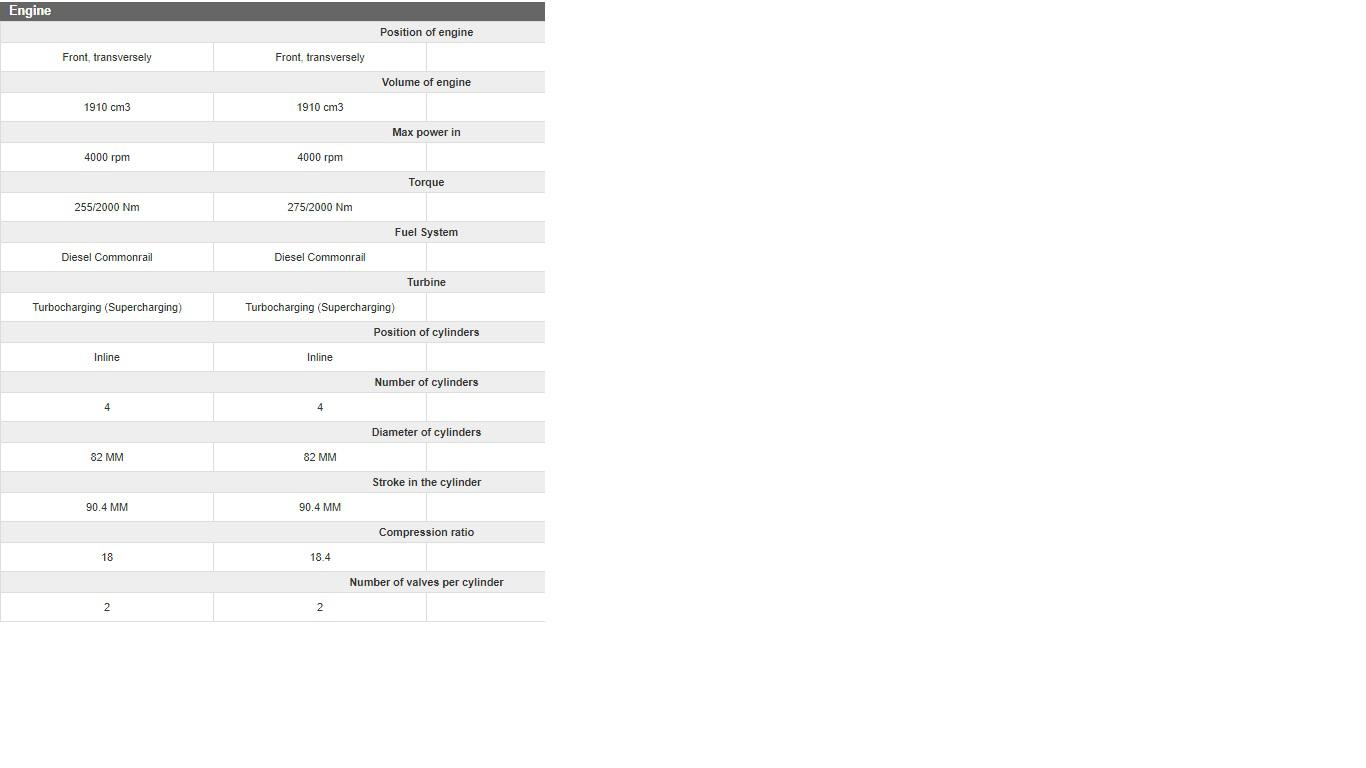

neshaoct 9740 Posted July 6, 2019 12 hours ago, Djosua said: nema snagu da vuce negde posle 3000 obrtaja... Koju 147-cu imaš, koje godište? JTD ili MJet (JTDm)? Pitam jer ako imaš neku od starijih 147-ca sa JTD 8v motorom od 115 (116) konja, on i počne da ''umire'' posle 3.000 obrtaja. Kao što su rekli ljudi, filter treba da zameniš svakako... Quote Share this post Link to post Share on other sites
MS PK 8308 Posted July 6, 2019 A brt ne umire nego se samo dere u prazno Quote Share this post Link to post Share on other sites
neshaoct 9740 Posted July 6, 2019 Pa to, da...dere se samo Quote Share this post Link to post Share on other sites
Djuk85 3064 Posted July 6, 2019 Nisam znao za taj podatak. Jel to vazi za sve jtd 8v? Quote Share this post Link to post Share on other sites
ISV_01 4795 Posted July 6, 2019 (edited) 8V mjet (jtdM) malo su elasticniji ali i oni pocinju sa izdisanjem oko 3500. mislim i posle se oseti da ima snage ali apsolutno nema potrebe ici toliko ... Bravo II 1.9 8V mjet vs AR 147 1.9 8V (primer za mjet i JTDm i izdašnost agregata) link 1 @Djuk85 Mozda male razlike, ali su osetne ako ga chipujes / mapiras. Edited July 6, 2019 by neshaoct formatiranje 2 neshaoct and Djuk85 reacted to this Quote Share this post Link to post Share on other sites
neshaoct 9740 Posted July 6, 2019 2 hours ago, Djuk85 said: Jel to vazi za sve jtd 8v? Za sve što je 8v - 1.9 JTD, 1.9 MJet/JTDm - u odnosu na 16v. 16v dizeli počinju samo da se deru na malo preko 4.000 obrtaja, tj. bolje vuku između 3.000 i 4.000 obrtaja nego braća im sa 8 ventila. Quote Share this post Link to post Share on other sites

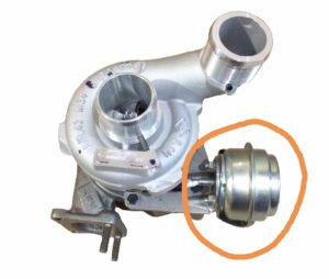

Aco 0 Posted December 7, 2019 Druze proveri vakum od turbine, onaj leptir na turbini mora da se pomerinna dole kad upalis auto, i kad dajea gas on mora da radi gore dole Quote Share this post Link to post Share on other sites
Pajko 3 Posted January 8, 2020 Pozz.. i moja 147 1.9jtd sa 8v nesto preko 3000 obrtaja se muči? Danas sam je vozio 170 km/h max i to je bilo nesto malo preko 3200 o/m...,ne znam dali je mozda zbog veličine felni? 16 cola a gume su 205/60. Turbo radi i u nizim stepenima prenosa(ima ih 5) do to vuce. Da nije do ventila za turbo? Hvala Quote Share this post Link to post Share on other sites
