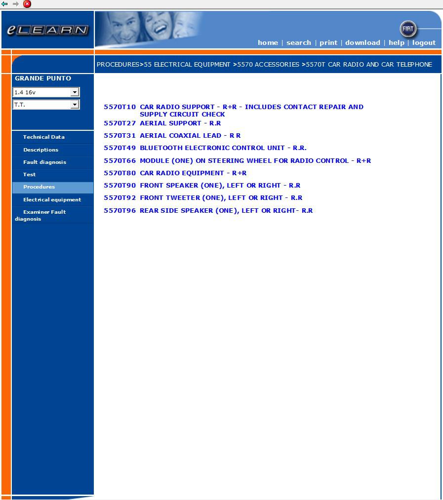

Branislav 748 Posted January 29, 2019 1 minute ago, neshaoct said: @Branislav Ima ovo...šta hoćeš da se klikne dalje: Joj dobro bi mi doslo sve to da imam da iscitam dobro Quote Share this post Link to post Share on other sites
neshaoct 9740 Posted January 29, 2019 Skini na komp... Evo opet link: https://www.fiat-lancia.org.rs/forum/index.php?/topic/70457-fiat-grande-punto-elearn/ 1 Branislav reacted to this Quote Share this post Link to post Share on other sites
