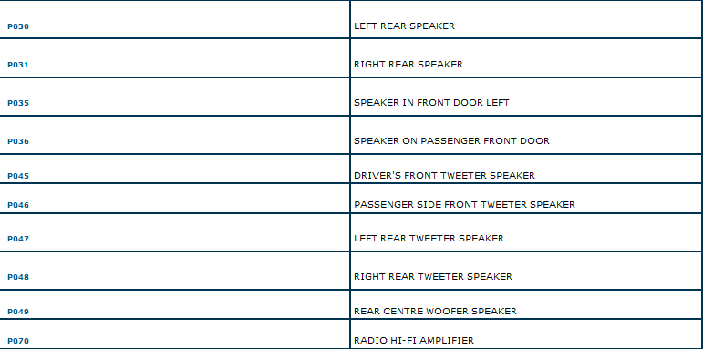

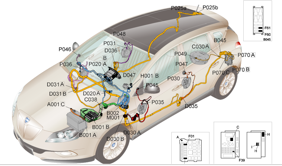

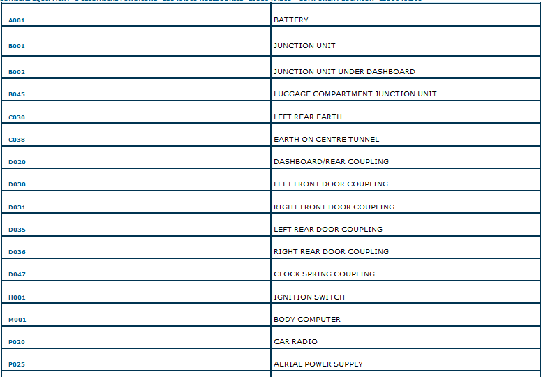

Bas kao sto sam i mislio, isto je kao i na ostalim italijanima, evo ovde imas slike lokacija komponenti, slike sema i sve ostalo sto ti treba, ako ti treba imam sve to u jednom PDF fajlu pa ti mogu poslati na mail.... a mogu videti i sa Nesom da okaci neki link da ostane na forumu.
DESCRIPTION
An INTERSCOPE Hi-Fi Sound System is available on request.

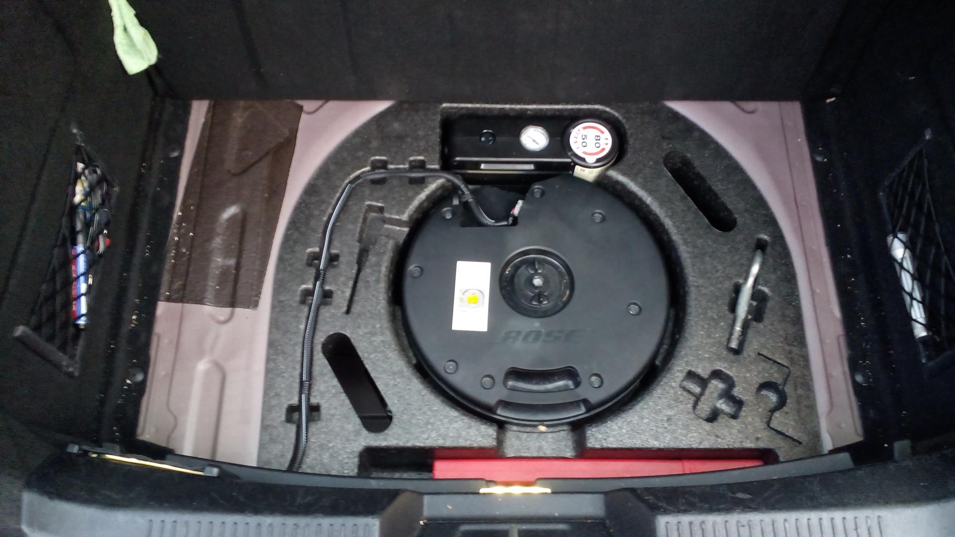

The Interscope audio system features aggressive sound capable of satisfying a young market.This system comprises 8 speakers, a power amplifier and a subwoofer box for deep bass tones.
The system has been developed ad hoc for the vehicle: the acoustic properties of the passenger compartment have been carefully studied so that the amplifier and the speakers are ideally suited to the vehicle: optimum listening is available in any part of the passenger compartment.
Unlike the system fitted as standard, this system offers:
- mid-woofer speakers and specific tweeters, both front and rear;
- sub-woofer box containing the power amplifier located in the luggage compartment, in the spare wheel housing.
- 8 channel amplifier (4 x 37 Wrms and 4 x 38 Wrms) located in the luggage compartment, left hand side.
The other components (radio, aerial, etc.) are the same as for the standard system.
FUNCTIONAL DESCRIPTION

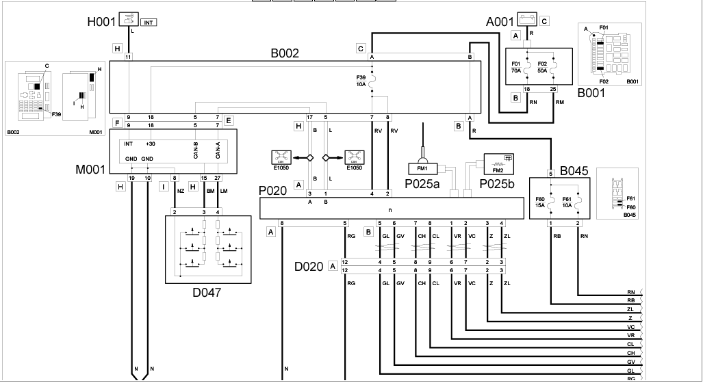

The radio P20 receives a direct power supply (pins 4 and 2 of connector A) from the battery via the line for fuse F39 of the junction unit under the dashboard B2.
Pin 8 of connector A is earthed.
Pins 1 and 3 of connector A receive the CAN line by which radio P20 is connected to Body Computer M1 and the other system nodes.
Body Computer M1 is connected to the radio controls on the steering wheel via the clock spring D47: pin 27 of connector H of M1 receives the signals for the buttons on the right of the steering wheel, whilst pin 15 of connector H of M1 receives the signals from the buttons on the left of the steering wheel.
The Body Computer M1 is supplied directly by the battery through the line protected by maxifuse F1 of B1 at pin 18 of connector F interfacing the junction unit under the dashboard B2; the ignition-controlled supply (INT) reaches pin 9 of connector F interfacing the junction unit B2.

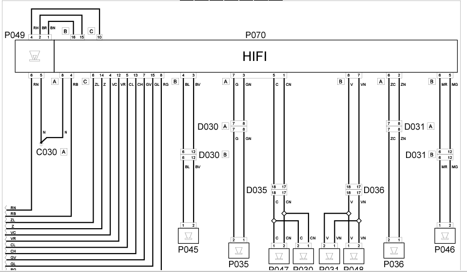

The amplifier P70 receives a direct power supply from the battery, at pin A4, via the line for fuse F60 of the luggage compartment junction unit B45; pin A8 of amplifier P70 is earthed.
Pin C8 of P70 is connected to the radio P20, pin A5 of connector A, which supplies a positive signal to enable the amplifier to be switched on.
The cables with signals for the amplifier P70 leave connector B of P20 (pins C6-14, C4-12, C5-13 and C7-15).
The cables with signals for the speakers leave P70;
- pins A3 and A7 to the left front speaker P35;
- pins A2 and A6 to the right front speaker P36;
- pins B3 and B4 to the left front tweeter P45;
- pins B5 and B6 to the right front tweeter P46;
- pins A1 and A5 to the left rear speakers P30 and P47;
- pins B7 and B8 to the right rear speakers P31 and P48.
The subwoofer P49 receives a direct power supply from the battery, at pin 6, via the line for fuse F61 of the luggage compartment junction unit B45; pin 5 of P49 is earthed, whilst pins 1, 2 and 4 are connected to the amplifier P70.
