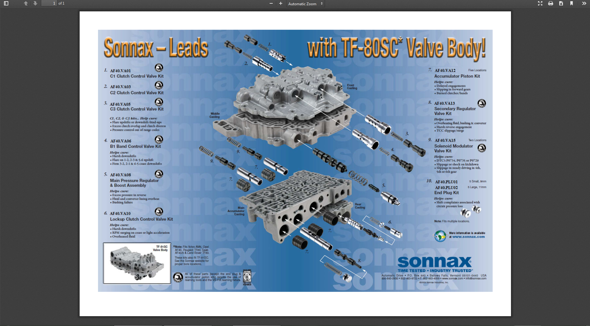

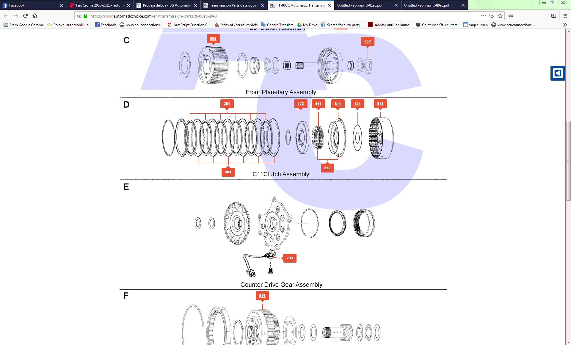

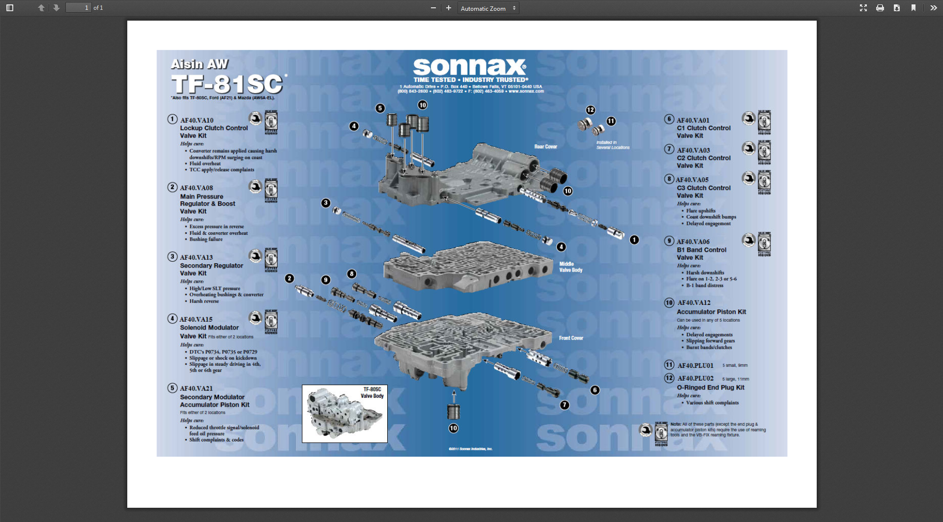

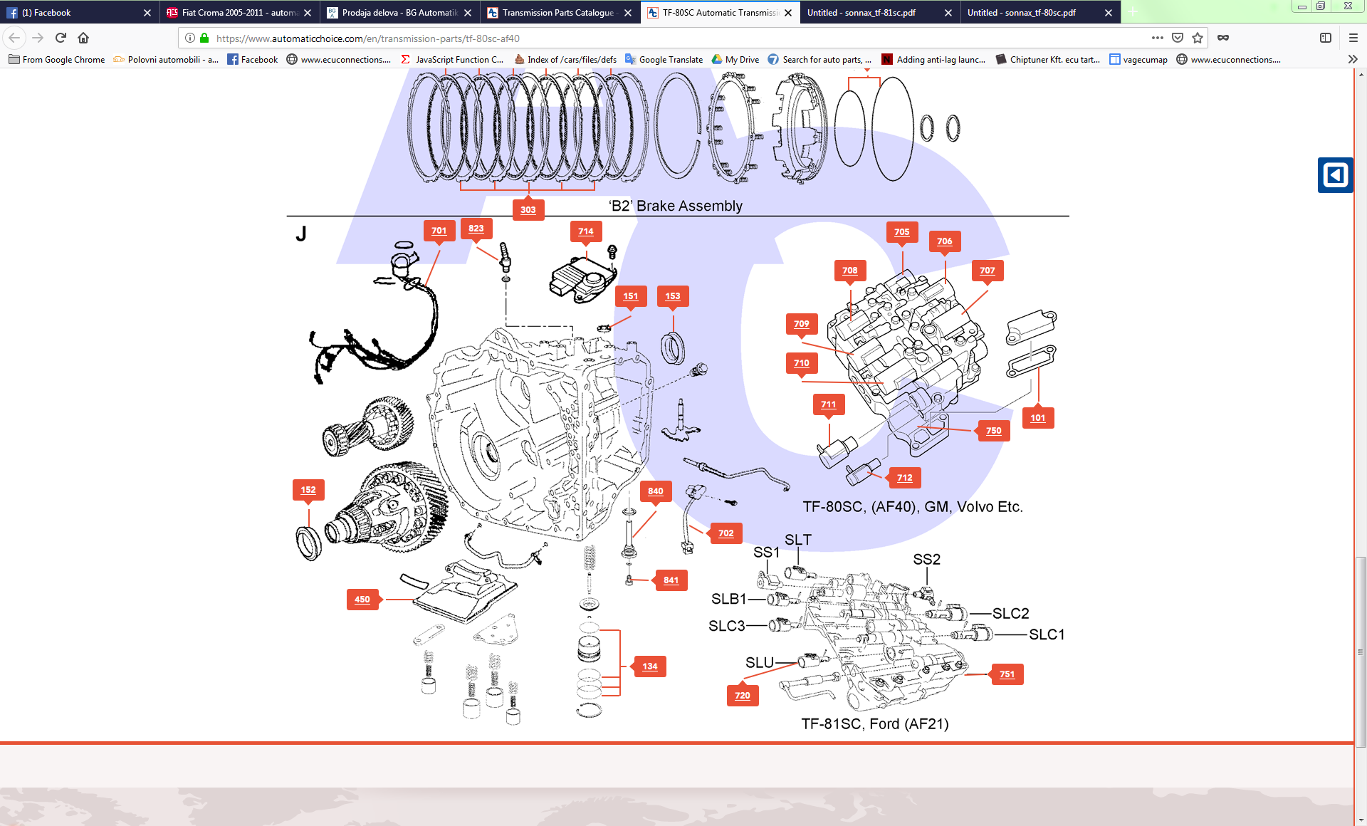

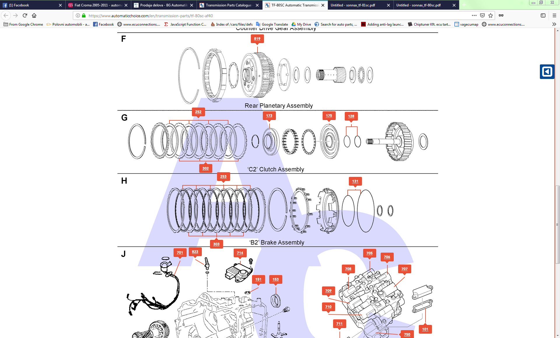

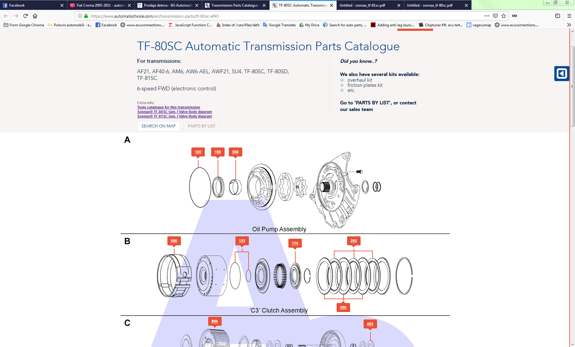

DraganUS 450 Posted November 17, 2018 U Cromu su isli TF-80SC i TF-81SC oba Aisin. Mozda neko razliku? Valve Body izgleda drugaciji. Mozda nekom pomogne sve ovo. 1 rasko78 reacted to this Quote Share this post Link to post Share on other sites

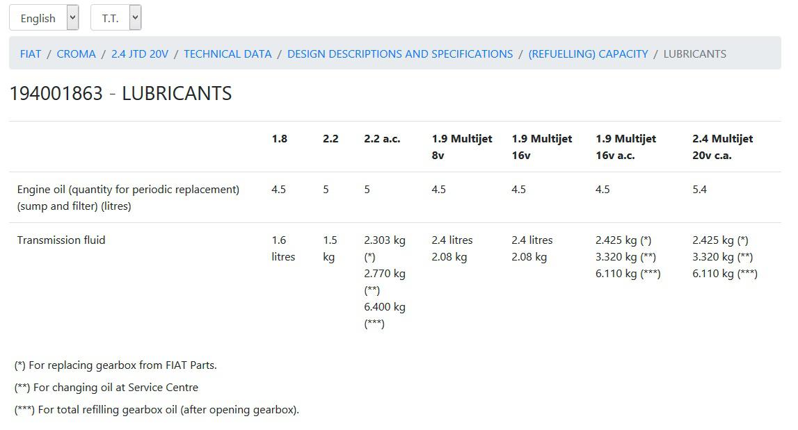

seki80 0 Posted January 26, 2020 (edited) Imam fiat cromu 2006 sa automatskom transmisijom , hteo sam da pitam koliko ulja u menjacu on zahteva jer mi je prijavio problem na diagnostici AISIN AF 40-6 jer mi se desava da obrtaji rastu a gas ne prima pa moram postepeno da ga ubrzavam sklonim nogu sa gasa pa da ga nabijem do kraja da bi primio brzinu.. Turbina i ostalo nisu problem samo je do toga pa ne znam da li do ulja moze da bude ili je otisao menjac. Edited January 26, 2020 by neshaoct spojeno Quote Share this post Link to post Share on other sites
Ivan 22116 Posted January 26, 2020 (edited) @seki80 Skoro smo pisali za Deltu, fabrika (eLearn) kaze ovako: Spojicemo sa postojecom temom: Edited January 26, 2020 by neshaoct dodao tag Quote Share this post Link to post Share on other sites
