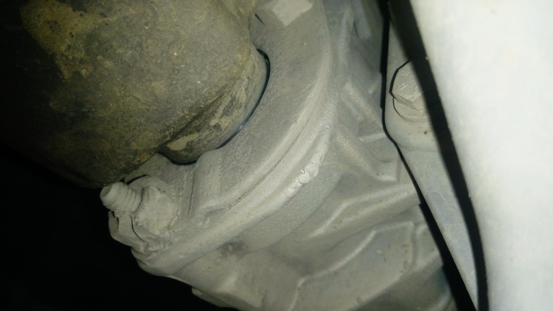

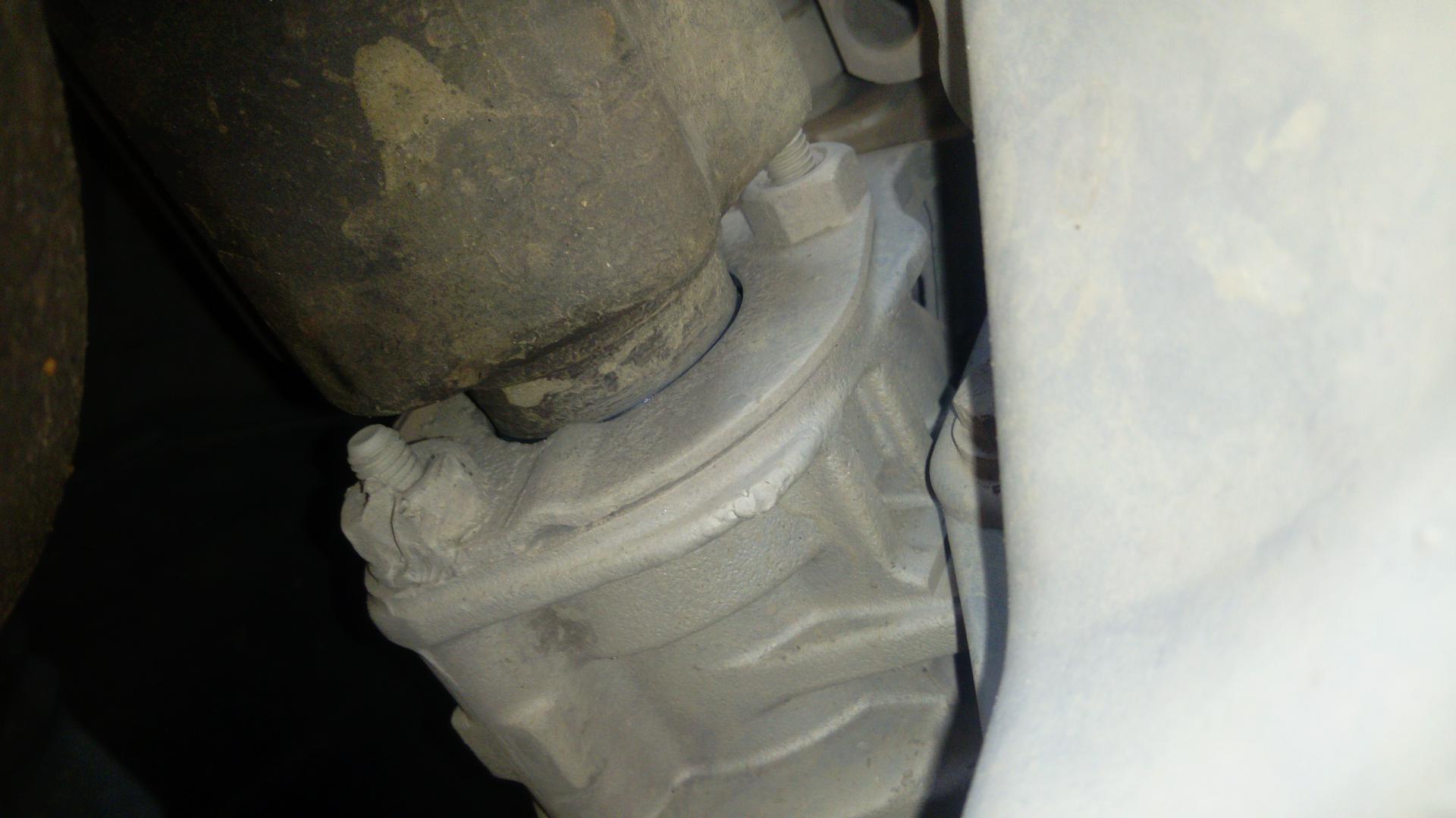

coa565 10 Posted July 22, 2018 Sutra onda skidam menjac i javljam situaciju. Nego jel sme da ima desna poluosovina luftu u onom kao lezaju koji je pred kraj falsne de se ubada krs poluosovine Quote Share this post Link to post Share on other sites
Dragomir m 6 Posted July 22, 2018 Nesme da ima lufata.Cudno da ti netrese u voznji. Quote Share this post Link to post Share on other sites
coa565 10 Posted July 22, 2018 Trese u voznji ubija dusu i u mestu kad stoji i dodajem gas osecaju se jake vibracije Quote Share this post Link to post Share on other sites
Dragomir m 6 Posted July 22, 2018 Trese u voznji zbog poluosovine,a u mestu moze biti nosac motora ispod akumulatora.Ali tebi i lamela klize. Iz kojeg mesta si? Quote Share this post Link to post Share on other sites
coa565 10 Posted July 22, 2018 Skidam menjac zbog lamele pa cu videti kakav je plivajuci, ako je los zamenicu ga fiksnim Iz djerekara, selo blizu brusa Quote Share this post Link to post Share on other sites
Dragomir m 6 Posted July 22, 2018 Au pa da mnogo velik luft.Zamajac u voznji da trese to je bas retko. Quote Share this post Link to post Share on other sites
coa565 10 Posted July 22, 2018 Dal ne trese zbog ovog lufta Quote Share this post Link to post Share on other sites
MS PK 8308 Posted July 22, 2018 Bre ti ovde ni nemas lager Послато са SM-J330F уз помоћ Тапатока Quote Share this post Link to post Share on other sites

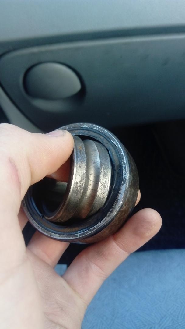

coa565 10 Posted August 10, 2018 Ipak nije zamajac Treslo dok se nije razletelo sve a onda pocelo da lupa Lezaj koji drzi poluosovinu u gornjem videu se vidi kolko je imao lufta Quote Share this post Link to post Share on other sites
ChobbyNS 540 Posted August 10, 2018 Ležaj poluosovine? Quote Share this post Link to post Share on other sites
coa565 10 Posted August 10, 2018 Da lezaj poluosovine Dimenzike fabricke su 35*62*20 63007-2RS1 Lezaj u radnjama kosta 1300 dinara ali po dimenzijama ima da se nadje original skf za 600 do 800 dinara Quote Share this post Link to post Share on other sites
ChobbyNS 540 Posted August 10, 2018 Džabe.Javi kako se ponaša auto nakon zamene.Mene čeka remont poluosovina, ima lufta u šoljama, taman ću i ležaj zameniti kad već radim sve. Quote Share this post Link to post Share on other sites
coa565 10 Posted August 10, 2018 Meni nije stalno treslo nego ponekad dok nije poceo da lupa i u leru da landara. Prvo sam i ja mislio na solje ali kad smo skinuli manzente sve je bilo u redu i masti je imalo. Sad bez poluosovine se necuje nista da landara. Javljam kako se ponasa kada stigne lezaj. Quote Share this post Link to post Share on other sites
MS PK 8308 Posted August 10, 2018 Ja ti lepo reko jos kad si postavio video da ga nemas uopste Послато са SM-J330F уз помоћ Тапатока Quote Share this post Link to post Share on other sites
