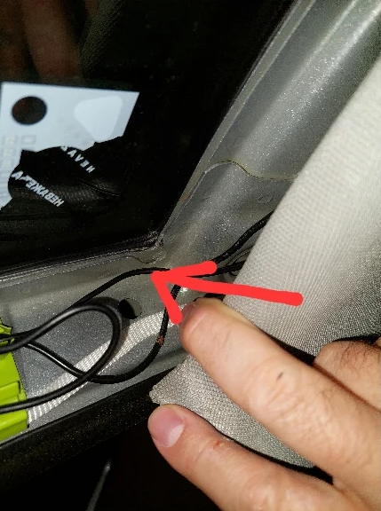

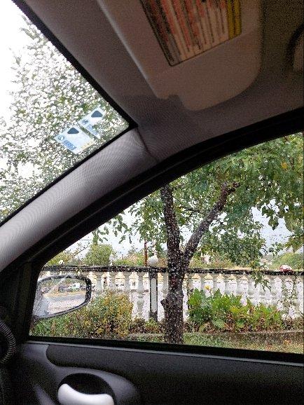

Miroslavjtd 4 Posted August 17, 2022 (edited) Pušta mi kišu na ovom ćošku?.. šta može da bude rešenje problema ? Ja da probam ili majstor. Fiat Stilo karavan? Edited August 17, 2022 by Ivan Spojeno, sredjene slike Quote Share this post Link to post Share on other sites
