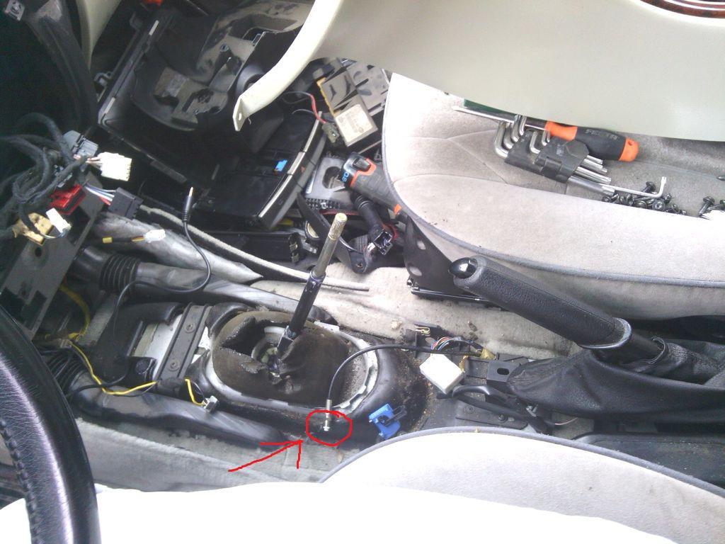

Alek.ilic 0 Posted August 14, 2017 Da li neko zna čemu služi ovaj konektor, uokviren crvenom bojom? Quote Share this post Link to post Share on other sites
