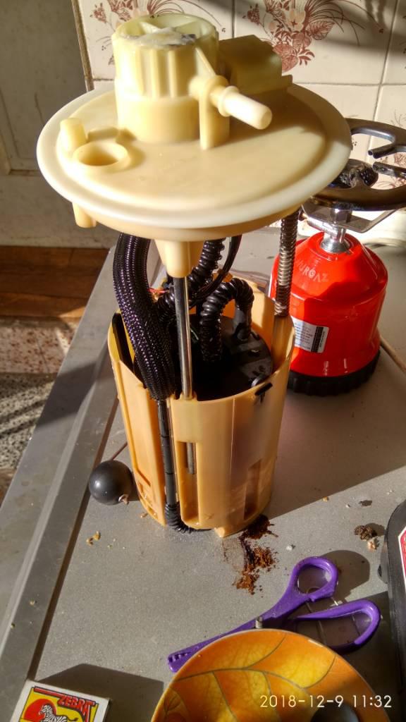

viper 157 Posted December 12, 2018 Ipak moze da se okrpi trajno. 1 neshaoct reacted to this Quote Share this post Link to post Share on other sites
hgt 6 Posted December 12, 2018 Sa kog auta ti ova pumpa ? Quote Share this post Link to post Share on other sites
viper 157 Posted December 12, 2018 Alfa 156 2.0jts 1 kreator reacted to this Quote Share this post Link to post Share on other sites
bokija 83 Posted December 13, 2018 Pa osim slika...uputi ljude cime si krpio? Quote Share this post Link to post Share on other sites
viper 157 Posted December 13, 2018 Sve te pumpe pucaju tu kod regulatora pritiska, pucuce i nova kad tad, greška konstrukcije. Krpio sam sa super lepak i soda bikarbona. Quote Share this post Link to post Share on other sites

hgt 6 Posted December 14, 2018 4 hours ago, Miki.Zvrk said: Ina da se kupi nova u Sabcu. Oko 50€ cini mi se U sapcu sam je i kupio 60 e nova , pumpa dolazi bez regulatora pritiska goriva tako je meni stigla pa sam stavio regulator od staru pumpu , koji izgleda nije ispravan , na pumpu nista ne pise kao da ih prave u neki podrum , puko sam 60 e i opet imam problem prvo paljenje ujutru , vergla do 10 sekunde dok upali . Quote Share this post Link to post Share on other sites

lomisa 9 Posted November 29, 2020 Fiat brava 1.2 16v. Nakon 7 dana bez akumulatora, kupio nov, spojio i auto vergla, ali ne pali! Gasi code key lampicu i vergla, ali se ne čuje pumpa goriva da zuji kada se daje kontakt. Pretpostavljam da je nešto do dužeg stajanja bez akumulatora, ili je crkla pumpa. Ima li neko ideju? Gde se na ovom modelu nalazi relej pumpe? Da li može da crkne ecu, ako stoji bez akumulatora... Jedino mi ostaje da proverim unimerom da li dolazi struja do pumpe. Da li je neko imao sličan problem? Quote Share this post Link to post Share on other sites
lomisa 9 Posted December 6, 2020 On 11/29/2020 at 5:04 PM, lomisa said: Fiat brava 1.2 16v. Nakon 7 dana bez akumulatora, kupio nov, spojio i auto vergla, ali ne pali! Gasi code key lampicu i vergla, ali se ne čuje pumpa goriva da zuji kada se daje kontakt. Pretpostavljam da je nešto do dužeg stajanja bez akumulatora, ili je crkla pumpa. Ima li neko ideju? Gde se na ovom modelu nalazi relej pumpe? Da li može da crkne ecu, ako stoji bez akumulatora... Jedino mi ostaje da proverim unimerom da li dolazi struja do pumpe. Da li je neko imao sličan problem? Rešio sam problem. Izmerio naporne na relej i do pumpe, video da ima struje. Bilo je do pumpe, zaglavila se od stajanja i lošeg goriva. Razglavio sam je sa wd40 i okretanjem u oba smera, promenom polariteta struje na akumulator, uz blago kucanje gumenim čekićem... Ispalo neko đubre iz nje... Inače, sad lepo i ravnomerno okreće. Polovna je mačka u džaku. Može da se zameni samo uložak pumpe, koji košta oko 1500 din.,ali su problem plastična creva, koja treba skinuti, i koja treba najčešće iseći. To su specijalna creva za potapajuce pumpe, plastična, koja su sa obe strane otporna na razaranje od benzina, i teško se savijaju. Ima ih da se kupe u pojedinim radnjama i na internetu... Tako da se pumpa može reparirati. Inače filter goriva je na samoj pumpi i zavaren u crnu plastiku i mislim da se ne može zameniti,možda se može malo isprati i produvati kompresorom kroz kućište. 1 Mijailović P. reacted to this Quote Share this post Link to post Share on other sites
