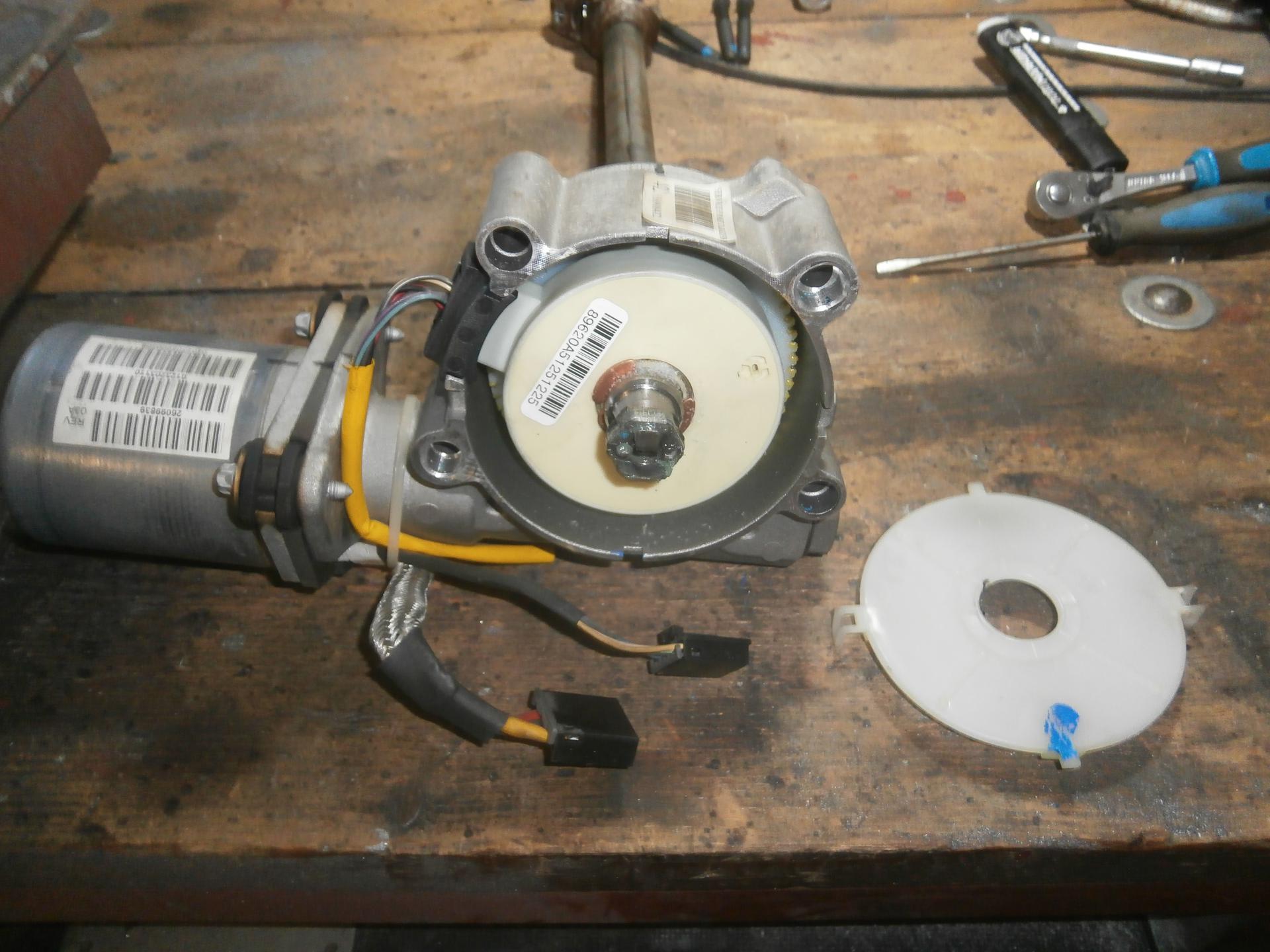

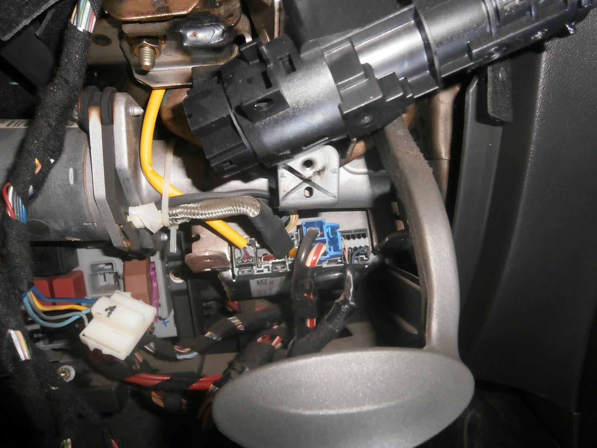

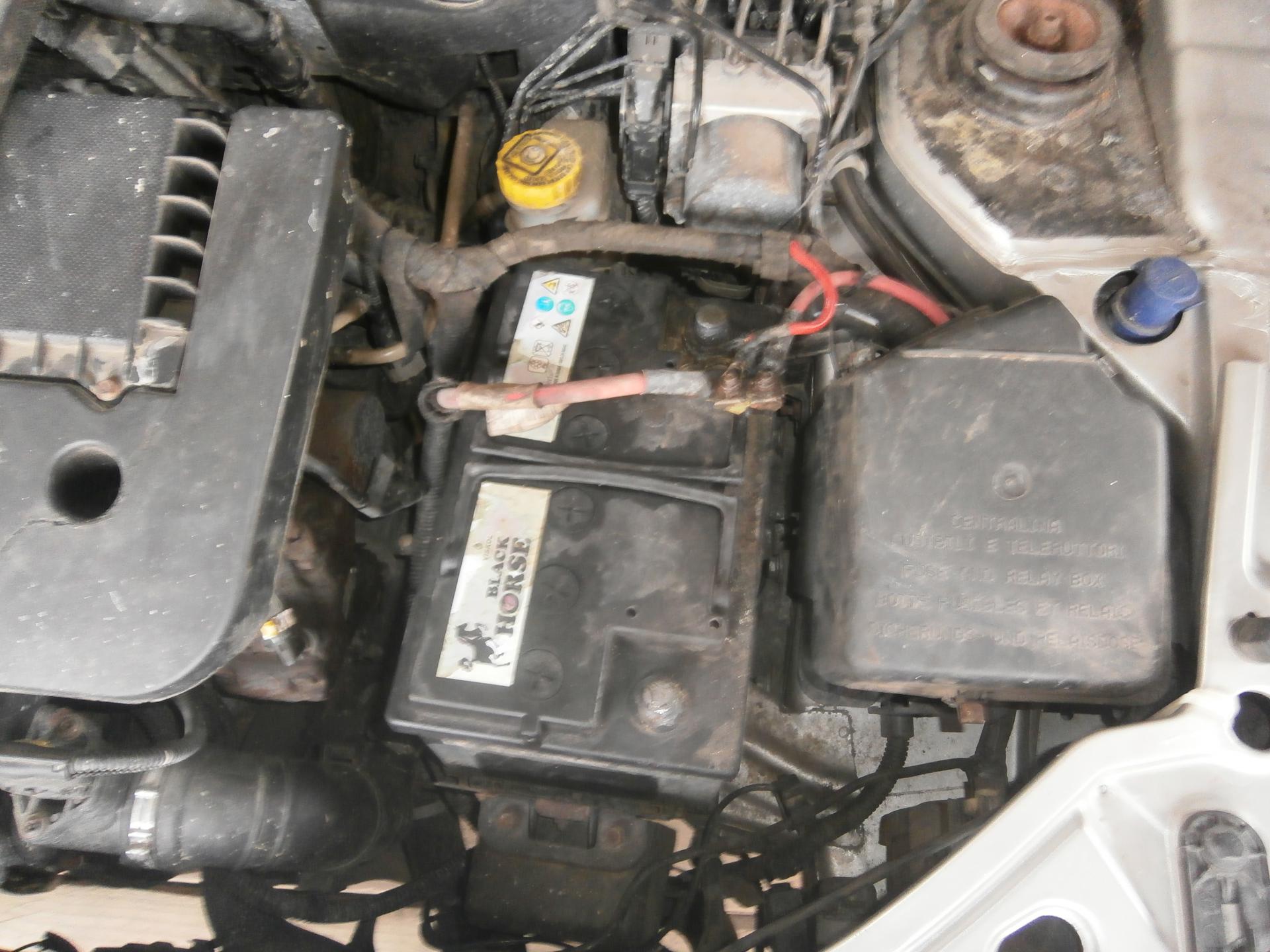

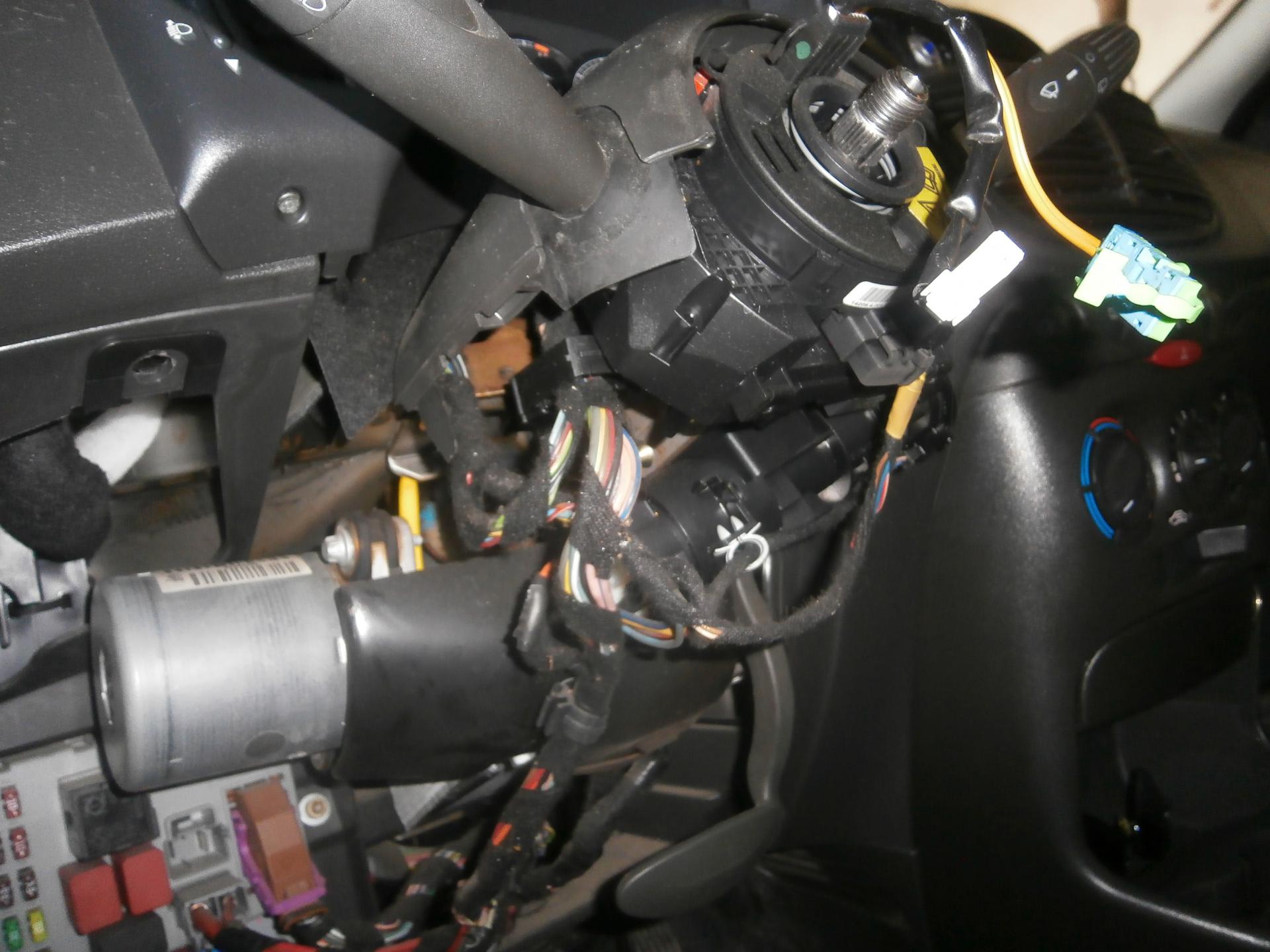

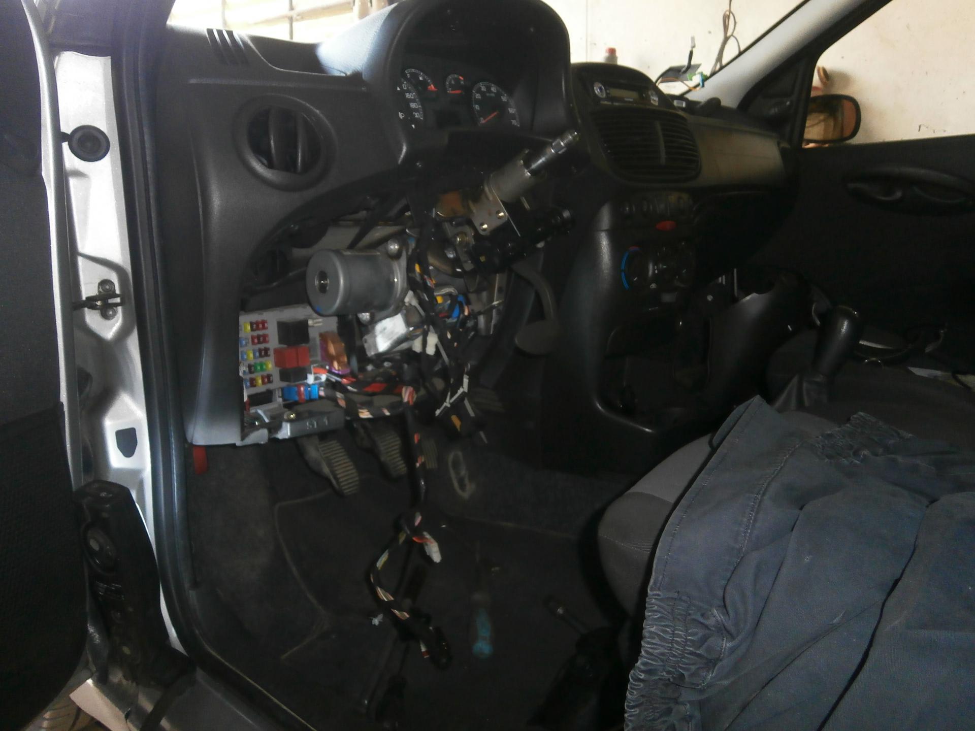

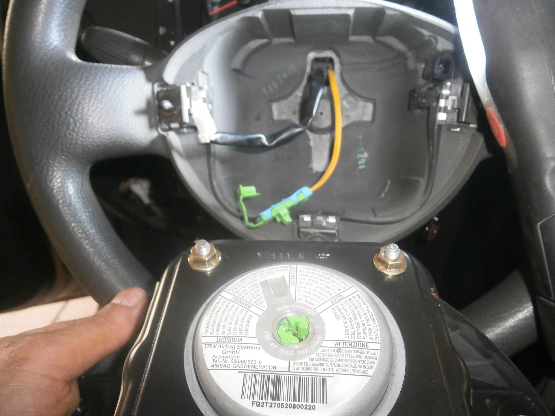

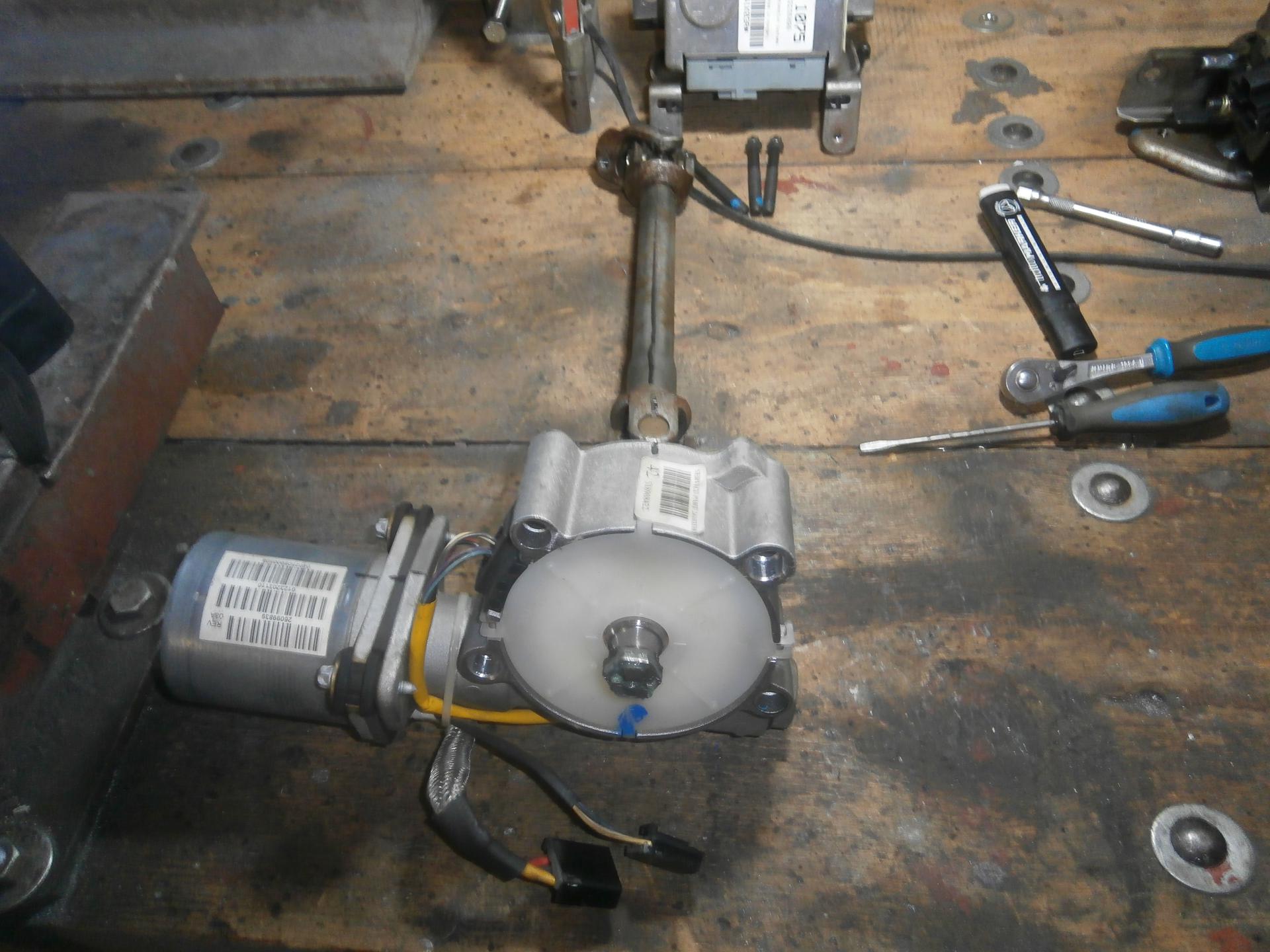

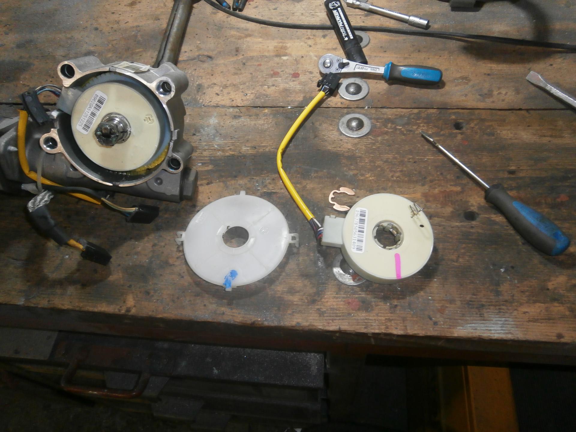

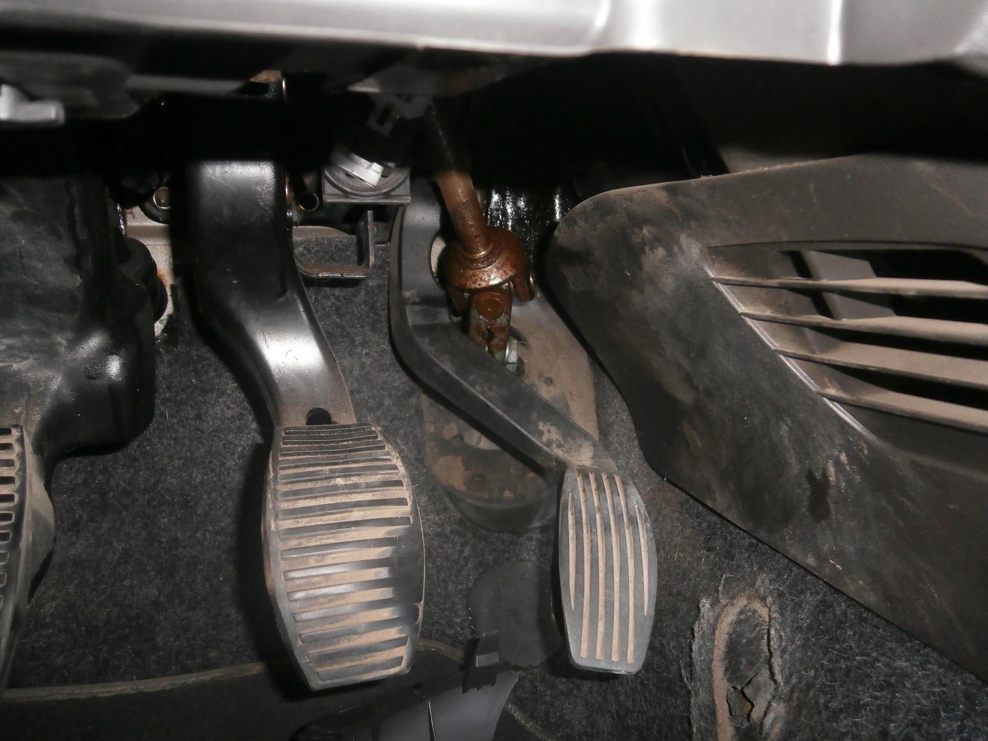

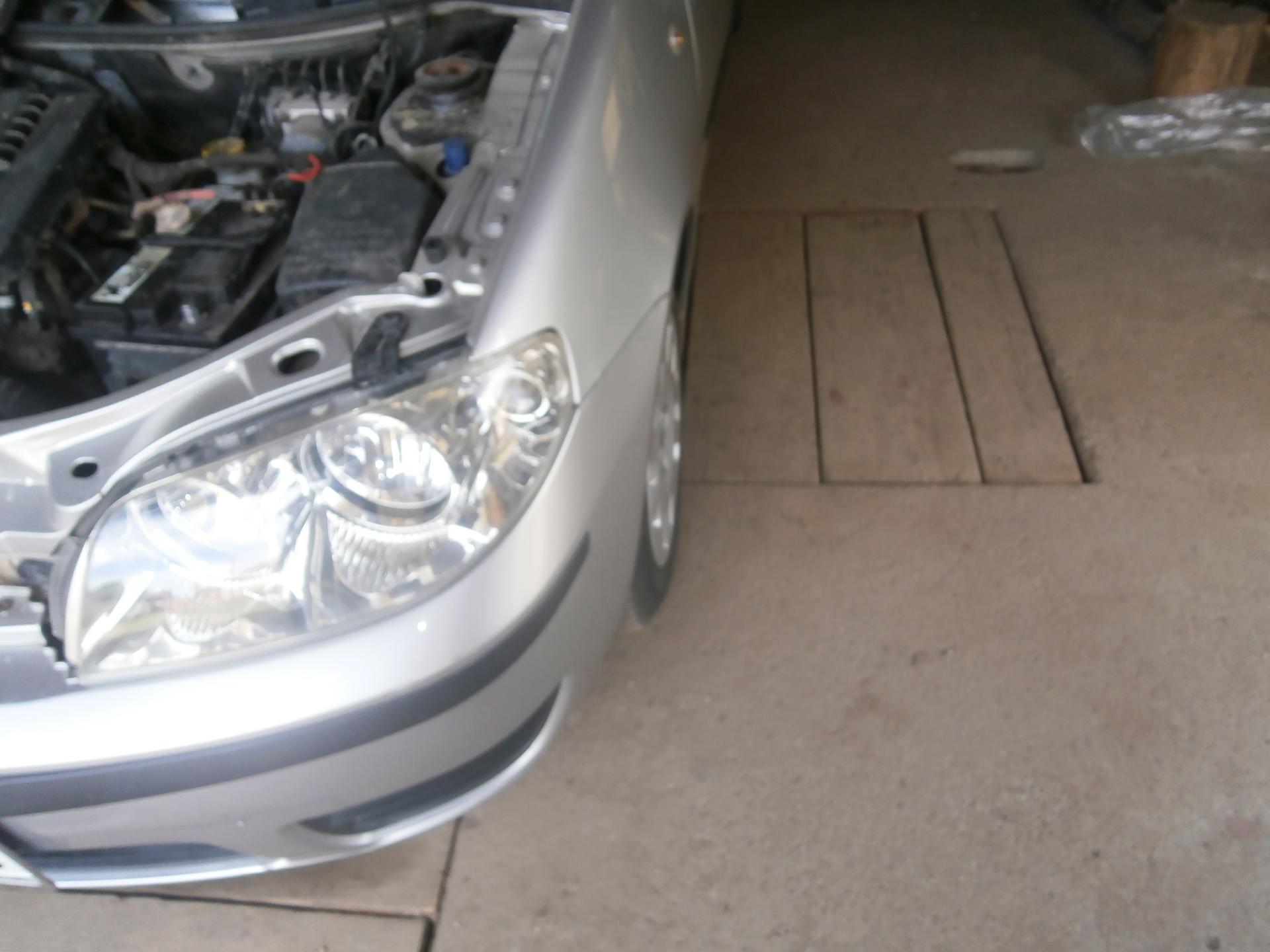

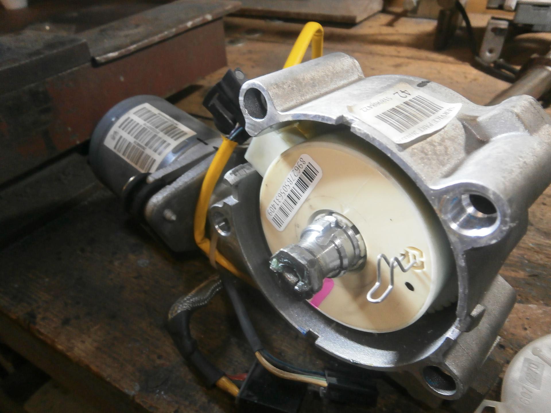

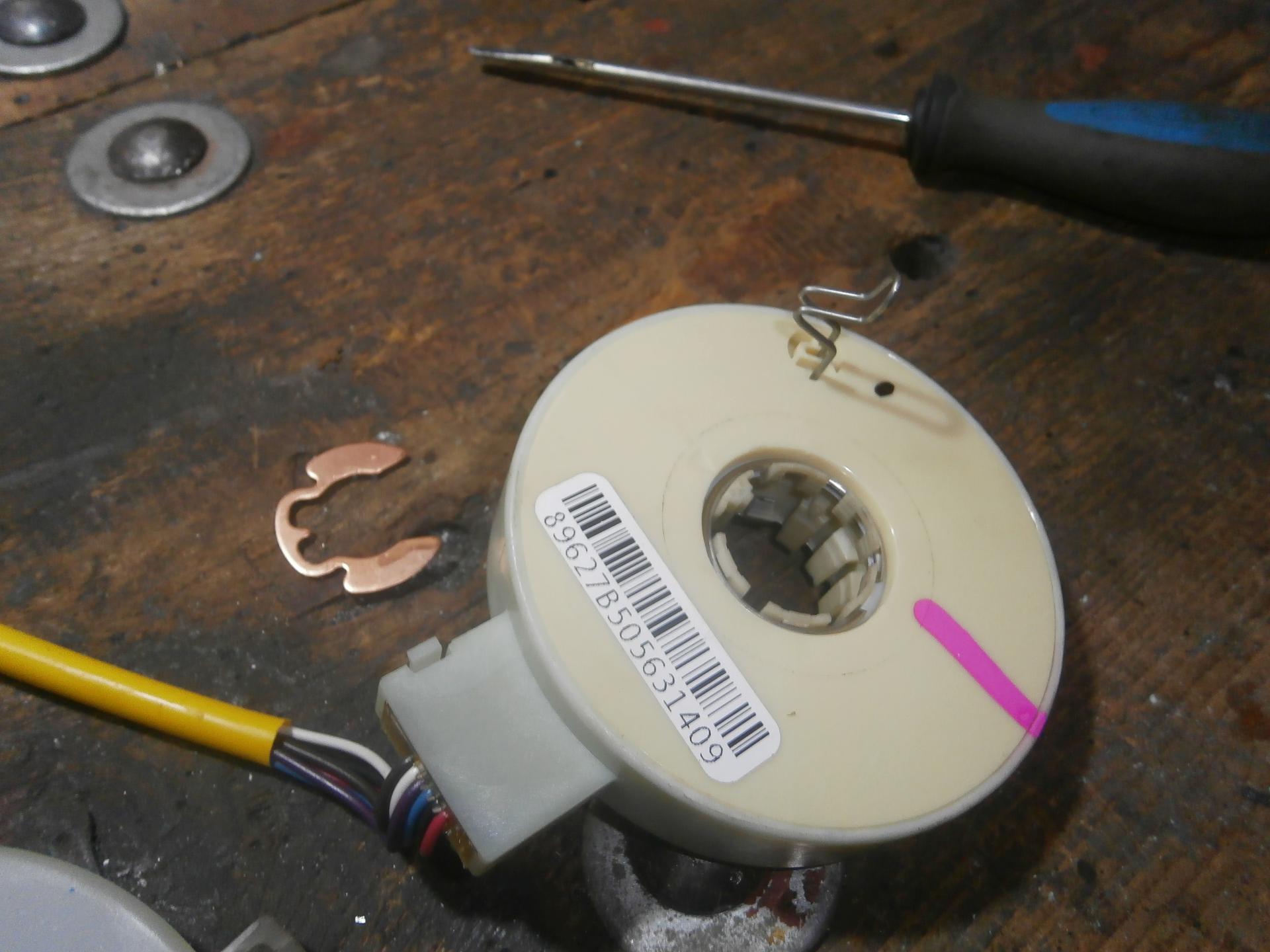

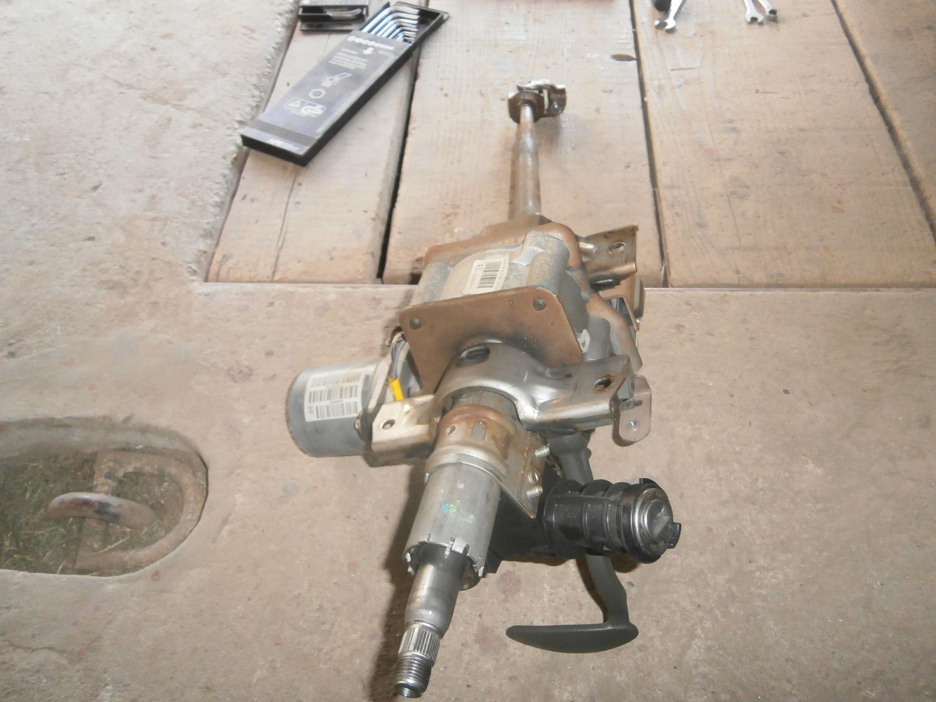

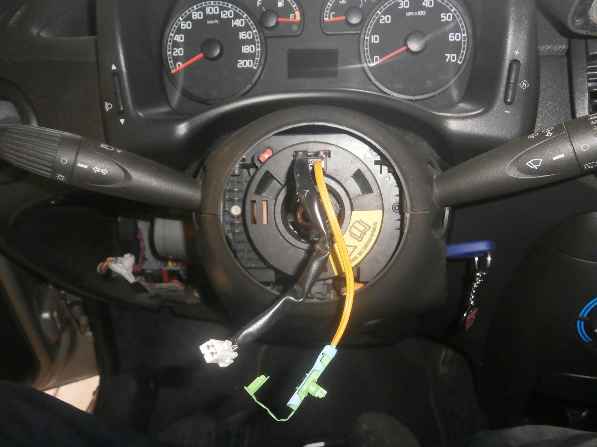

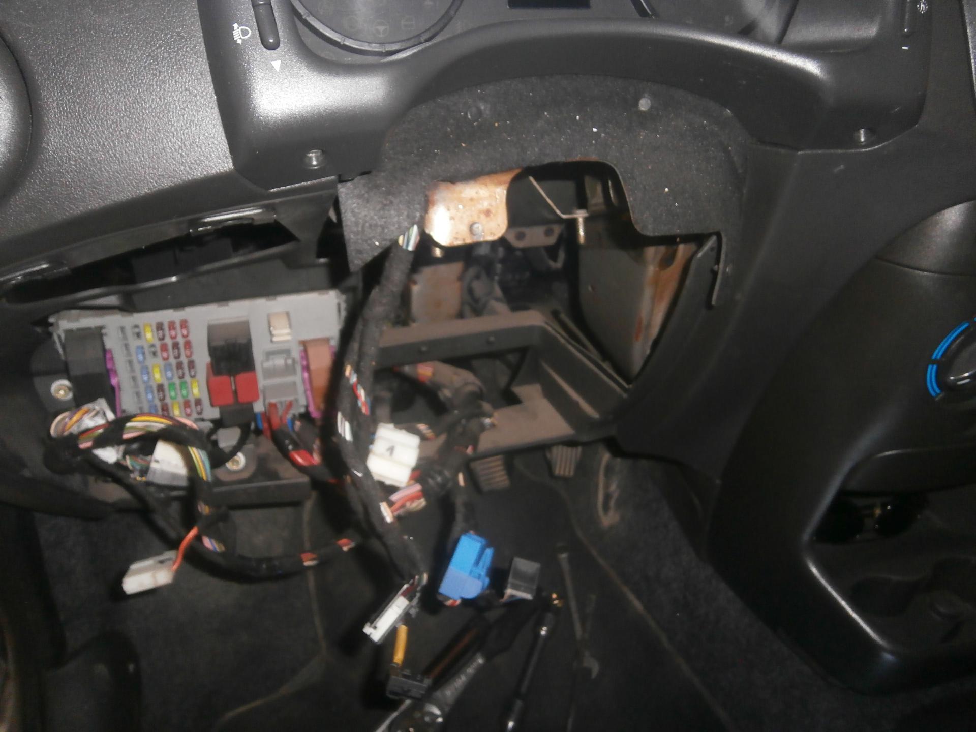

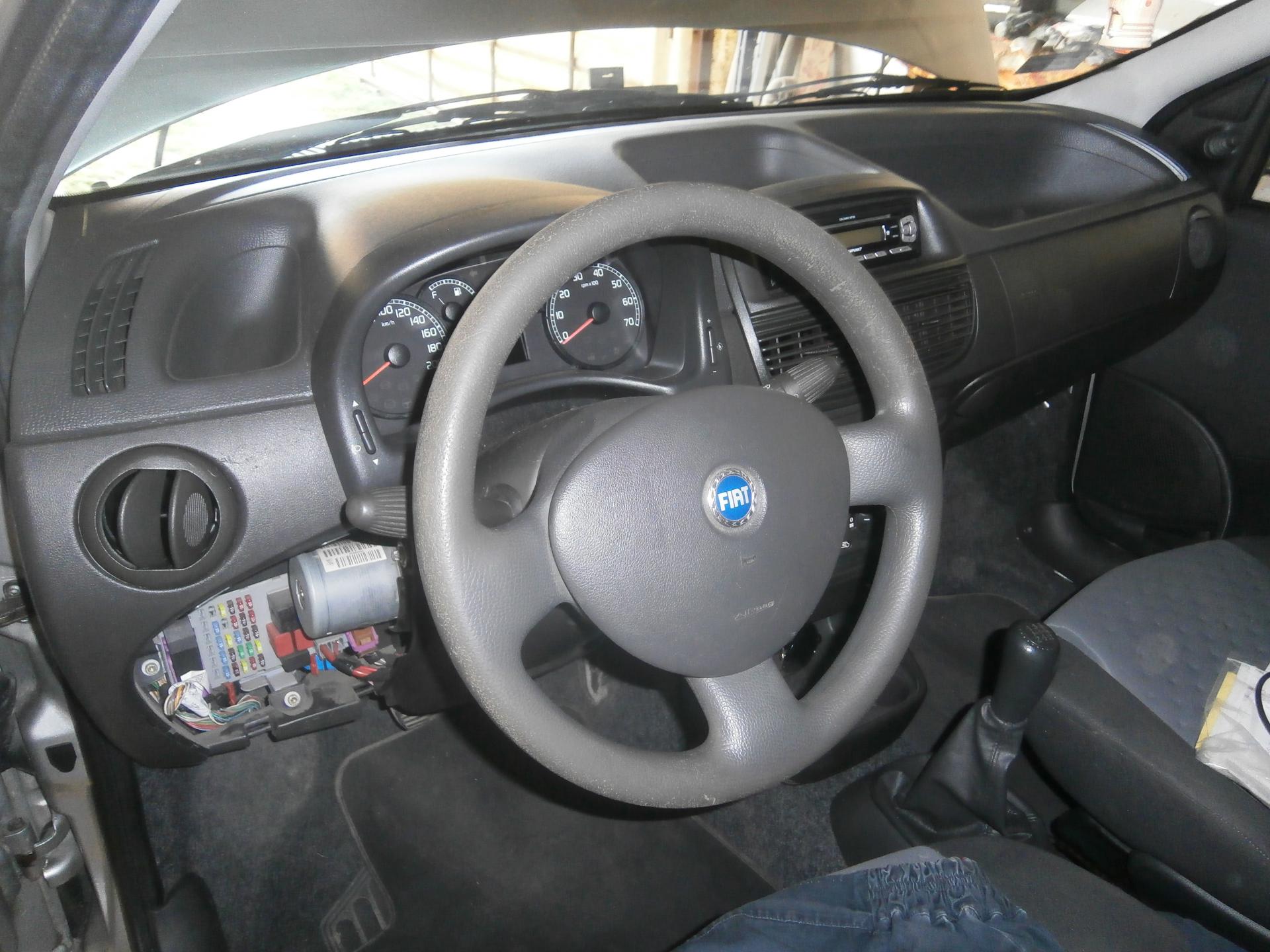

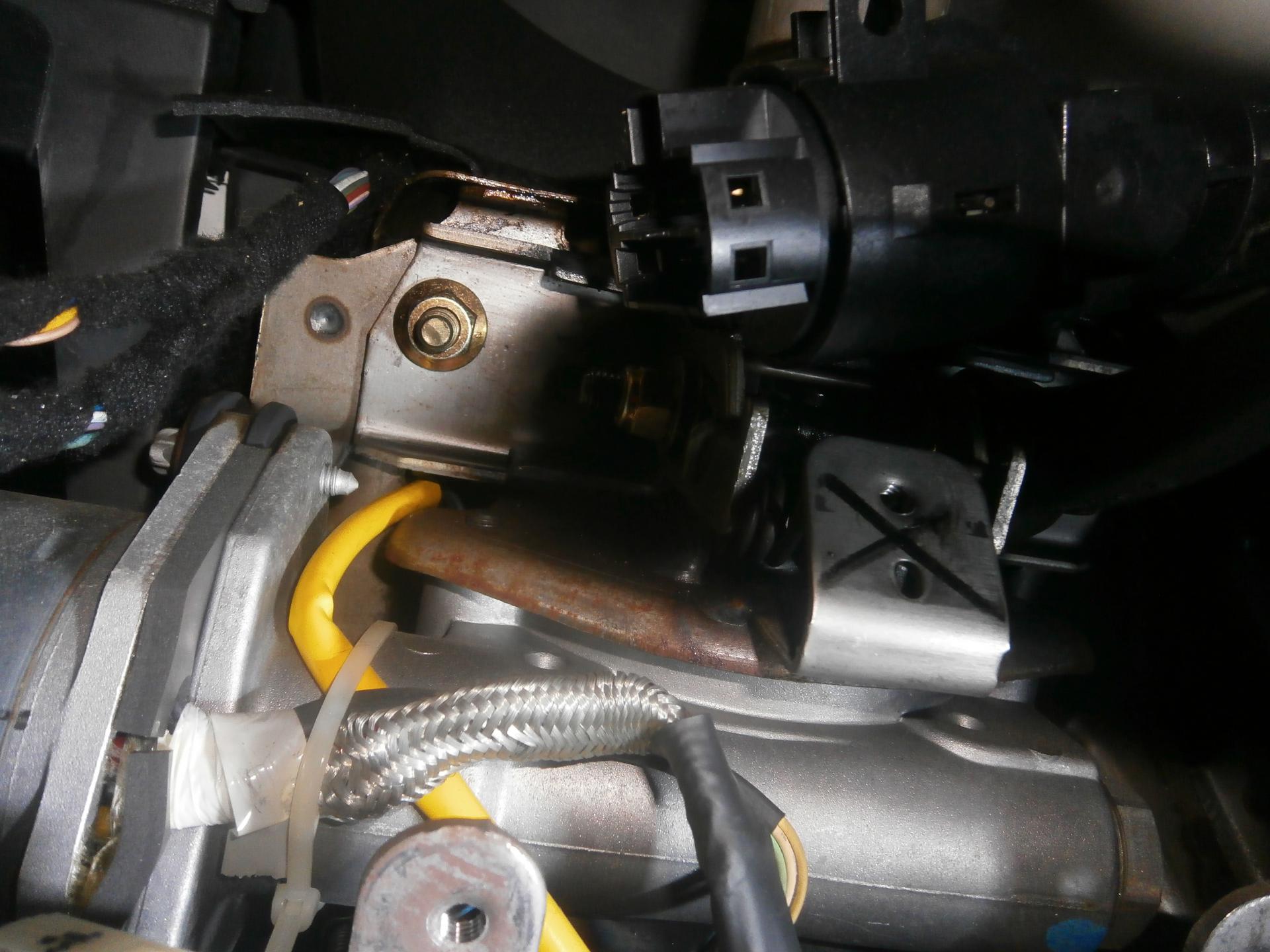

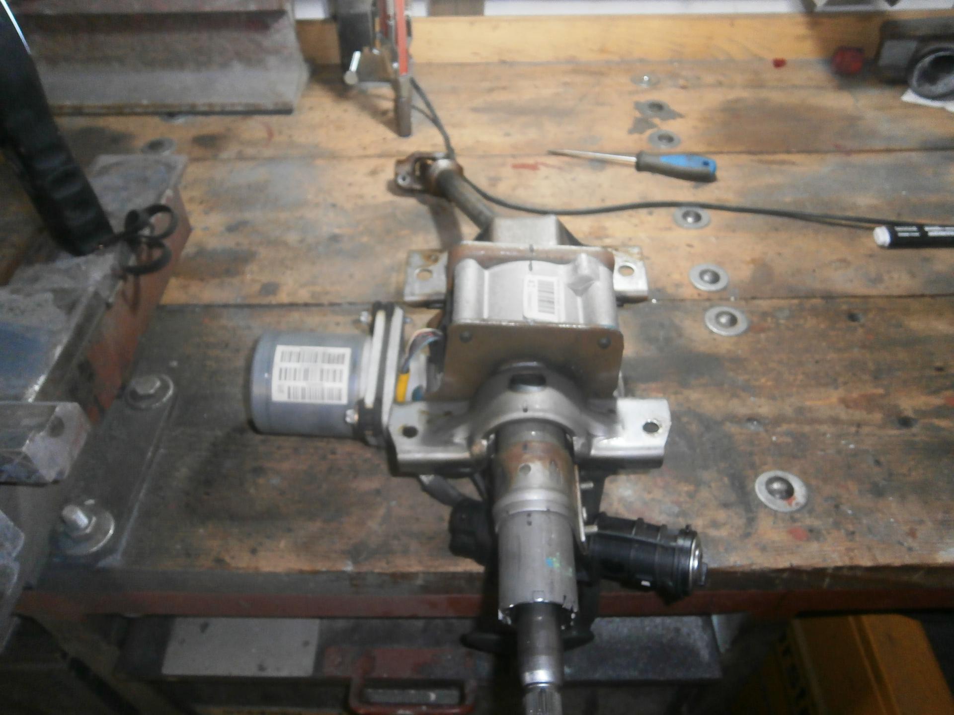

puntara 26 Posted May 9, 2018 Evo otprilike ovako : 1 neshaoct reacted to this Quote Share this post Link to post Share on other sites
Zvezdo 1434 Posted May 9, 2018 Svaka čast! Ovo će mnogima koristiti. Pošto je sada senzor? Quote Share this post Link to post Share on other sites
puntara 26 Posted May 9, 2018 Mislim da je drugar platio desetak crvenih Quote Share this post Link to post Share on other sites
Goran Zemun 488 Posted May 9, 2018 Samo niste morali skidati volan i ablander sa kucista volana.....skinete sve zajedno i tako vratite. Dosta manje posla. 1 neshaoct reacted to this Quote Share this post Link to post Share on other sites
puntara 26 Posted May 9, 2018 (edited) Nisam razmisljao u tom smeru. Hvala na savetu, uštedeće vreme nekom drugom prilikom. Edited May 9, 2018 by puntara Quote Share this post Link to post Share on other sites
Goran Zemun 488 Posted May 9, 2018 Naravno...ali ako menjate par komada svaki dan....onda znaci... Quote Share this post Link to post Share on other sites
