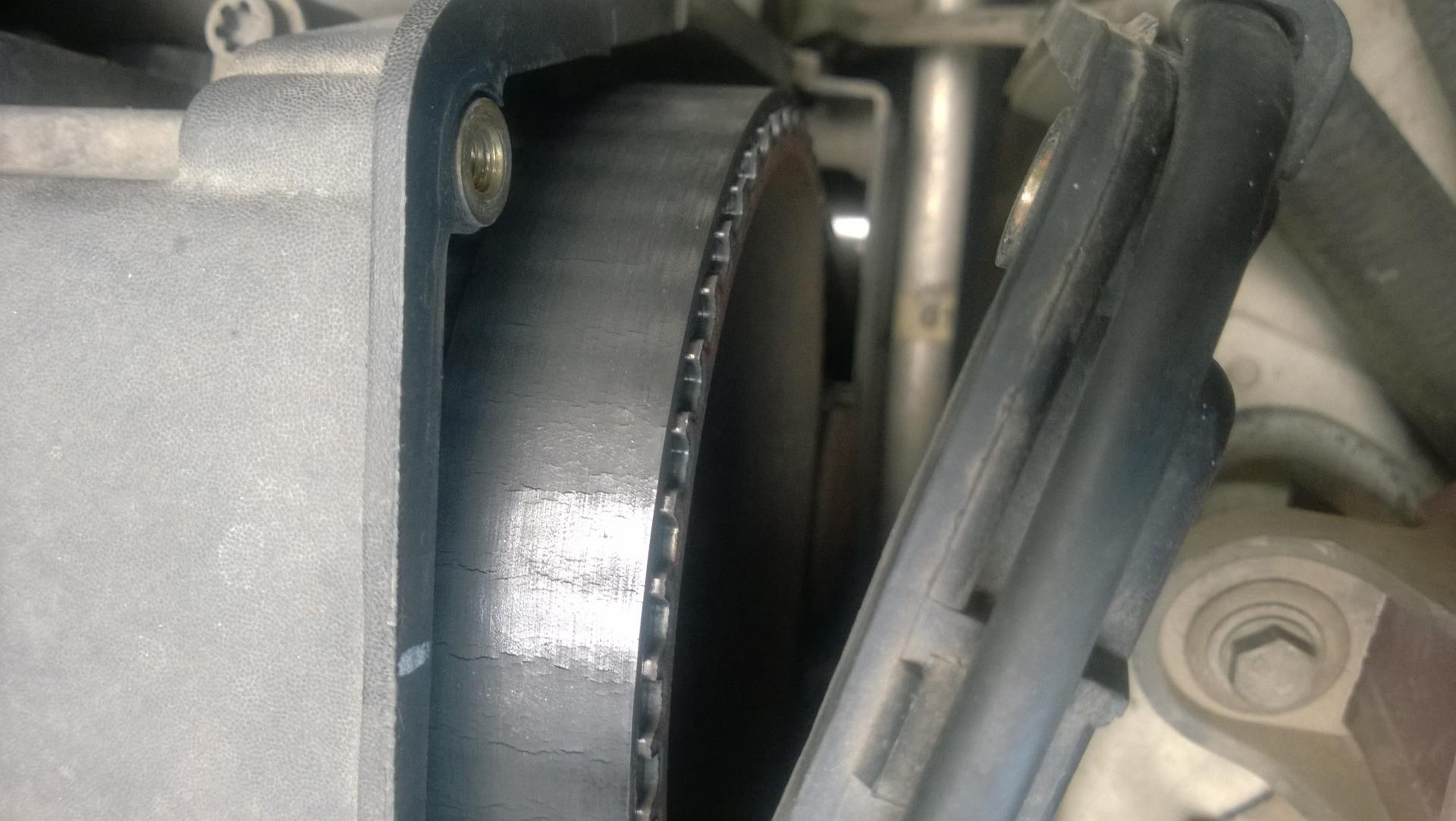

jocifer93 1 Posted May 26, 2017 Zdravo. Još koliko bi mogao da izdrži ovaj zupčasti kaiš otprilike? U pitanju je punto 1.9d. Auto se samo po gradu vozi. Hvala. Quote Share this post Link to post Share on other sites
beli_Punto 123 Posted May 26, 2017 Ovo je davno trebalo da bude bačeno u kantu... Quote Share this post Link to post Share on other sites
MS PK 8305 Posted May 26, 2017 Mozda jos minut a mozda i godinu dana. Ko ce ga znati Quote Share this post Link to post Share on other sites
zoran rakita 0 Posted May 26, 2017 Auuu pa vidi se da je ispucao to je rizik i da se pali... Quote Share this post Link to post Share on other sites
cuore_sportivo 79 Posted May 26, 2017 (edited) E ovakav je bio.kod ortaka u Puntiću..odmah menjaj..ne cekaj kao on pa da bude kuku.. Edited May 26, 2017 by cuore_sportivo Quote Share this post Link to post Share on other sites
coa565 10 Posted May 26, 2017 E takav je bio kod mene 5 dana pre pucanja, ima u ovoj temi moj slucaj na prethodnoj strani. Menjaj odma jer ako spaner zakove na ovakvom kajsu pucanje sledi za 2 minuta. Pozz Quote Share this post Link to post Share on other sites
