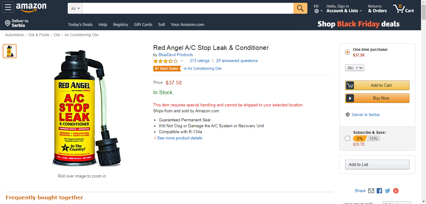

nedo2905 14 Posted November 28, 2019 (edited) Pozdrav, propustilo je lijevo (bliže sredini vozila) crijevo od kompresora do hladnjaka klime, čuje se zvuk šuštanja kada radi kompresor. Pitanje je da li ima itko iskustva sa tekućinama za brtvljenje sustava klime, da li vrijedi pokušavati? Jer novo crijevo je oko 200€.. Link na primjer sredstva: https://www.amazon.com/Red-Angel-Stop-Leak-Conditioner/dp/B002BG4WX2# Inace automobil je Lancia Delta 1.6. 85kw 2009 Živili Edited November 29, 2019 by neshaoct dodao printscreen / precizirao naslov teme Quote Share this post Link to post Share on other sites
djomla 8458 Posted November 28, 2019 A da probas naci crevo na nekom otpadu? 1 neshtry reacted to this Quote Share this post Link to post Share on other sites
Milutinac 6121 Posted November 28, 2019 Polovno a dobro, a ima i firmi koje se bavi proizvodnjom creva po uzorku. Ja za punta pravio, bilo odlicno. Ostavljam ako nekom zatreba. http://www.hidraulika.co.rs/ 2 1 neshaoct, djomla and BGMilos reacted to this Quote Share this post Link to post Share on other sites
djomla 8458 Posted November 28, 2019 Mnogo bolje rešenje. Quote Share this post Link to post Share on other sites
nedo2905 14 Posted November 29, 2019 Hvala ekipa, ipak kupujem polovno i odustajem od brtvila. 1 neshaoct reacted to this Quote Share this post Link to post Share on other sites
