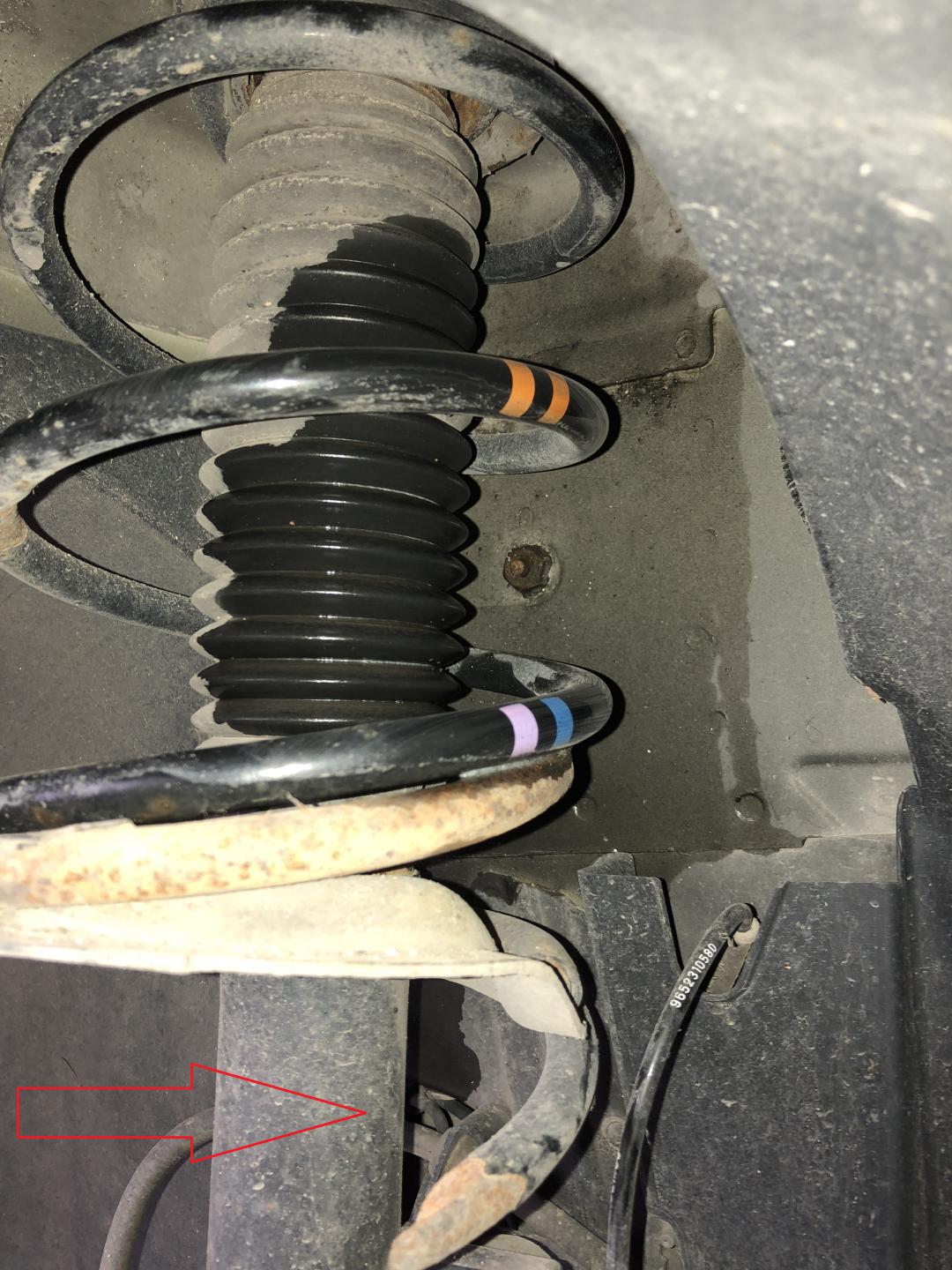

DraganUS 450 Posted February 4, 2019 Meni pukla opruga pre neki dan. Quote Share this post Link to post Share on other sites
Zan Batist 399 Posted February 4, 2019 meni proljetos pukla opruga na 307, slucajno vidio kad sam stavljao ljetnji set.. znacio vozio par mjeseci tako - nista se nije osjecalo. Quote Share this post Link to post Share on other sites
