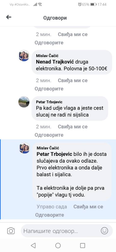

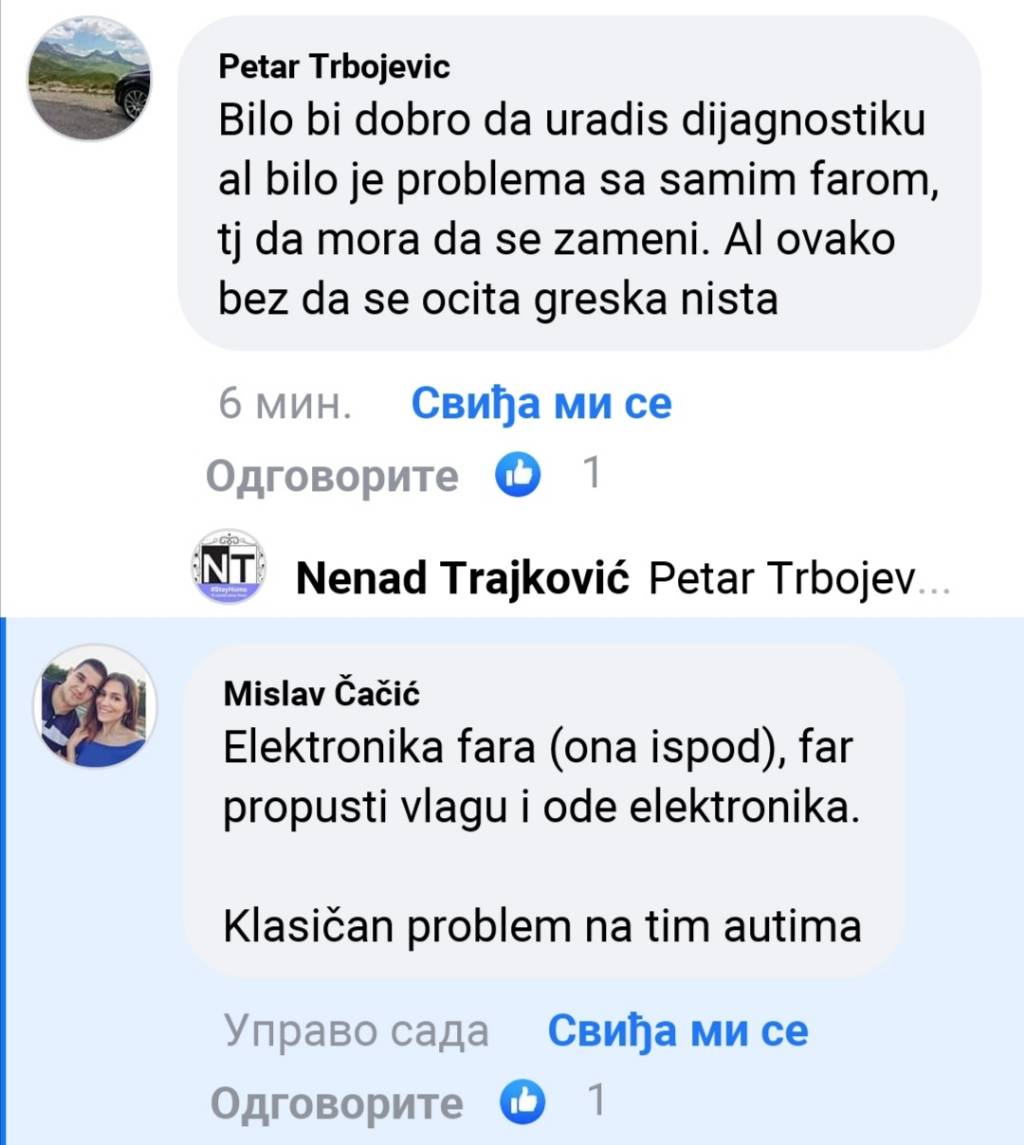

neshtry 19767 Posted April 3, 2020 Evo nekih smernica 1 1 neshaoct and Woodoo reacted to this Quote Share this post Link to post Share on other sites
Mishko 1 Posted April 3, 2020 Na to sam i ja nailazio kao odgovor, al opet bolje bi bilo da elektronicar pogleda, da ne bude posle promenim far pa opet isto. U svakom slucaju hvala Ni sam far nije jeftin uopste, radije bih da neko iskusan i kvalitetan u tom poslu kaze sta je u pitanju Quote Share this post Link to post Share on other sites
neshtry 19767 Posted April 3, 2020 Ima i elektronika posebno da se kupi, pa vidi.... Quote Share this post Link to post Share on other sites

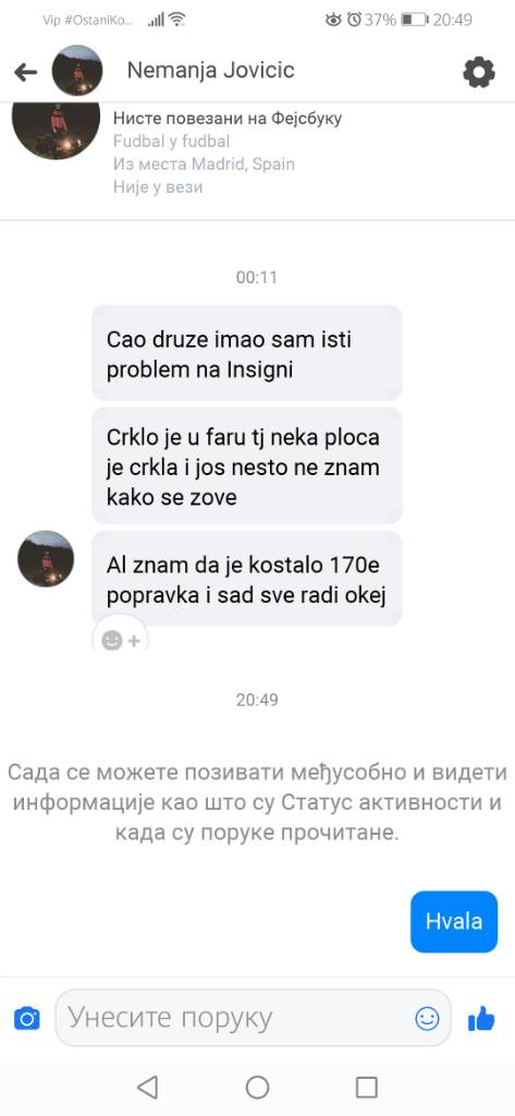

neshtry 19767 Posted April 4, 2020 On 4/3/2020 at 5:45 PM, Mishko said: Na to sam i ja nailazio kao odgovor, al opet bolje bi bilo da elektronicar pogleda, da ne bude posle promenim far pa opet isto. U svakom slucaju hvala Ni sam far nije jeftin uopste, radije bih da neko iskusan i kvalitetan u tom poslu kaze sta je u pitanju Ima apdejt 1 1 Woodoo and neshaoct reacted to this Quote Share this post Link to post Share on other sites
Mishko 1 Posted April 5, 2020 Gde i kako je sredio to, moze li da me uputi??? Quote Share this post Link to post Share on other sites

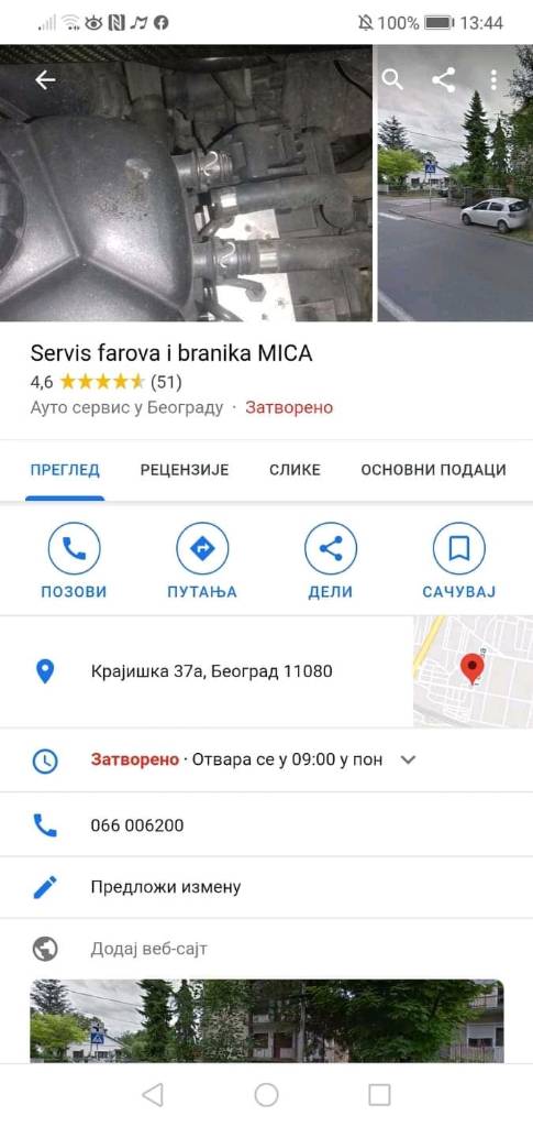

neshtry 19767 Posted April 5, 2020 Evo rešenja, pa nazovi sutra 1 1 Woodoo and neshaoct reacted to this Quote Share this post Link to post Share on other sites
Mishko 1 Posted April 5, 2020 Zahvaljujem mnogo, sutra cu pozvati da vidim moze li se srediti Quote Share this post Link to post Share on other sites
