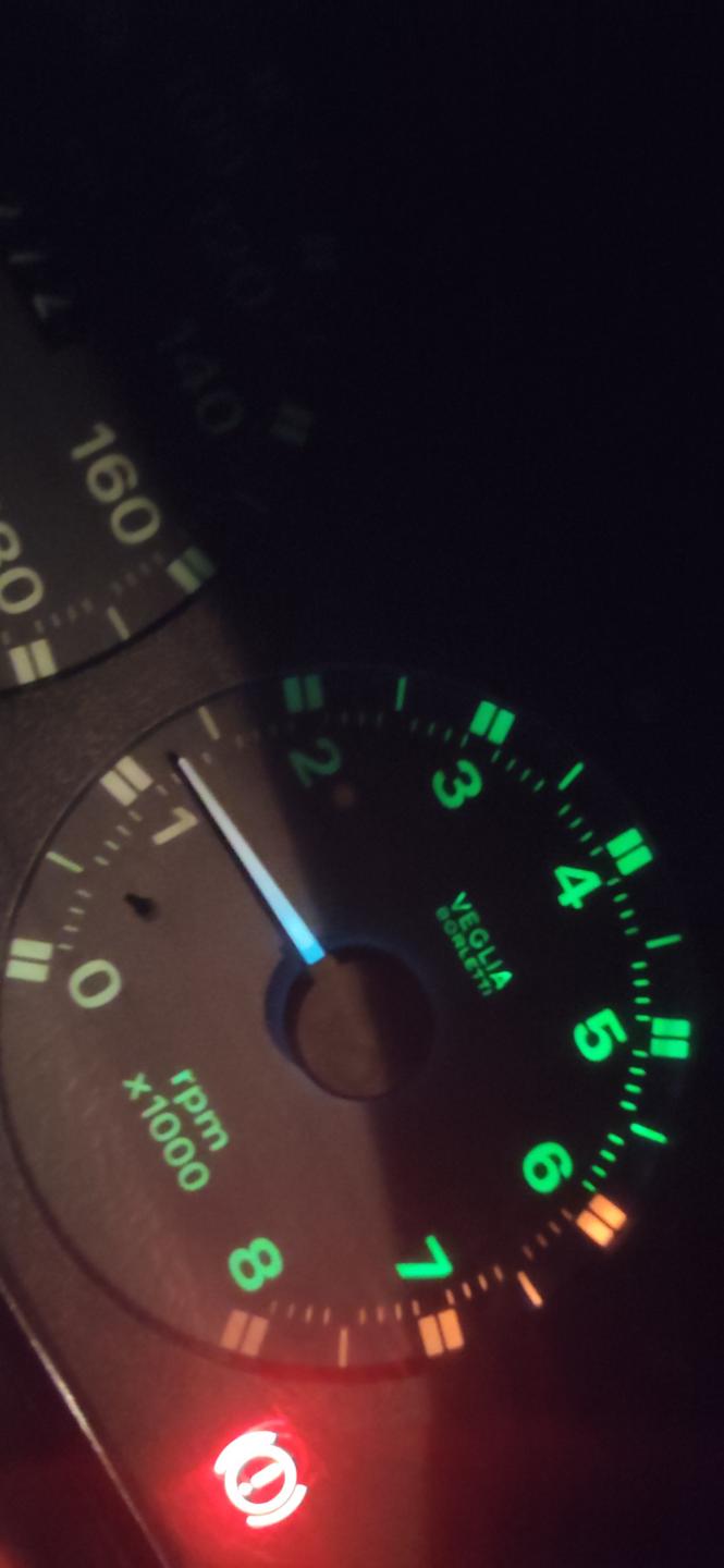

Mukiii 1 Posted November 25, 2021 (edited) Pozdrav drustvo, naime imam problem s puntom mk1 55, prije par dana je poceo da ima problem s ler gasom, nece da se spusti na 800 850 nego radi na 1200 1300 rpm u voznji kad pustim gas i pritisnem kvacilo obrtaji spadnu do 1200 i onda variraju do 2000, mijenjao sam sve senzore u karburatoru, motoric ler gasa itd itd.. Stavljao dva druga karburatora sve isto ne znam vise sta da radim, ako neko zna do cega bi moglo biti bio bih vrlo zahvalan. Lp Edited November 27, 2021 by neshaoct spojeno Quote Share this post Link to post Share on other sites
Zvezdo 1451 Posted November 26, 2021 Lamba sonda možda? Quote Share this post Link to post Share on other sites
Mukiii 1 Posted November 26, 2021 (edited) Rijesen problem, dizna nije bila fino nalegla u leziste i bacala vise goriva nego sto je trebalo. Edited November 27, 2021 by neshaoct formatiranje 1 neshaoct reacted to this Quote Share this post Link to post Share on other sites
