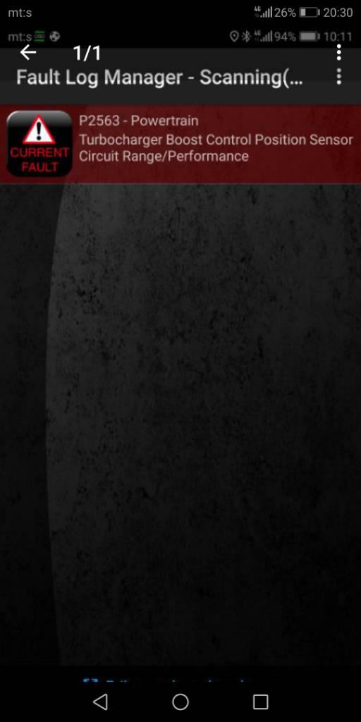

Sulc 85 Posted April 20, 2019 Upalila mi se lampica check engine i izbacuje gresku iz naslova p2563. Auto cas prima gas cas ne kao da neko u naletima nekim iskljuci turbo. Cistio protokomer i map ali ista prica. Neki sa foruma su mi rekli da menjam map senzor. Da li je neko imao slican problem inace auto je fiat bravo 2.0 mjet Ovo izbacuje na dijagnostici Quote Share this post Link to post Share on other sites
neshaoct 9768 Posted April 20, 2019 https://www.obd-codes.com/p2563 https://www.yourmechanic.com/article/p2563-obd-ii-trouble-code-turbocharger-boost-control-position-sensor-circuit-range-performance-by-jay-safford Code P2563 is for the turbocharger boost sensor indicating the vanes are in the incorrect position when the ECM monitors the position at startup of the engine. The buildup of soot can cause the vanes to not move good and bind. 1 horvat reacted to this Quote Share this post Link to post Share on other sites
neshaoct 9768 Posted May 9, 2019 Epilog ovog problema prenet sa druge teme: On 4/22/2019 at 5:22 PM, Sulc said: Curka ulje ispod vakum pumpe na dihtungu i kapalo na crevo od rezervoara vakuma crevo nabubrilo, to je pravilo problem i senzor pozicije turba je vracen na svoje mesto. 8 maja sam zakazao da se predihtuje vakum pumpa pa da se isprati da li ce opet curkati ulje Link 1 horvat reacted to this Quote Share this post Link to post Share on other sites
