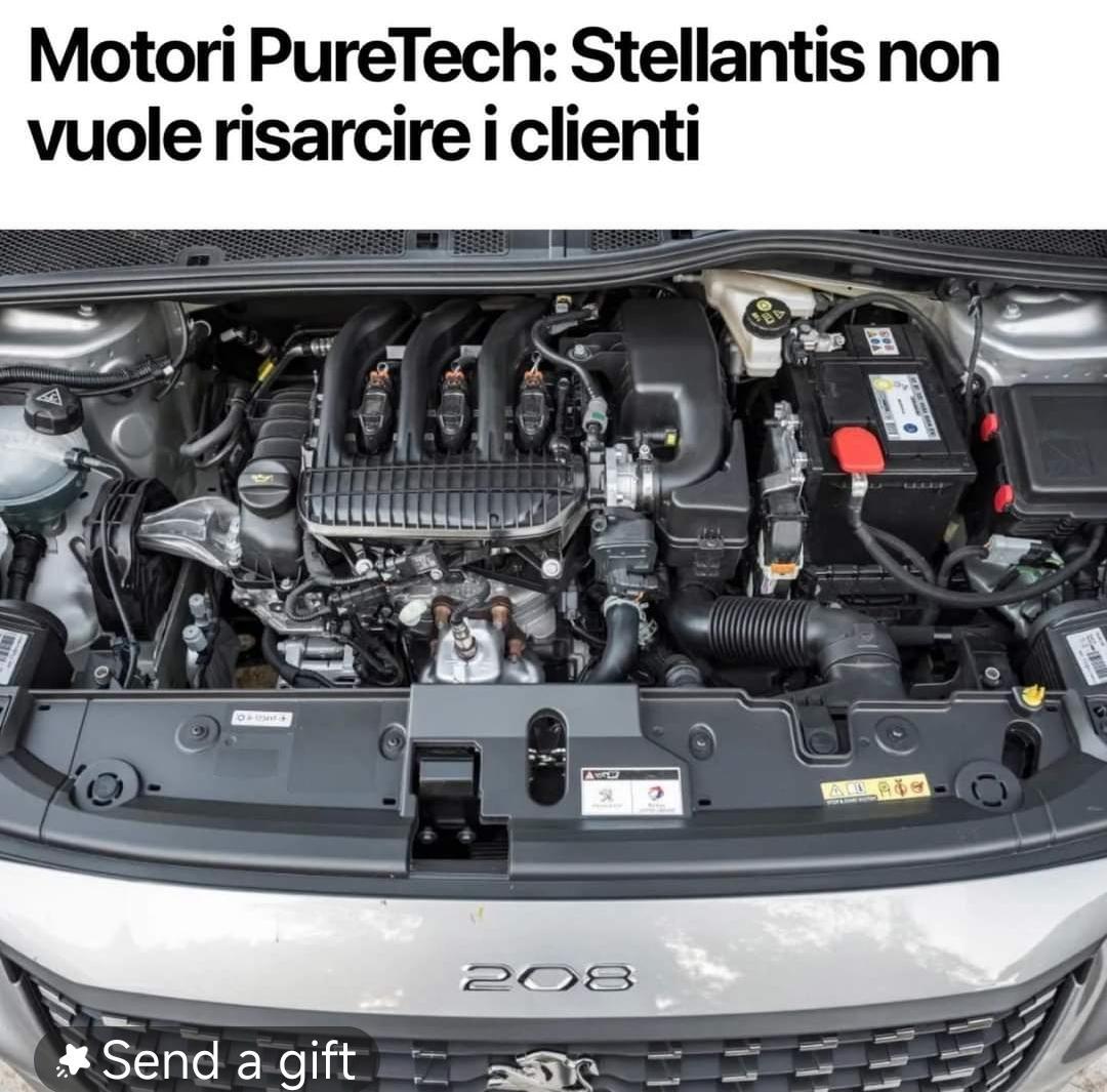

neshtry 21633 Posted June 27, 2024 Italijanski časopis:Nova afera u EU PureTech Motori: Stellantis ne želi kompenzirati kupce Silni ljudi nahebaše Quote Share this post Link to post
knezevic76 9793 Posted June 27, 2024 Zato treba da propadnu, ali može im se, velika su grupacija Sent from my SM-A546E using Tapatalk 1 italiano reacted to this Quote Share this post Link to post
