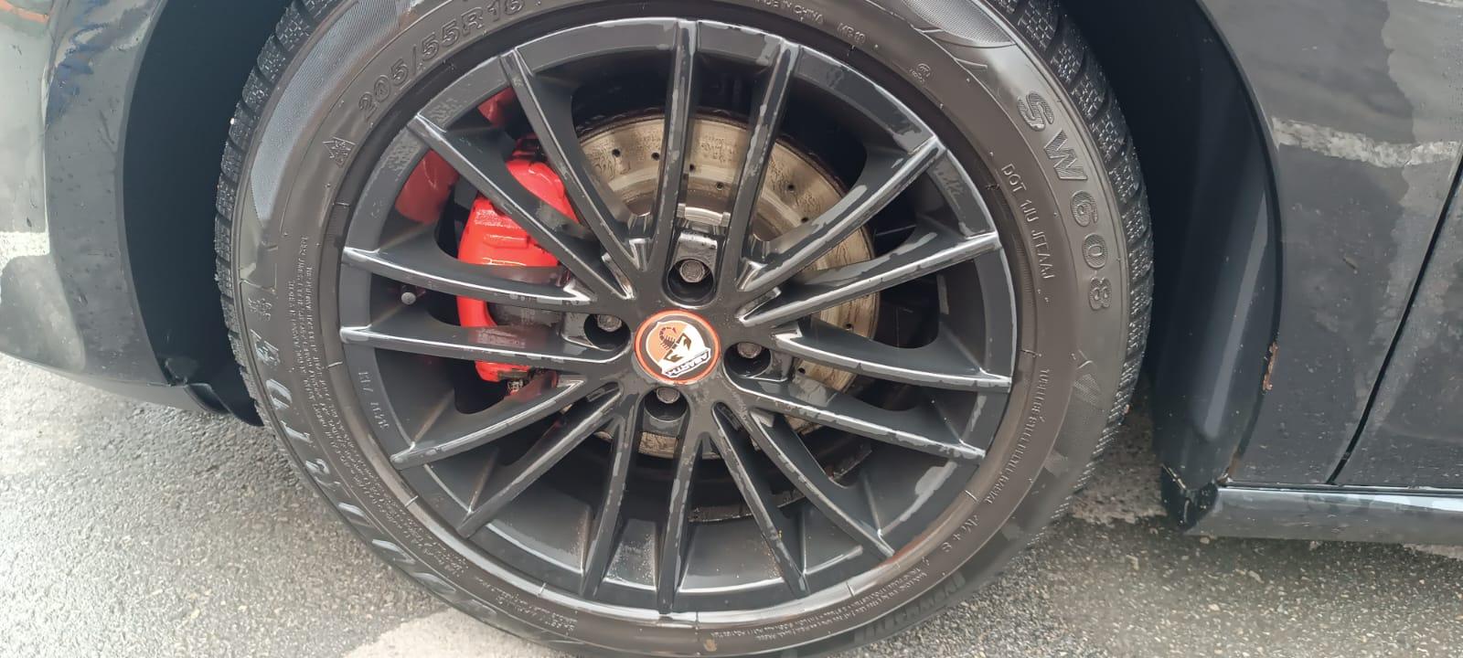

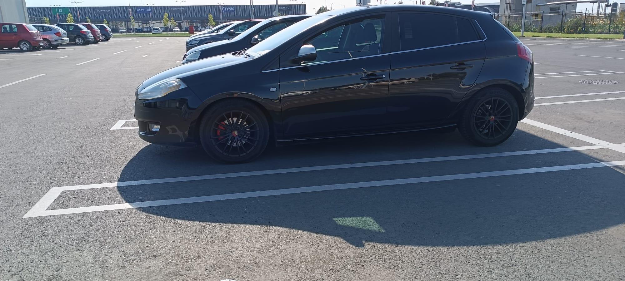

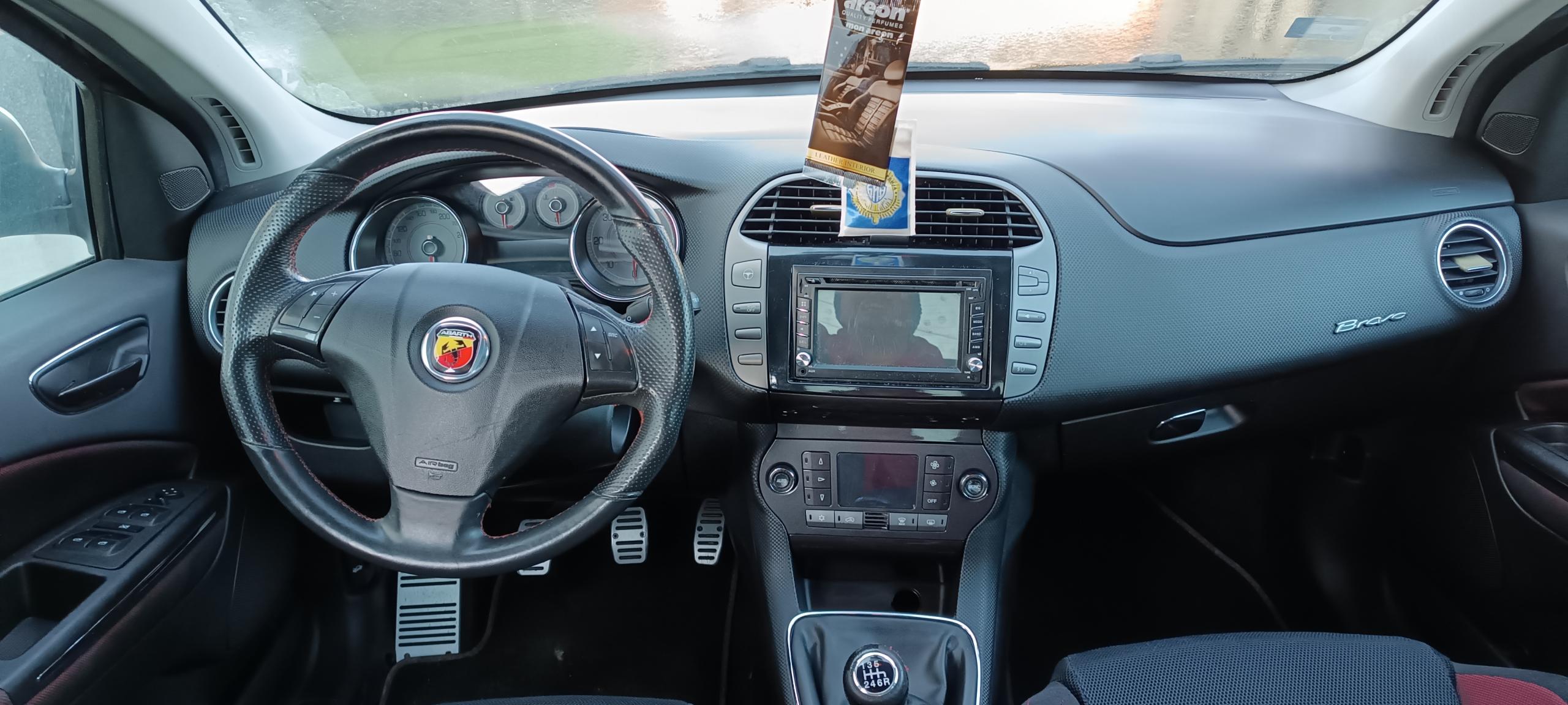

automenr1 21 Posted February 2, 2024 (edited) Cao svima ovo je moj projekat od babe devojku ,u pokusaju .Kupljen u junu sport oprema i sad pokusavam da ga doteram na max. fabrika . Na kraju stage 1 Delovi koji su zamenjeni Set kvacila sa zamajcem Vel servis Turbina remontovana komplet -Radosavljevic Sajle menjaca Alnaser remontovan Alternator remontovan Opruge nove Kyb standardne.. Creva interkulera-Indjija Top Spider Ugasen Egr Dubinsko uradjeno Farovi polirani Svasta jos ce se raditi... Usisna grana sledi... Edited February 2, 2024 by automenr1 11 MiloshBg, ISV_01, Ivan-Topola and 8 others reacted to this Quote Share this post Link to post Share on other sites

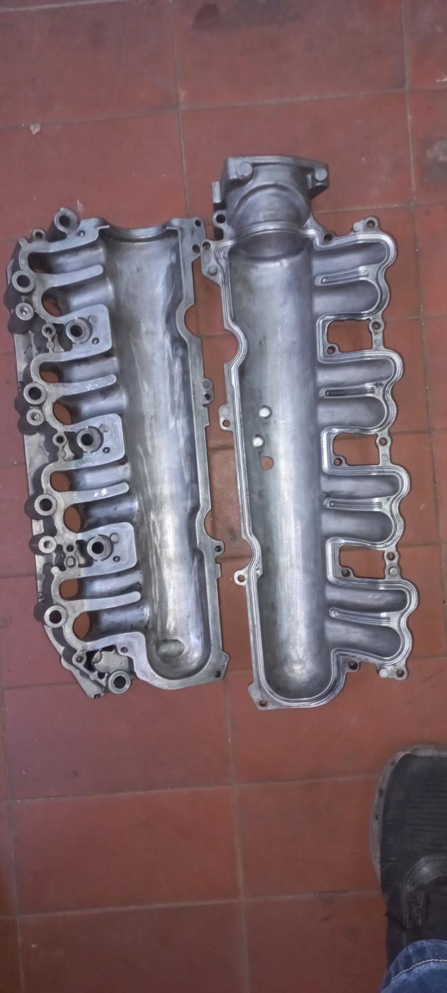

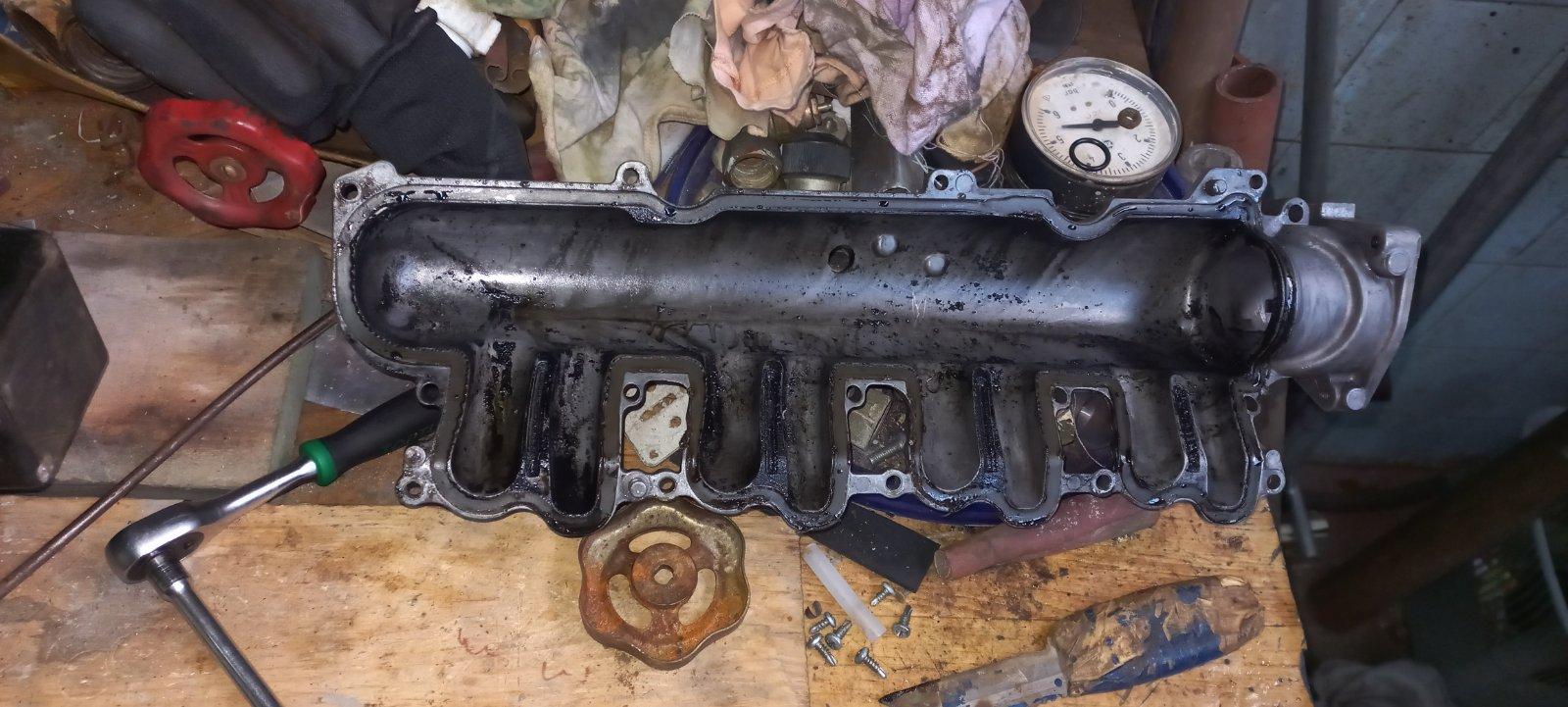

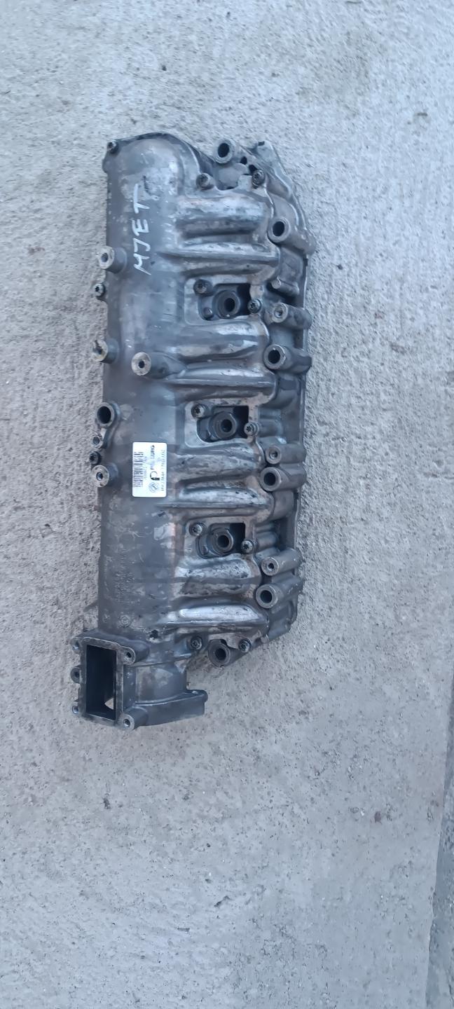

automenr1 21 Posted February 3, 2024 (edited) Ovaj model Brava 2008 pa i kasnije god ima plasticnu usisnu koja je problematicna ,prelazak na alu najbolje resenje. Ono sto se treba skinuti i baciti je elektromotor klapni i ugasiti da ne pali gresku. Kupljena usisna grana fabricki bez klapni polovna od euro 3 motora 16v, isla na modele 136,140,150 konja Alfa ,Fiat a vrvt i na Opele . Ociscenja i sledi ugradnja . Edited February 3, 2024 by automenr1 5 shuxx, city, Milutinac and 2 others reacted to this Quote Share this post Link to post Share on other sites

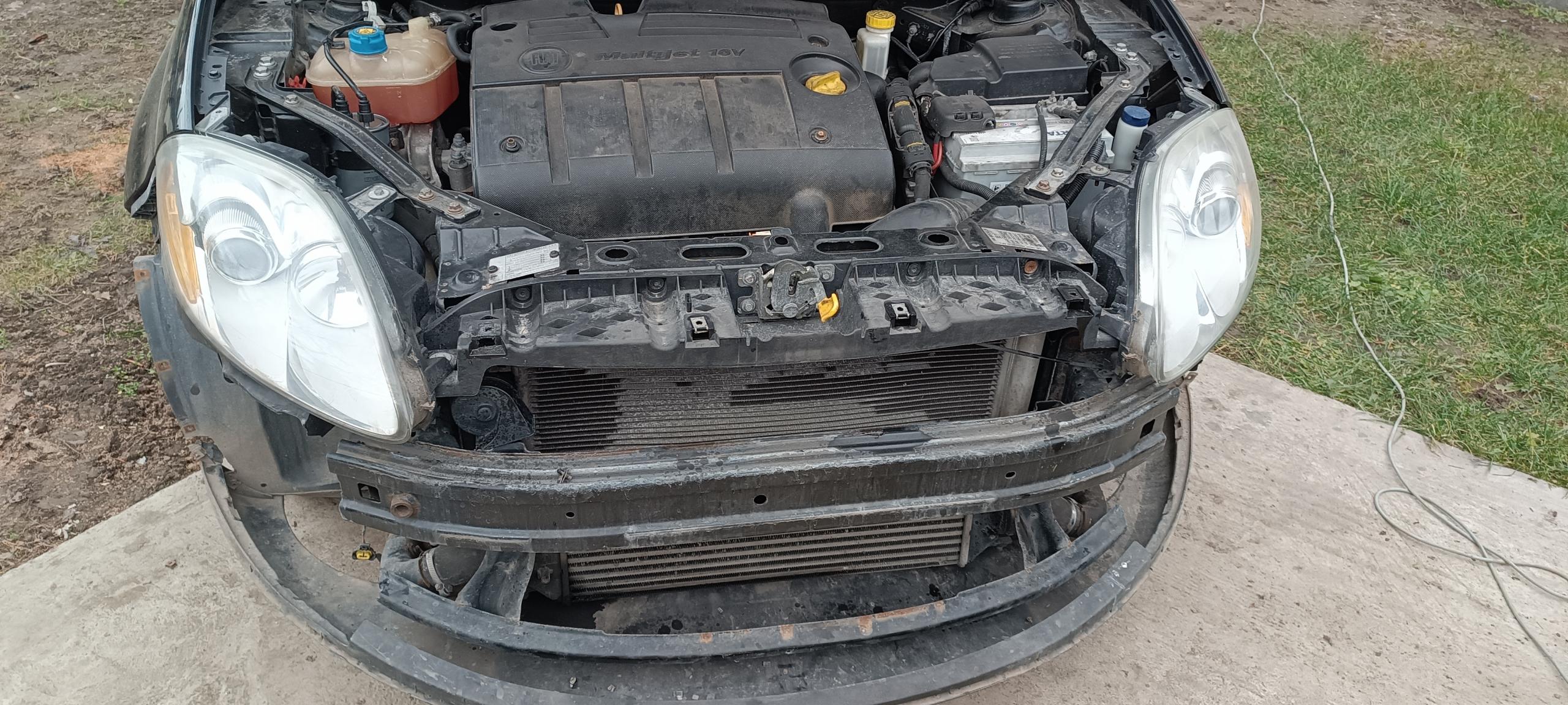

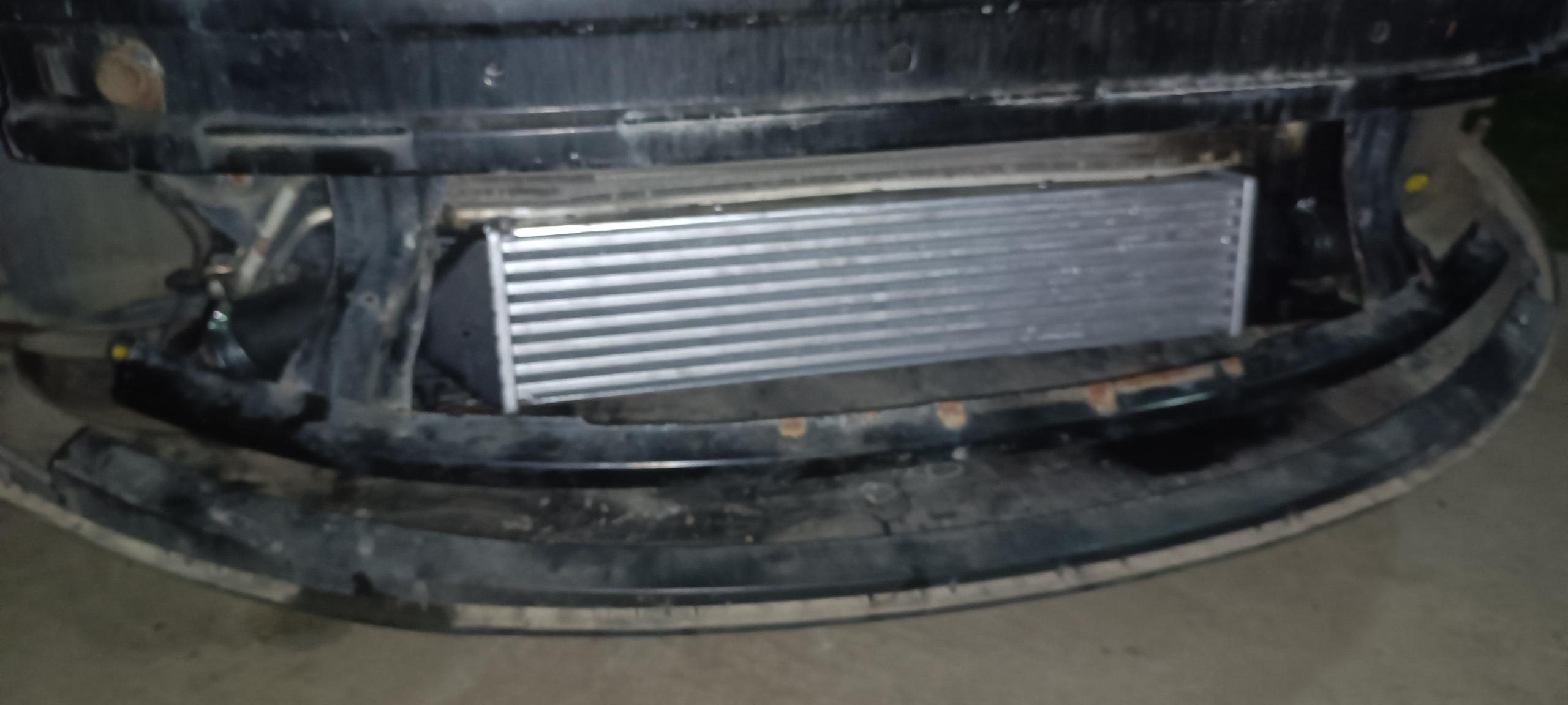

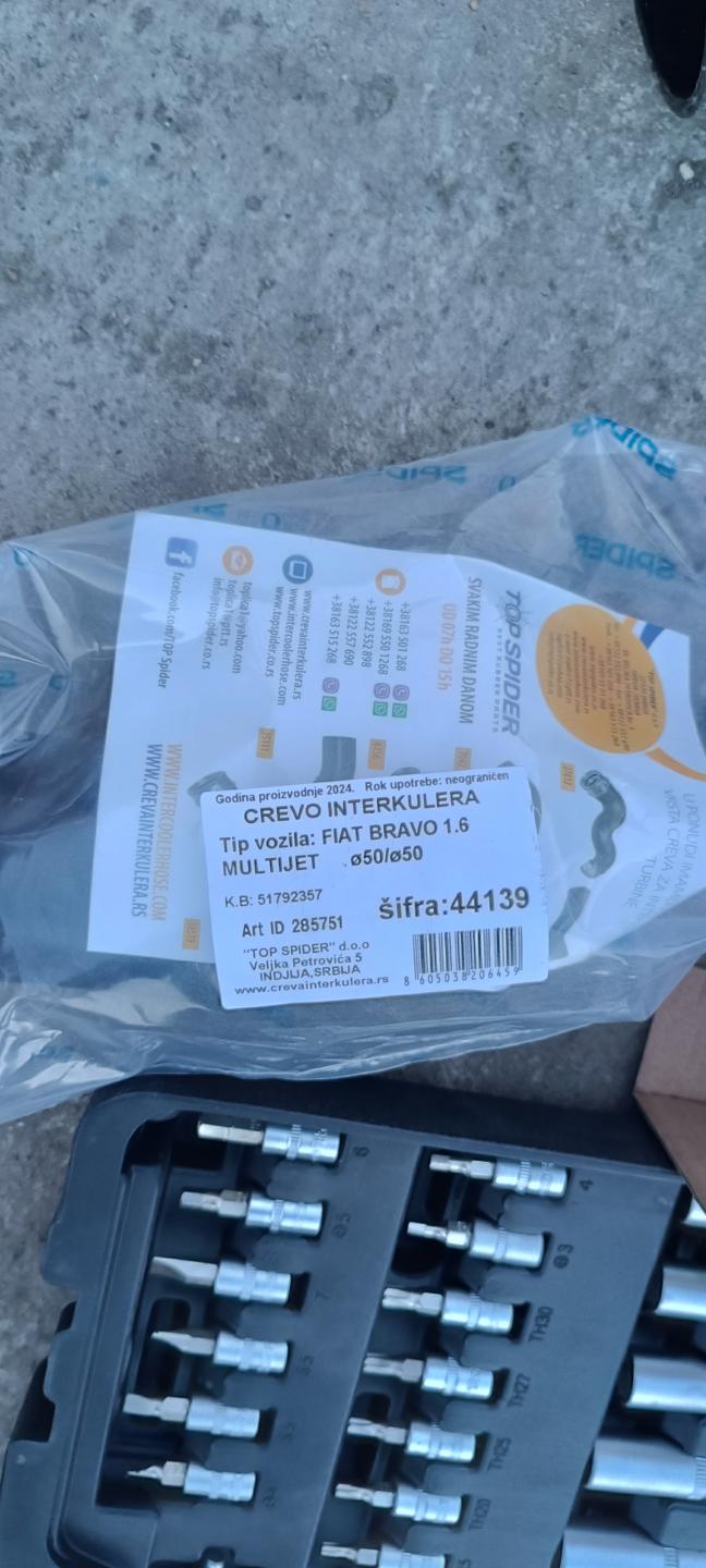

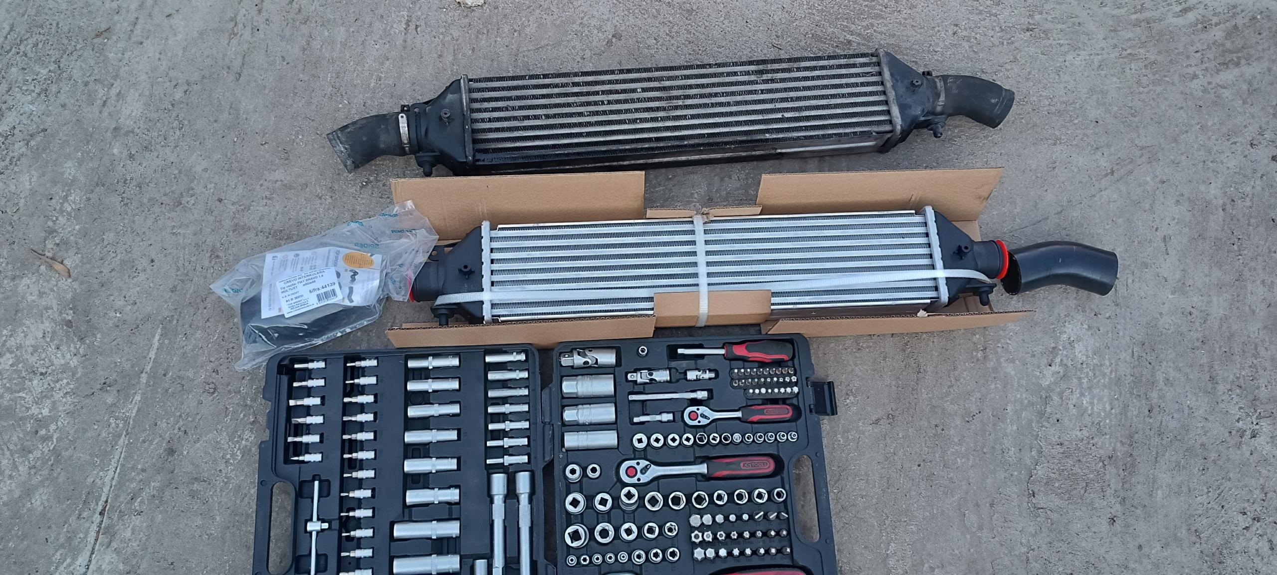

automenr1 21 Posted February 8, 2024 (edited) Dosao na red interkuler ... NRF holandski Zanimljivo je da pase sraf na sraf od 2.0mjtd 165konja Ali trebaju veca creva koja idu na interkuler ,precnika 57mm i s druge strane 51mm, naravno s obe strane interkulera Edited February 8, 2024 by automenr1 3 city, shuxx and Milutinac reacted to this Quote Share this post Link to post Share on other sites

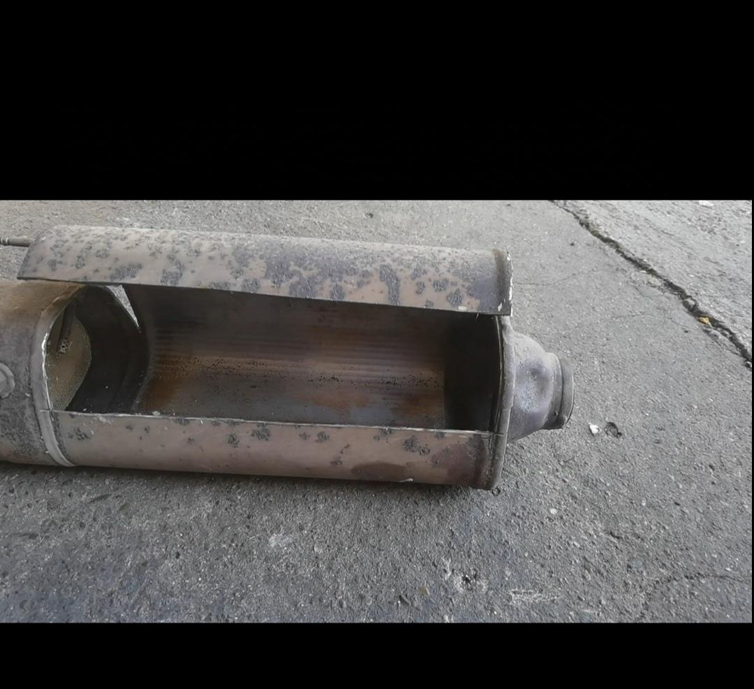

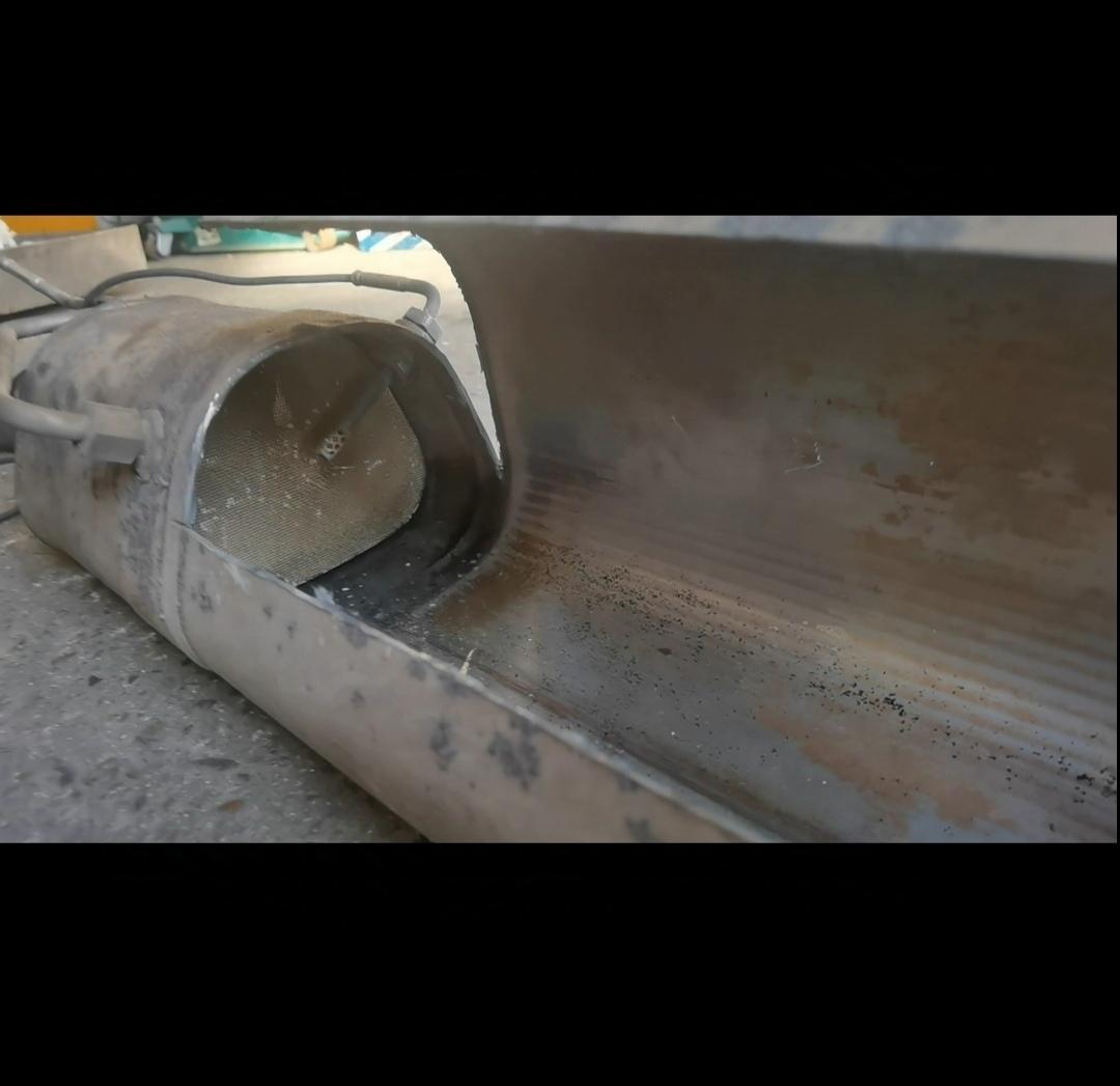

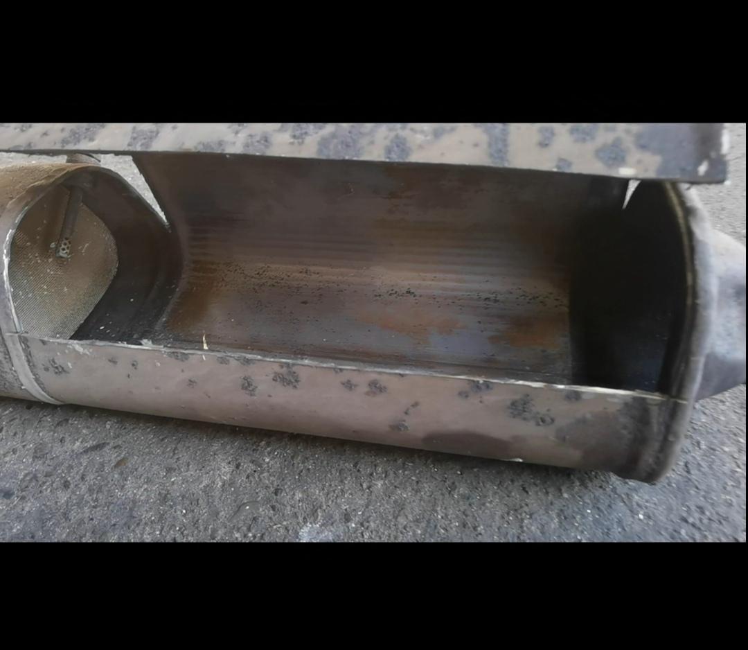

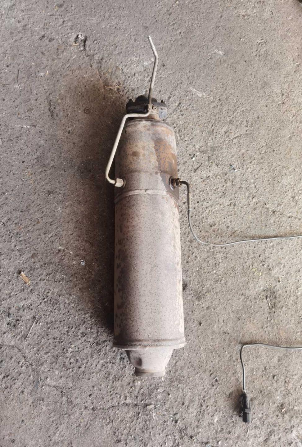

automen 2 Posted November 1, 2024 (edited) Sta kazete ako se izvadi dpf tj saće i zavari opet lonac...Oce li biti bučan auto ...ima li ko iskustva ...? Edited November 1, 2024 by automen Quote Share this post Link to post Share on other sites
automen 2 Posted November 1, 2024 2 hours ago, darkman14 said: Nece Sutra ga tako radim,pa cemo videti rezultate,.. Samo na punom gasu da se ne dere... Quote Share this post Link to post Share on other sites
automen 2 Posted November 2, 2024 Izvuceno saće ,nije bucan mnogo nakon toga. 1 werp690 reacted to this Quote Share this post Link to post Share on other sites
werp690 932 Posted November 2, 2024 Ala ga je lepo isekao,( nisam sarkastican ) kao hirurg.... Steta sto nema i slika vara, mada ne sumnjam da je i to precizno. Quote Share this post Link to post Share on other sites
automen 2 Posted November 2, 2024 Odradio je i varenje lepo,video sam nije slikano..sad gasenje elektronski.. Quote Share this post Link to post Share on other sites
