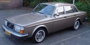

Milutinac 5602 Posted March 22 (edited) Nardo Grey - Na guglu nema 244 u nardo, ali evo ga 240 Opasno deluje Edited March 22 by Milutinac 2 Bingodalton and PremieRacing reacted to this Quote Share this post Link to post Share on other sites
OMP 1135 Posted March 22 dobra je to boja u kombinaciji sa crnim detaljima na mnogim kolima fino izgleda 3 PremieRacing, Milutinac and Bingodalton reacted to this Quote Share this post Link to post Share on other sites
francuz69 796 Posted March 22 Jes, doduse ovaj je napucan na sport mode, ja sam imao malo drugaciji koncept u glavi. Ali svakako mu stoji. 1 PremieRacing reacted to this Quote Share this post Link to post Share on other sites
PremieRacing 4167 Posted March 22 (edited) Sve ste u pravu, al' moj je napucan hromom... sa crnim detaljima izgleda vrhunski, sumnjam da bi moj ispao tako dobro 2 hours ago, Milutinac said: Na guglu nema 244 u nardo, ali evo ga 240 To je to, samo novije... posle 80 i neke su prestali sa krajnjim oznakama broja vrata pa su i kupe, i limo i kobasičar bili 240. Do tada je 242 bio Coupe, 244 limuzina a 245 karavan. Edited March 22 by PremieRacing 1 Milutinac reacted to this Quote Share this post Link to post Share on other sites
francuz69 796 Posted March 22 (edited) Nije to taj model i nije to ta boja, ali sam vise mislio u ovako nekom pravcu. Mada... meni se cini da si se vec odlucio za tu neku crveno/bordo metalik. Sto je odlicno, tako da zanemari ovu sivu. Edited March 22 by francuz69 1 PremieRacing reacted to this Quote Share this post Link to post Share on other sites

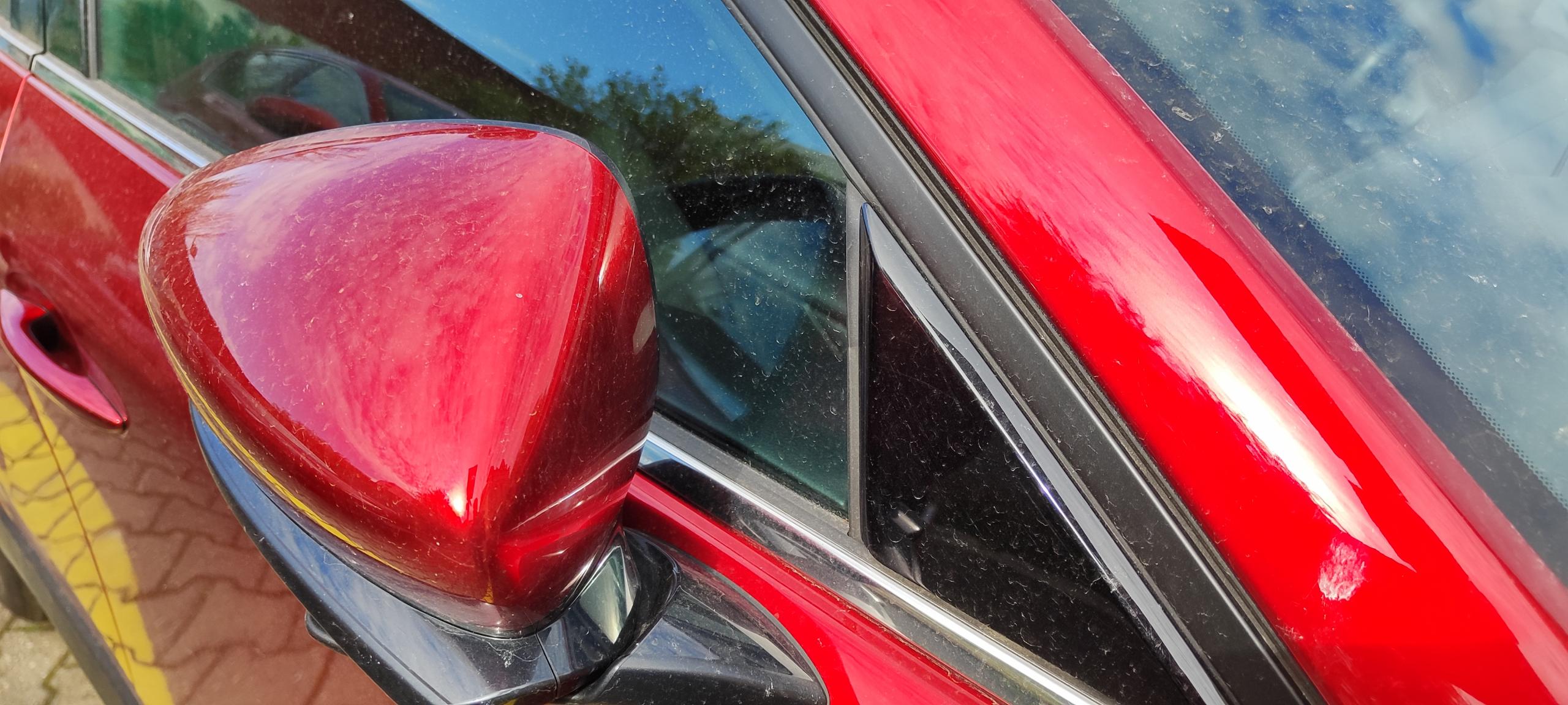

PremieRacing 4167 Posted March 31 (edited) Ovih dana ulazi u komoru... i deff ide Mazda soul red cristal: Edited March 31 by PremieRacing 6 Lufti, OMP, moron and 3 others reacted to this Quote Share this post Link to post Share on other sites

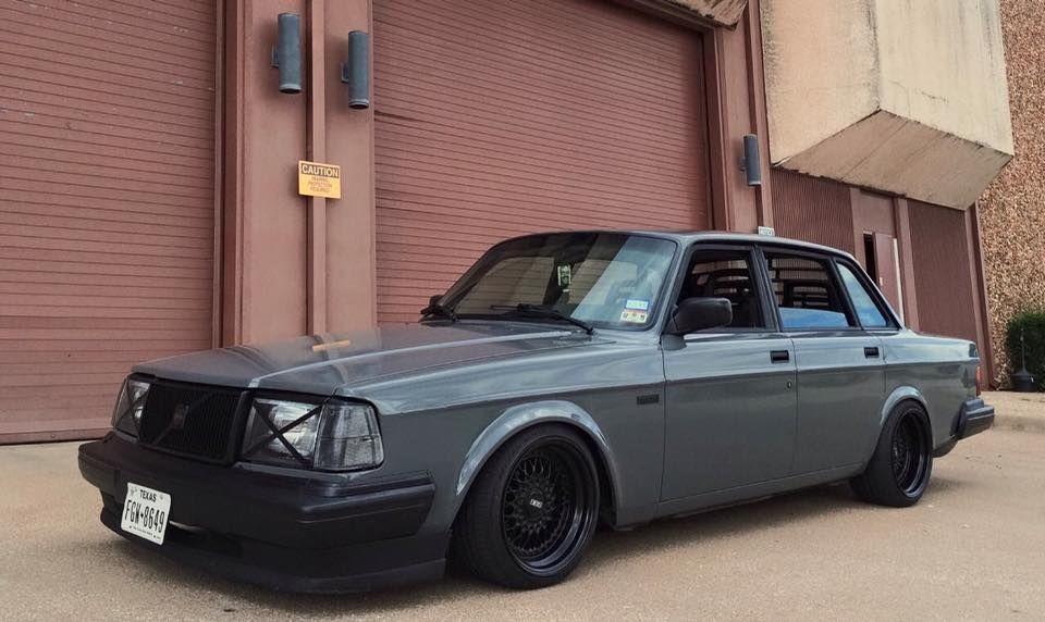

neshtry 10956 Posted April 1 (edited) Ideja… >>>>Volvo 242 gt <<<< Edited April 1 by neshtry 1 PremieRacing reacted to this Quote Share this post Link to post Share on other sites

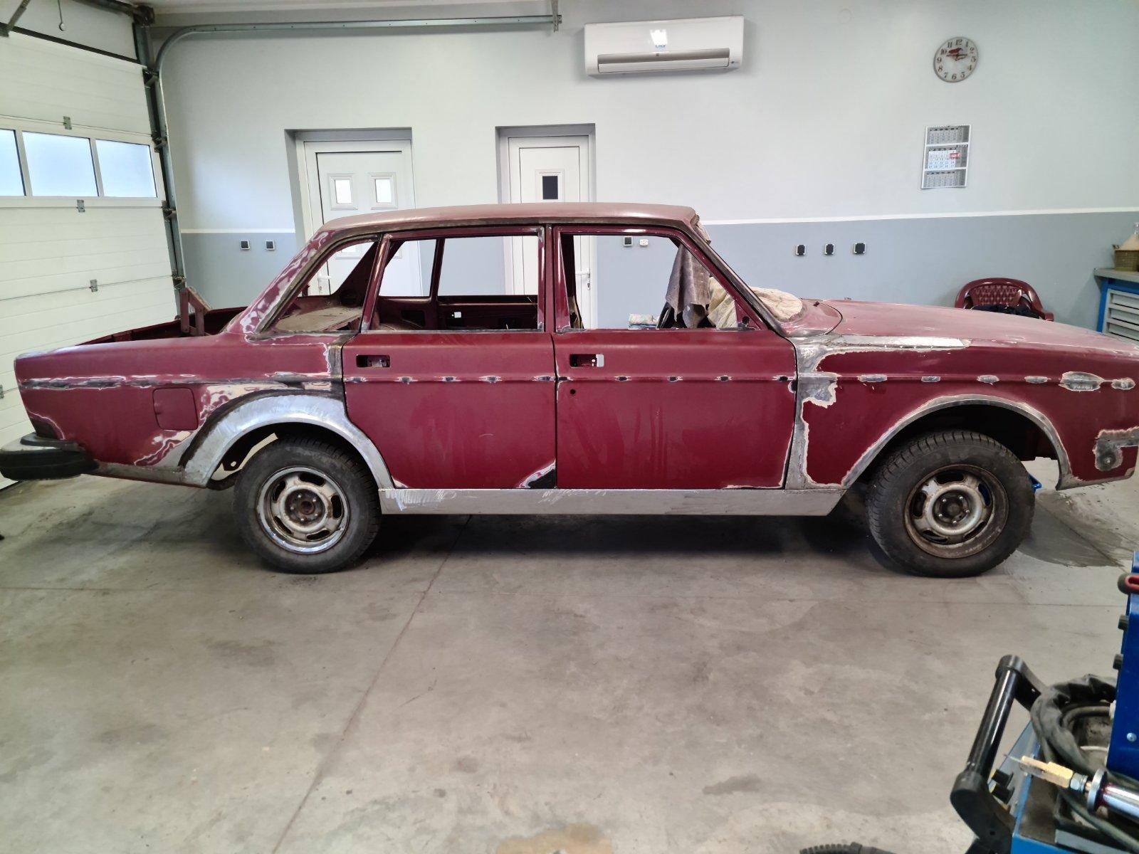

moron 2979 Posted April 1 On 3/11/2023 at 5:36 PM, PremieRacing said: Napreduje... Gde mu je pozadi nestao "bunker" za rezervni točak, onaj "polumesec" ka dole, iza zadnjeg točka ? Ti si to malo "pojednostavnio" dizajn ? Mislim da si malo izmenio i oblik "čela" sajtne odmah iza pradnje točka ? Neznatno. 1 PremieRacing reacted to this Quote Share this post Link to post Share on other sites
PremieRacing 4167 Posted April 2 On 4/1/2023 at 3:11 PM, neshtry said: Ideja… >>>>Volvo 242 gt <<<< i to ne samo jedna... Za boju nikako pošto sam rešen da sačuvam tamno crvenu iz razloga što mu na pločici piše boja pa se krećem samo u okviru nijansi i načina farbanja, ali zato gomila dobrih stvari sa gt ide i kod mene. Volan mi je vrh! Tražim način da modifikujem moj da izgleda ovako...blizu sam. Crno nebo kad-tad. Satovi idu ovako kad budem radio nešto na motoru u narednom periodu. A ova pin stripe me jaaaako kopka za sad i odma' 21 hours ago, moron said: Gde mu je pozadi nestao "bunker" za rezervni točak, onaj "polumesec" ka dole, iza zadnjeg točka ? Ti si to malo "pojednostavnio" dizajn ? Mislim da si malo izmenio i oblik "čela" sajtne odmah iza pradnje točka ? Neznatno. Oštro oko morolovo (moron-sokolovo) Ti bunkeri su im deff trademark ali i glavna mana...boljka modela. Meni se nikako ne sviđaju pošto mi auto izgleda kao usran, kao pelena puna govana te sam išao na 'bunker delete' A pragovi (sajtne) su maaaaalkice dublji od fabričkih pa je i linija iza prednjeg točka izmenjena. Ne samo čelo, već i linija praga. Fabrički se sajtna završava sa prednjim vratima a prednje krilo se spušta do dole, a mi smo skratili krilo i produžili sajtnu do prednjeg točka. Meni se ovako mnogo više sviđa. Quote Share this post Link to post Share on other sites
moron 2979 Posted April 2 "Polumesec" je fabrički bio farban u mat crnu boju. Sa razlogom Da, znam kakav je tačno bio oblik i dizajn prednjih krila u donjoj zoni i kako su ona bila uzdužno profilisana u visini sajtni / pragova. Veruj da mi je i danas sve to u glavi i pred očima. Bolest, pa to ti je Srećan nastavak radova ! Quote Share this post Link to post Share on other sites
