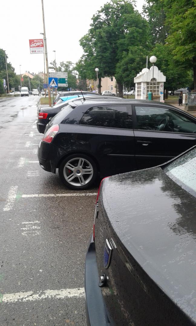

BaneJ 332 Posted April 13, 2021 Staviš ovakve točkove, sa malim distancerima kao na lici i ništa više. 4 Mijailović P., Nenad-sone, darkman14 and 1 other reacted to this Quote Share this post Link to post Share on other sites
