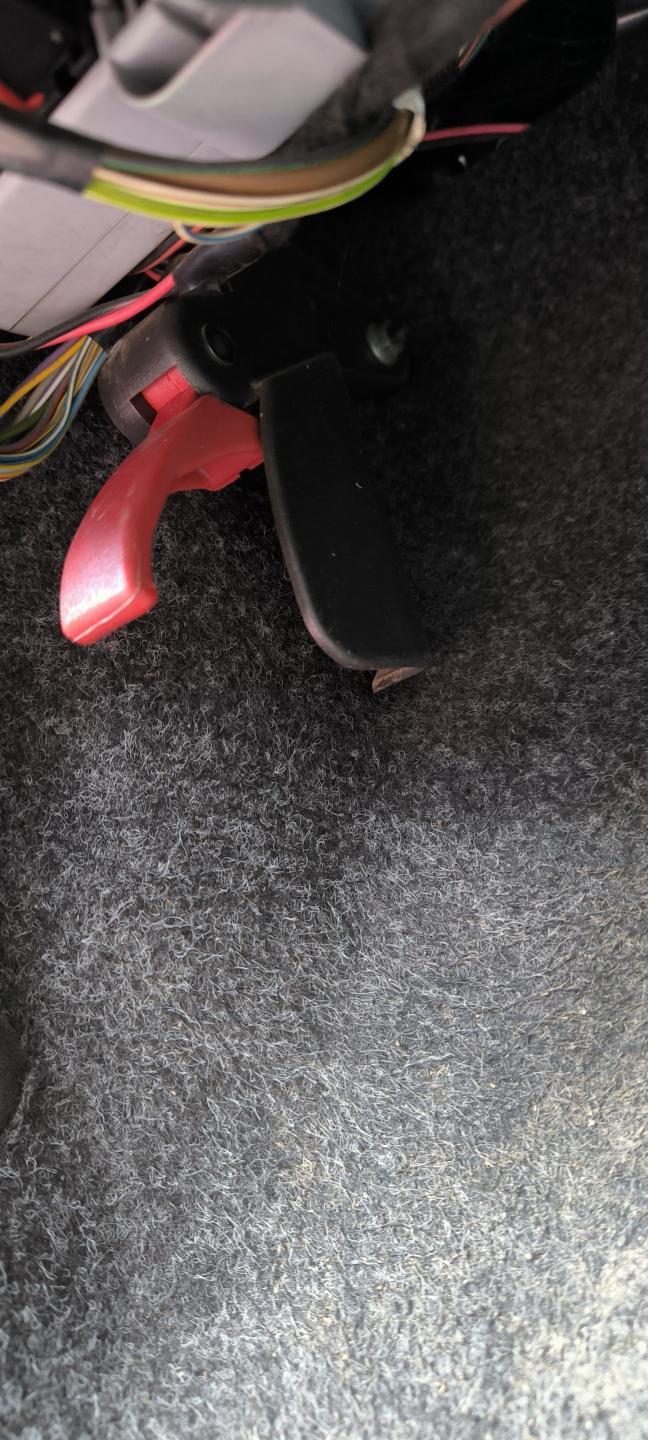

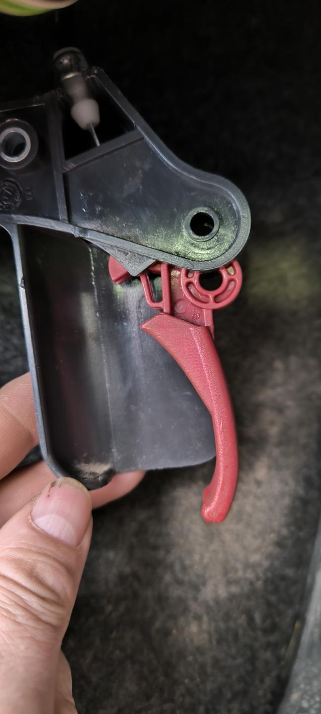

shuxx 19340 Posted January 19, 2025 Kako si je otvorio? Quote Share this post Link to post Share on other sites
neshtry 21174 Posted January 19, 2025 Ne mogu,mora na lift dizalicu ,pa od dole se uhvati blizu brave i povuče da se otvori... nervozan posao.... Sutra idem kod majstora @shuxx 1 shuxx reacted to this Quote Share this post Link to post Share on other sites
shuxx 19340 Posted January 26, 2025 šta napravi sa sajlom haube Quote Share this post Link to post Share on other sites
neshtry 21174 Posted January 27, 2025 Samo se istrgla,od starosti....2h im trebalo da je otvore,jer sam ja mislio da je pukla kod brave na haubi ,pa sam ih loše naveo...da su znali da je samo razvučena, uhvatili bi je na nekom dostupnom mestu i povukli bi je za otvaranje,ovako su se mučili da otvore bravu odozdo.... To sam privremeno rešio,dok ne nabavim sajlu,ali su mi rešili curenje ulja iz menjača i sada mi radi ABS.Zahebano bez ABS po vlažnom,klizavom kolovozu... Quote Share this post Link to post Share on other sites

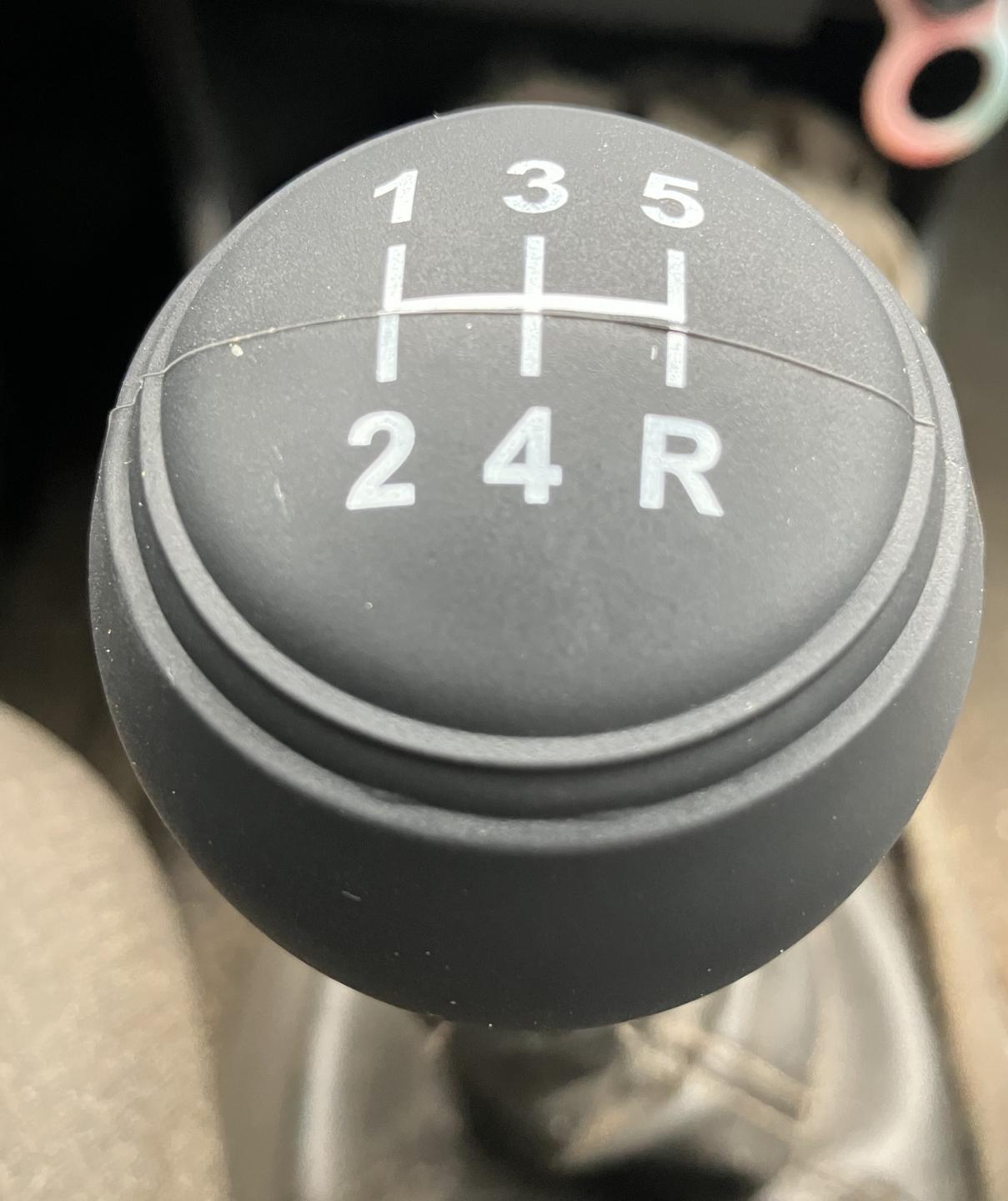

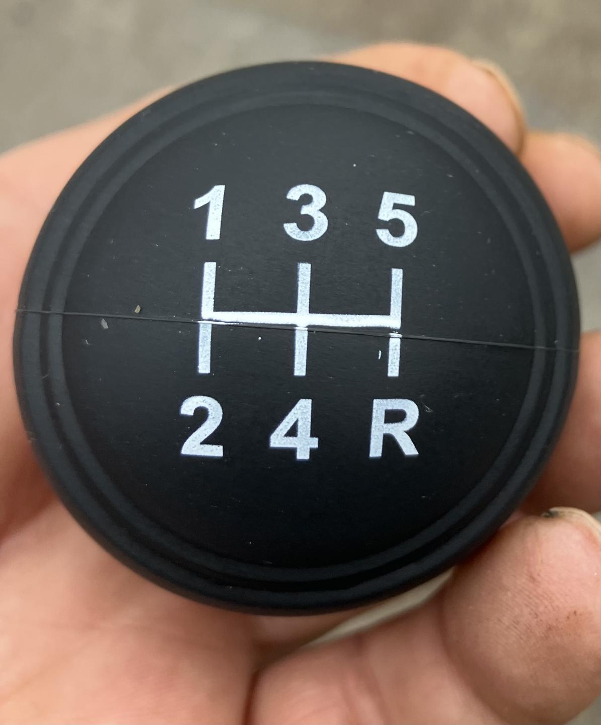

neshtry 21174 Posted January 31, 2025 movina, namestio sam silikonsku oblogu na menjač... nikakva prednost bar nije skupa Quote Share this post Link to post Share on other sites
shuxx 19340 Posted January 31, 2025 Zar ti nije to meko pod rukom. Kakav je osećaj. Gde uze, cena ? Quote Share this post Link to post Share on other sites
neshtry 21174 Posted January 31, 2025 (edited) Silikon ko silikon,malko bolje trenje i to je to Ovde https://a.aliexpress.com/_EwKbCRa Edited January 31, 2025 by neshtry Quote Share this post Link to post Share on other sites

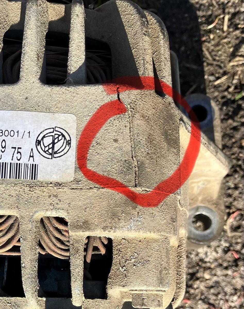

neshtry 21174 Posted February 4, 2025 Evo zbog ove pukotine mi alternator nije radio kako treba,pa nije dovoljno dopunjavao akumulator... 1 stex_pb reacted to this Quote Share this post Link to post Share on other sites
shuxx 19340 Posted February 4, 2025 kako to naprsnuće utiče na loš rad alternatora, nije mi jasno, oslobodili se ležajevi...ili Quote Share this post Link to post Share on other sites
neshtry 21174 Posted February 4, 2025 Da, nema dobar kontakt... tako mi je majstor objasnio... hteo da uzme,da ga sredi,pa video napukline i odustao...ja pitam zašto,on kaže zbog toga ih 90% na Puntu i ne radi kako treba,q skloni su pucanju Quote Share this post Link to post Share on other sites
MiloshBg 2337 Posted February 4, 2025 Standardna boljka kod puntica. Mislim i da GP ume bolovati od istog problema. 3 Reacher Gilt, Axic and neshtry reacted to this Quote Share this post Link to post Share on other sites
shuxx 19340 Posted February 4, 2025 meni to nije jasno, kućište naprslo,a alt ne radi kako treba... baš mi nije jasno....zaštoooo 1 neshtry reacted to this Quote Share this post Link to post Share on other sites
neshtry 21174 Posted February 5, 2025 Neće ni da se okrene,od kada je skinut... Jedna zadnja slika 1 nemanja84bg reacted to this Quote Share this post Link to post Share on other sites
Zvezdo 1500 Posted February 5, 2025 14 hours ago, neshtry said: Evo zbog ove pukotine mi alternator nije radio kako treba,pa nije dovoljno dopunjavao akumulator... To je boljka za koju svi prodavci znaju još od Punta Mk1! 1 neshtry reacted to this Quote Share this post Link to post Share on other sites

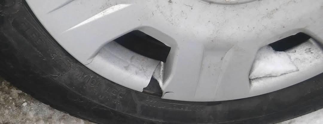

neshtry 21174 Posted March 4, 2025 Rezultati udarne rupe... Ovo je moj primer na jedno~ 24km/h! Quote Share this post Link to post Share on other sites
shuxx 19340 Posted March 4, 2025 Da nije guma bila meka? Pritisak u gumi? Briga te, šta da je bila Alu... Koja bi tad bila šteta 1 neshtry reacted to this Quote Share this post Link to post Share on other sites
