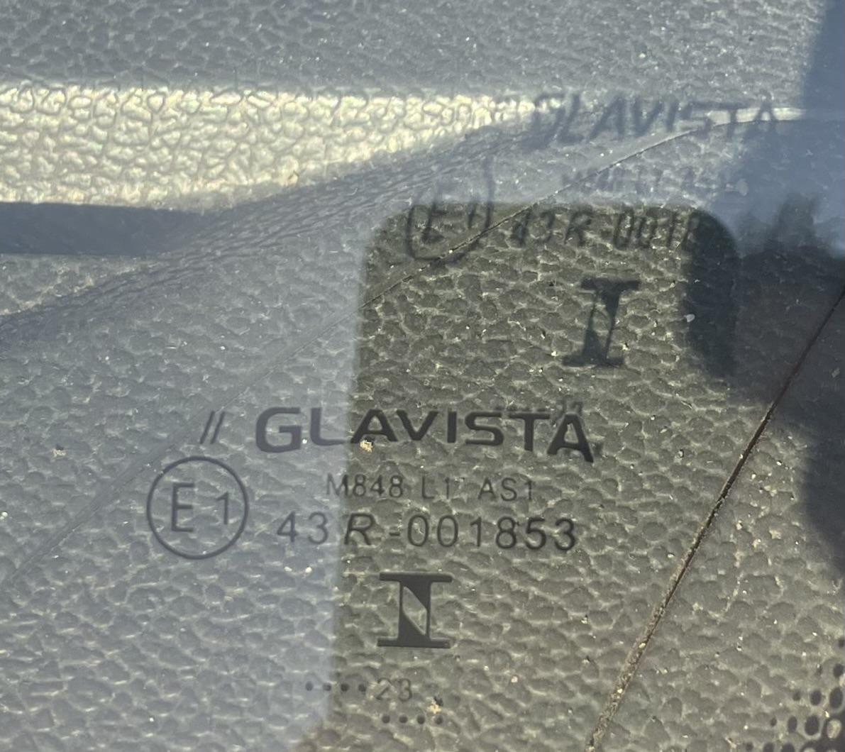

neshtry 21511 Posted September 20, 2024 Stavena danas nova šajbna,15400 rsd Brend Glavista... 2 Djuk85 and shuxx reacted to this Quote Share this post Link to post Share on other sites

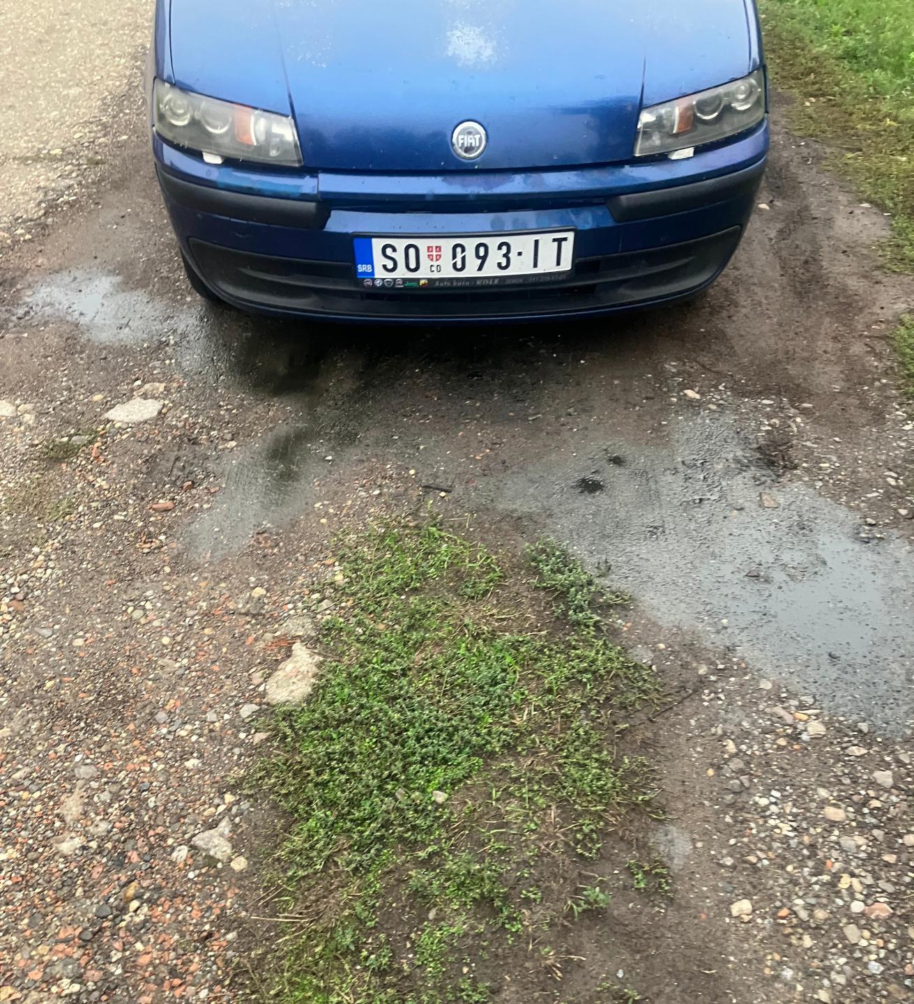

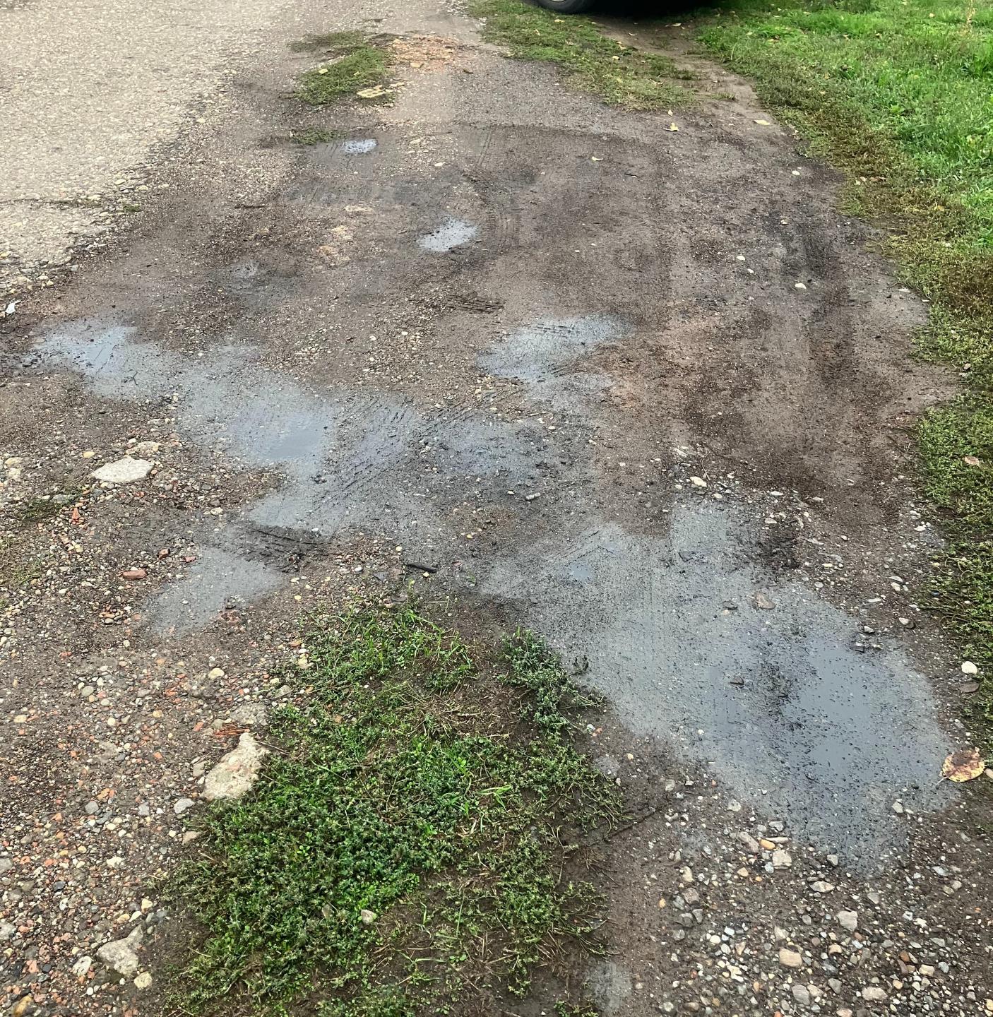

neshtry 21511 Posted October 5, 2024 (edited) Ovo sam jutros zatekao... ulje iz menjača... kako, zašto,gde, nemam pojma... Uvek neko biiip pred tehnički,u pm Edited October 5, 2024 by neshtry Quote Share this post Link to post Share on other sites
parkvets 39 Posted October 5, 2024 52 minutes ago, neshtry said: Ovo sam jutros zatekao... ulje iz menjača... kako, zašto,gde, nemam pojma... Uvek neko biiip pred tehnički,u pm Ako ništa drugo dobro je što je stajao,na firminom prošlom Puntu u toku vožnje iscurelo,kolega baš nije tehnički vičan i ode menjač (doduše imao je i preko 300k) 1 shuxx reacted to this Quote Share this post Link to post Share on other sites
neshtry 21511 Posted October 5, 2024 Zbog čega jel se sećaš uzroka Quote Share this post Link to post Share on other sites
shuxx 20258 Posted October 5, 2024 Vidi li se gde je iscurelo? Barem je menjac dubok, zadrzava ulje. Sve moze da izadje samo na onom cepu za ispustanje ulja. Ili gresim...? Quote Share this post Link to post Share on other sites
neshtry 21511 Posted October 5, 2024 To mi i majstor kaže,čekam da oslobodi lift- dizalicu,pa da vidimo šta je... Prošli put kada smo menjali difolt ulje u menjaču,bilo 3dl u menjaču , a nisam znao i vozio ga tako... Quote Share this post Link to post Share on other sites
shuxx 20258 Posted October 5, 2024 Bese oko 1.5L ulja u menjacu? Quote Share this post Link to post Share on other sites

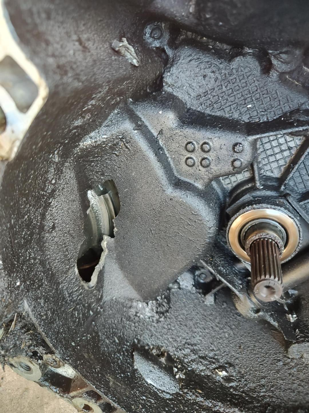

neshtry 21511 Posted October 5, 2024 1,5L sea 85w75 nego,rupa u menjaču,poluosovina desnog točka se uzhebala pri skretanju i roknula neke zupčanike u zid menjača i probila rupu... mora ceo menjač da se promeni Quote Share this post Link to post Share on other sites

shuxx 20258 Posted October 5, 2024 Fuck. Kakav je to udarac bio. Zar nisi osetio. Los put? Kamenje ili sta vec.. I kad ti se to desilo... 1 neshtry reacted to this Quote Share this post Link to post Share on other sites
Mijailović P. 3787 Posted October 5, 2024 Zakok'o ležaj, definitivno, pa počupao sve... 2 alfini0507 and neshtry reacted to this Quote Share this post Link to post Share on other sites
shuxx 20258 Posted October 5, 2024 2 minutes ago, Mijailović P. said: Zakok'o ležaj, definitivno, pa počupao sve... Zar to moze da se desi. Koji lezaj to noze da napravi 1 neshtry reacted to this Quote Share this post Link to post Share on other sites
Axic 23718 Posted October 5, 2024 51 minutes ago, shuxx said: Zar to moze da se desi. Koji lezaj to noze da napravi Čim ostane suv bez masti i podmazivanja prvo krene da zuji i da te upozori, tad je znak da moraš čim pre da menjaš inače očekuj što kaže @Mijailović P. da zakove i napravi haos. 2 shuxx and neshtry reacted to this Quote Share this post Link to post Share on other sites
Mijailović P. 3787 Posted October 5, 2024 1 hour ago, shuxx said: Koji lezaj to noze da napravi Svaki. 2 MS PK and Axic reacted to this Quote Share this post Link to post Share on other sites

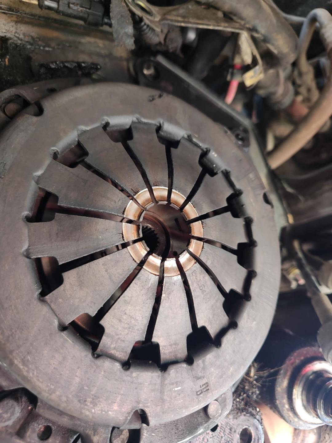

neshtry 21511 Posted October 15, 2024 (edited) Rešen menjač Menjač polovan 5800 Poštarina 2450 Ruke 7000 Korpa kvačila ( polovna,kao nova) 1000 Evo i nekih fotki šta smo zatekli Edited October 15, 2024 by Ivan Sredjene slike 2 Ivan and Zan Batist reacted to this Quote Share this post Link to post Share on other sites

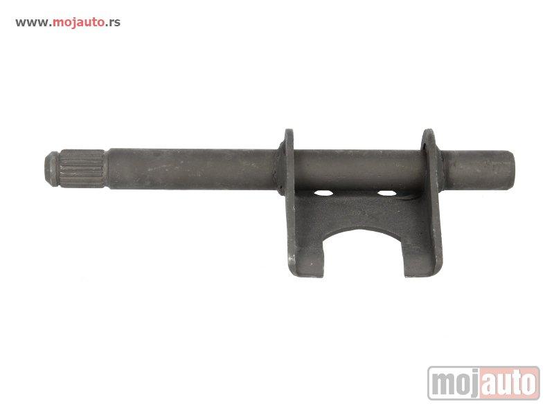

Axic 23718 Posted October 15, 2024 (edited) Šta ja uzrok ovog pucanja jer se baš ozbiljan deo metala odvojio? Nadam se da si zamenio i onu viljušku na koju svako zaboravi da zameni kad skida menjač ili radi kvačilo. Edited October 15, 2024 by Axic 1 neshtry reacted to this Quote Share this post Link to post Share on other sites
