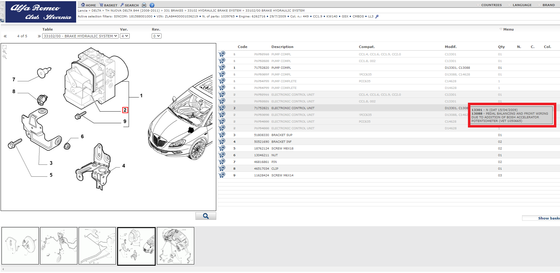

Ivan 26083 Posted January 25, 2022 Cimao me jedan od kolega sa starijom Deltom na PM, da mu proverim pre par dana... Takodje problem sa pumpom/elektronikom ESP. Pa cisto da dodam i ovde posto se prethodno pricalo, dobro se ipak izgleda secam. Modifikacija je uokvirena crvenim: 1 Branislav reacted to this Quote Share this post Link to post Share on other sites
Branislav 748 Posted January 26, 2022 (edited) A kakav je problem imao sa esp na delti? Edited January 26, 2022 by Branislav Quote Share this post Link to post Share on other sites

Ivan 26083 Posted January 26, 2022 (edited) A nemam ni zelju . 16 hours ago, Branislav said: A kakav je problem imao sa esp na delti? Centrala rikavela, na 1.9 TwinTurbo. Edited January 26, 2022 by Ivan 1 Mijailović P. reacted to this Quote Share this post Link to post Share on other sites
